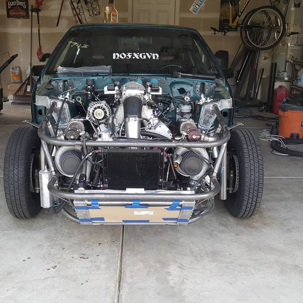

I would go with twin S366s. I had that setup on my 408 and I saw boost threshold at 2800 rpm. All in by 3600 revved it to 7200 and made 1215whp on 23psi.
