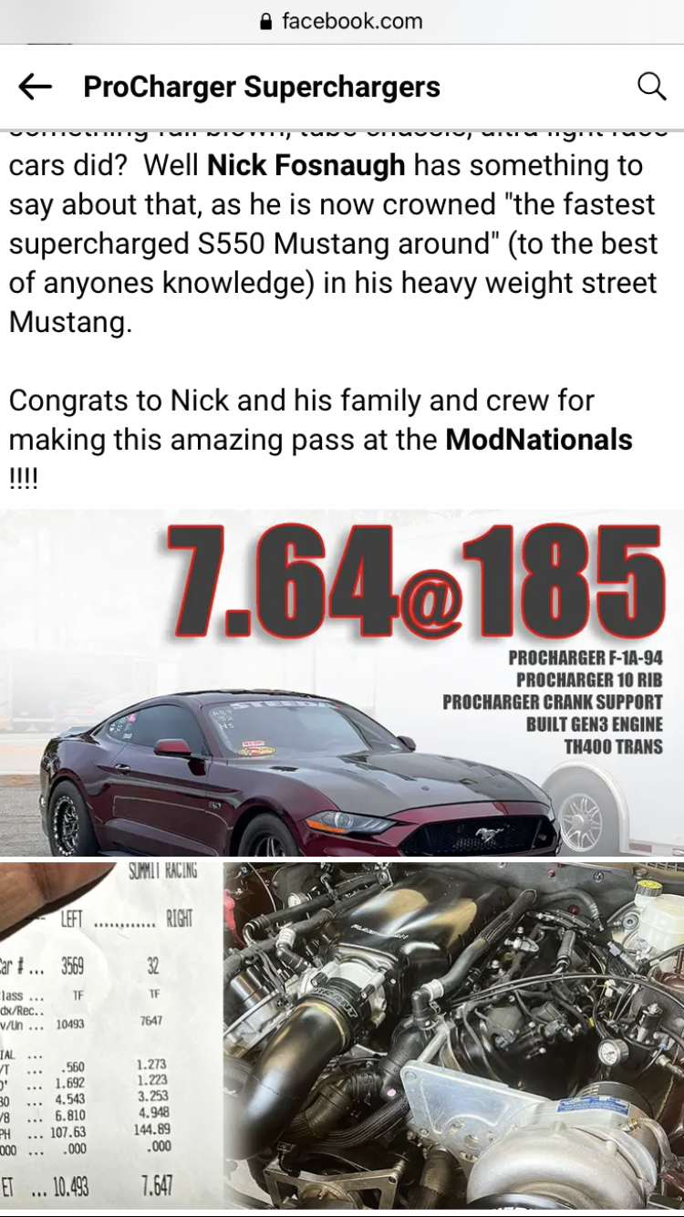

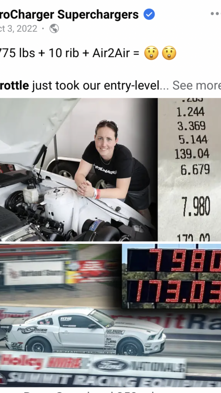

Tiny P1x smaller than a D1x running 7’s
F1a-94 street car trapping over 180 mph
D1x making over 1000 rwhp
Yes everyone knows turbos make more power, but Prochargers aren’t as incapable as what is being portrayed in this thread.

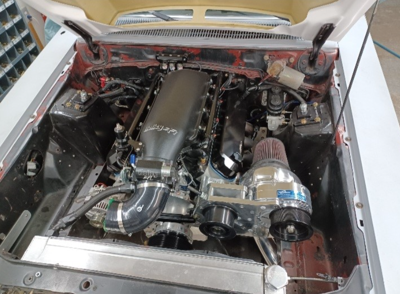

The F1A-94 12 rib is what we are working with. Its larger than I thought it would be. Don’t claim to be up to date on centri-blowers. There are T4 76mm turbos trapping similar… but a lot of that is in the engine/chassis. If not limited to a smaller unit, why not run a larger one is my question? It would be more efficient, no? (def. is with turbos anyway) You didn’t answer the question. I’ve seen posts where you are planning on a larger charger… So knowing what you do now, would you stick to your blower, or go with a larger one with the OP’s engine and goals? I didn’t see his weight mentioned, that’s a big factor too. I just can’t see going with a relatively small blower for the cost difference if you aren’t class limited in some way. Just as I don’t see the point going with a small turbo if you aren’t class limited. Seems like that’s leaving more power per pound on the table.
Sorry, I never meant to dodge your question. Fact is I'm avoiding going to a bigger head unit because I like the D1x so much for a street car. My goals have changed since I bought the procharger I think 4-5 years ago now. I was on sbe ls1 the first couple years then my goals changed and I decided to pull the healthy ls1 and sell it. I put that money towards my ls3 forged rods/pistons build. I was happy with that for 3 years and continue to be, but I like to race and have 4 other daily driver vehicles so I'm considering going more towards the race car weekend toy route with the GTO. Car was about 3700 lbs when I last ran it without me in it. Since then I have pulled the seats out and have 2 racing seats in it now as well as some other weight reduction and plan to put a cage in it so I can race again. I figure if I'm going to make it track legal I might as well make more power and switch from drag radials to stiff wall slicks since the IRS performs much better on no prep and bracket prep with bias plys then it does radials.
So if your goal is truly a street car that is 9 second capable then yes a D1x fits the bill very well and will probably make 15 psi peak without over spinning it on his combo. If he actually has long term goals of wanting more while keeping it a street car the F1a-94 is a very nice blower. Loss of a little low end isn't a bad thing when you have 377+ cubes high compression and make over 1000 rwhp on small tires with a street car. Most turbo guys use tuning to limit power down low anyway where with a procharger it's just a little timing adjustment as the power is linear anyway. Installs in a day if you buy a kit made for your car and racing is expensive I've seen plenty of turbo builds with way more money in them then I have in my car, but hey I'm all in favor of capitalism and respect all combos. I actually prefer big cubic inch high compression nitrous combos for the sound, but it's just hard to compete with those combo's now unless you are super light. They also still have more wear and tear to deal with.
