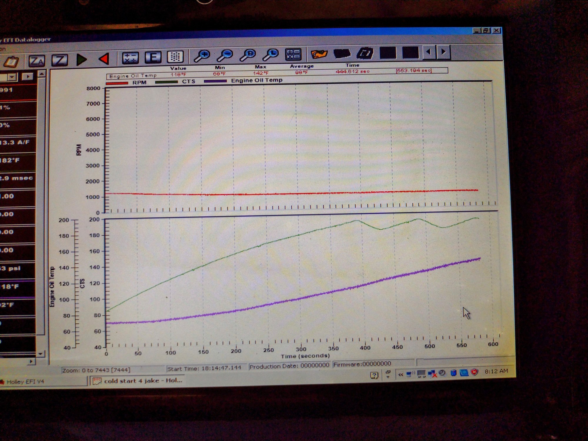

the water cooler is the best option if the room regardless because it is an exchanger……. It brings the oil temp up much quicker than it would normally vs no cooler period …. That is the biggest benefit of them, not the cooling
This is mine with the thermostat and you can still see how much slower oil warm up is vs coolant, with the water heat exchanger they would almost pair

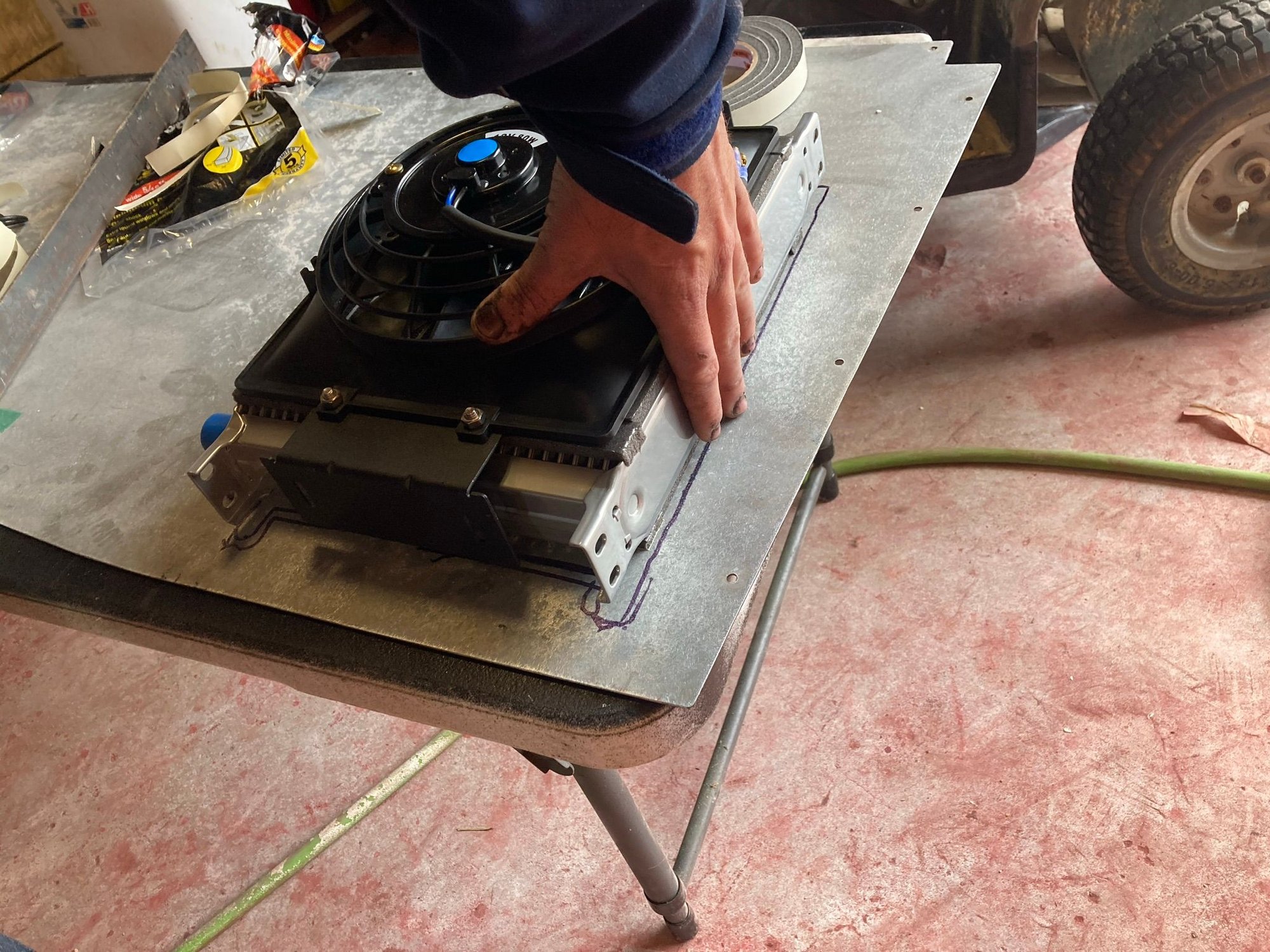

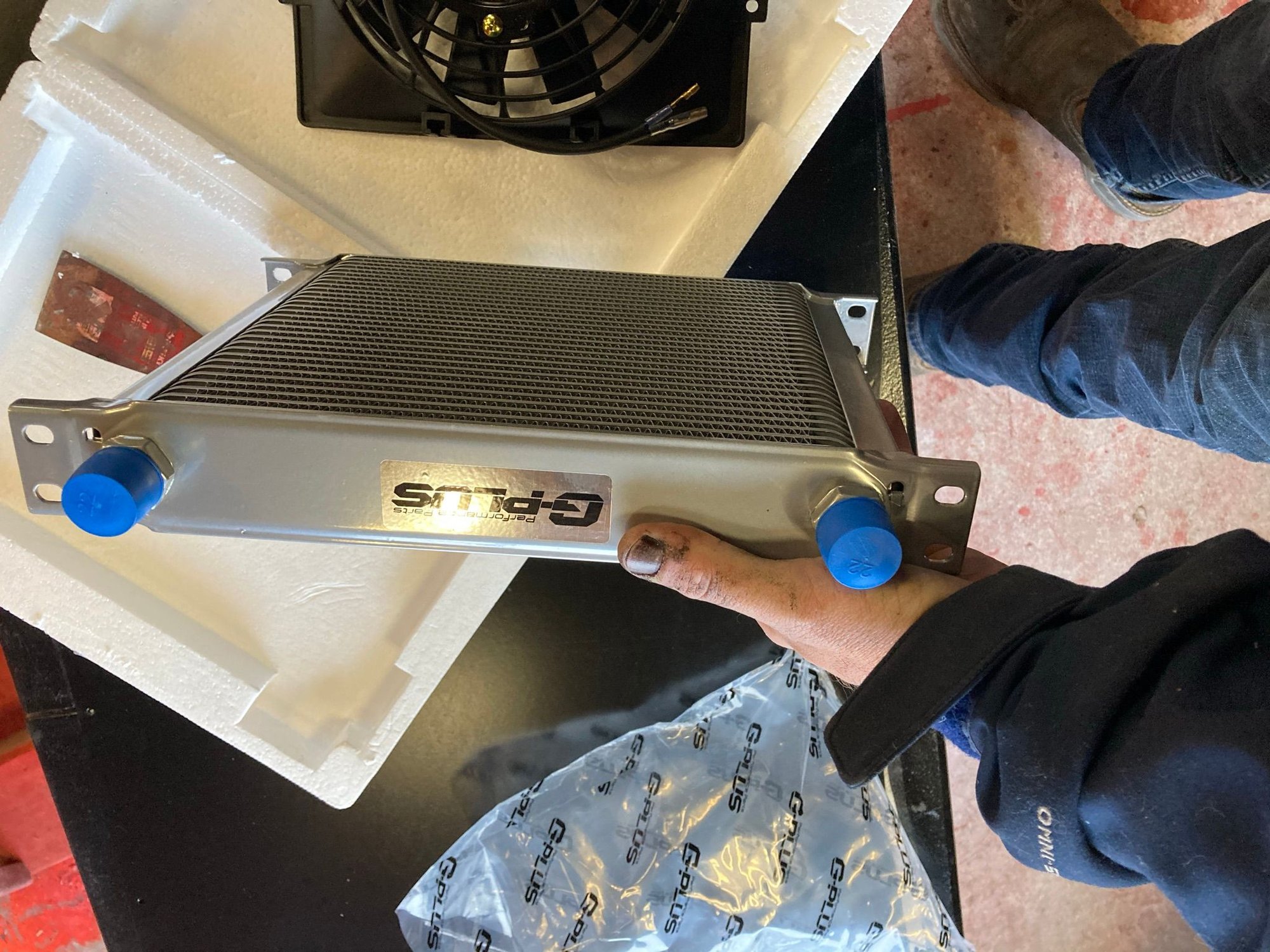

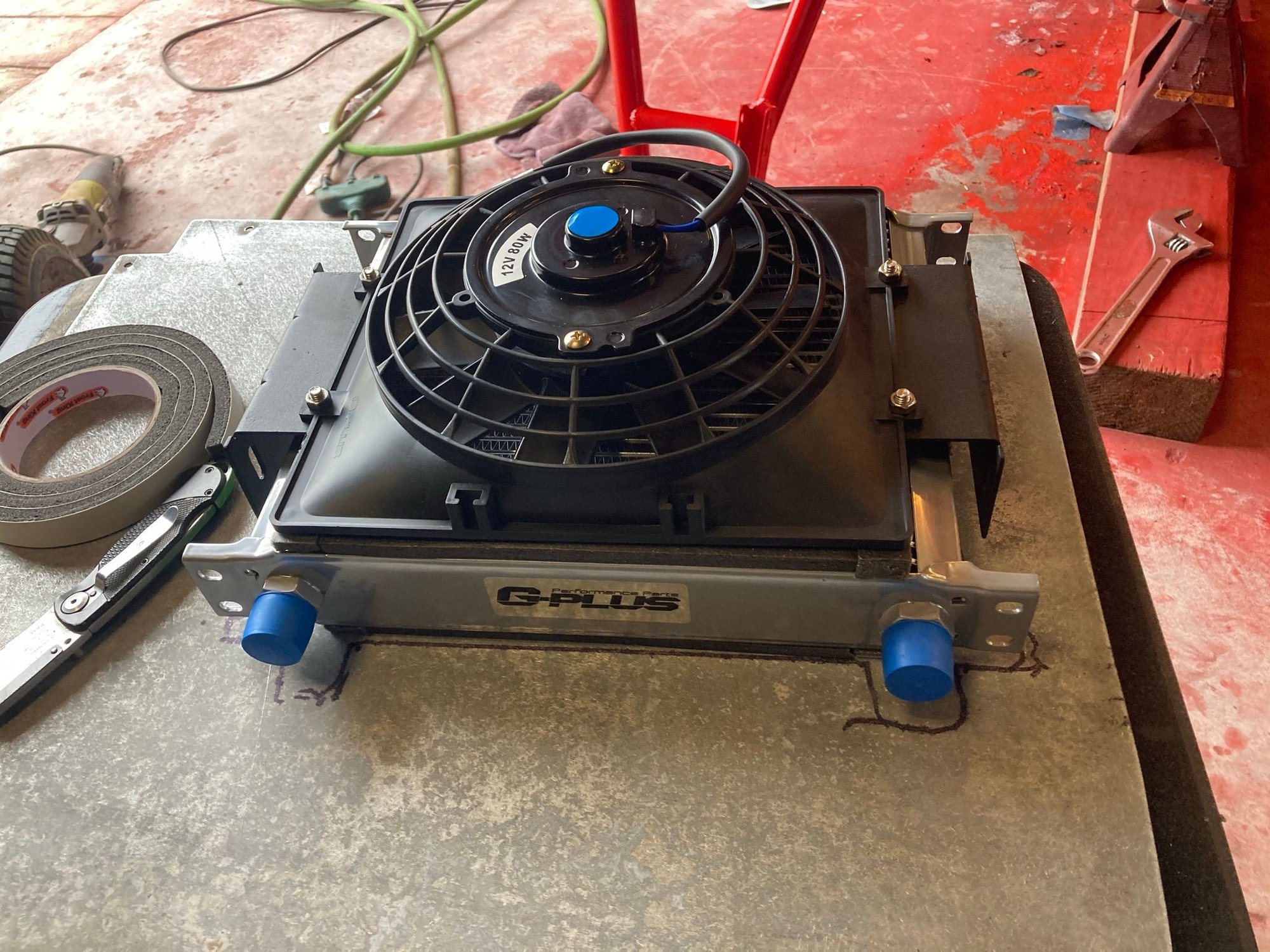

I got this cooler off eBay it’s 10an I’m using it on a hayabusa powered buggy and it has done an amazing job of keeping the oil temps down compared to the factory cooler. Build quality was really impressive for a cooler on eBay.
I have a gplus 30 row cooler from ebay, I am so far quite impressed with the build quality with it(it is also 10an), but I am pretty far away from using it so far.
