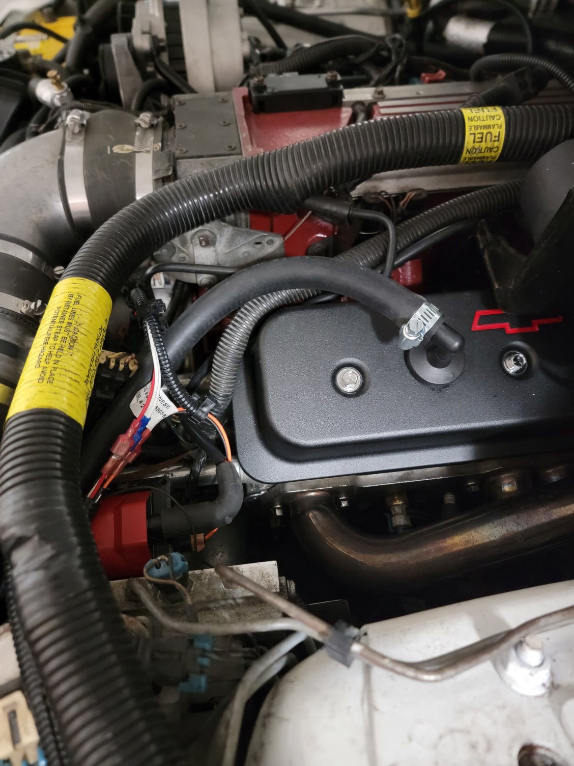

The way I routed the vented PCV is as follows:
PCV to catch can inlet (3/8" hose).
Catch can outlet to Passenger valve cover (1/2" hose).
My Vacuum is a steady 11in hg.

I ended up routing the driver valve cover to thr catch can using this 90 degree port for a jeep that had a .93" that fit the proform 1" grommet a little tight, but it works. I capped off the PCV valve. There is no longer oil leaking so my guess is that the way to route a catch can on a boosted LT1 is to run both valve covers to the catch and cap off all PCV ports on intake.

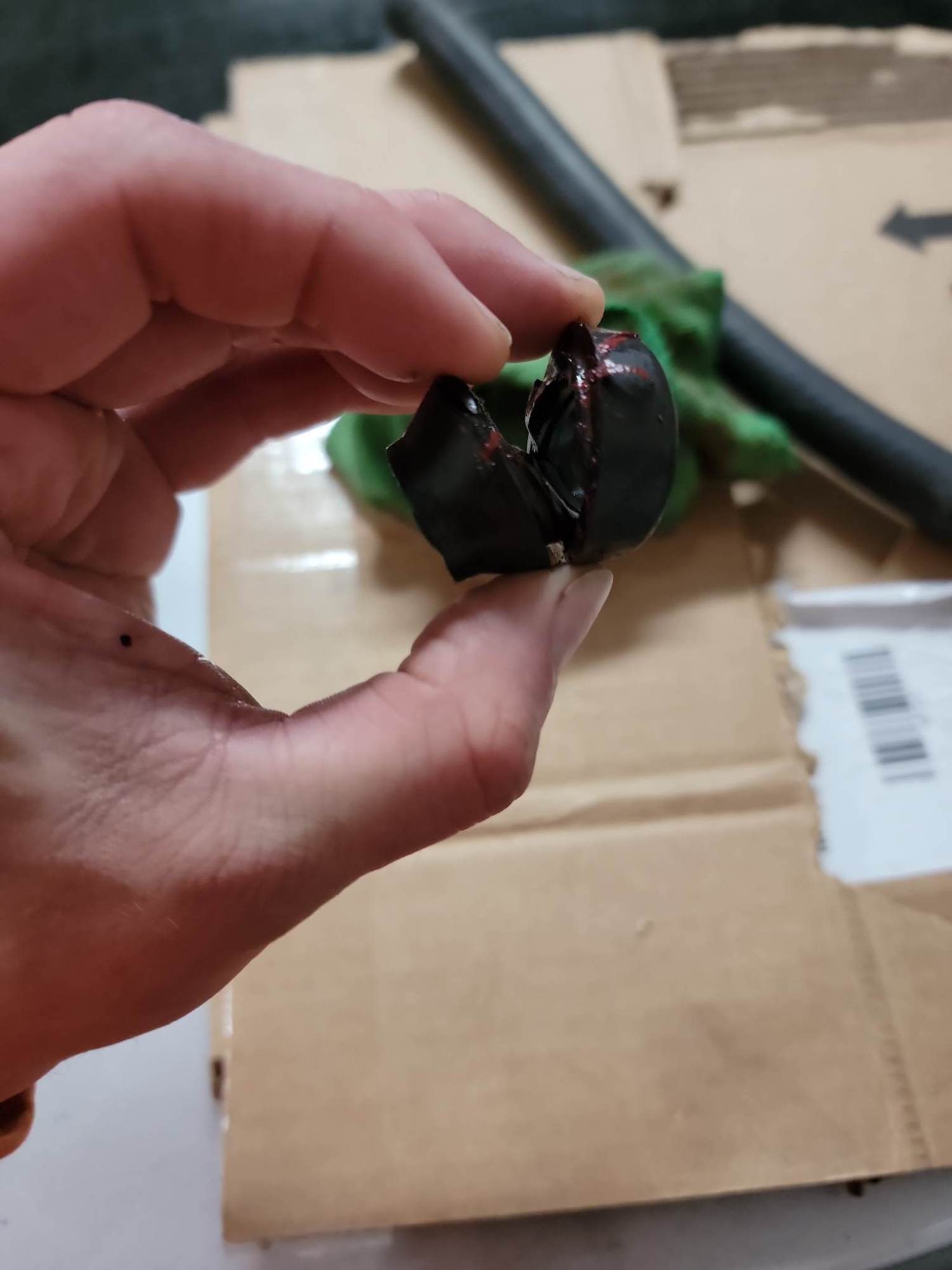

Just to update the thread. Saw some smoke coming from pcv valve grommet. Pulled it out and it was nearly ripped in 2. Replaced it and this helped with a lot of the issues. Still wouldn't boost though, so i added more tension to the pulley. Boom, hitting 13 psi all day and and hauling. Still wants to stumble to accelerate after coming to a stop, but once the choppy rpm climb clears up, it's back to normal. For good measure, im going to install a mighty mouse catch and see if being able to run pcv improves the condition.
This car hauls *** now.
