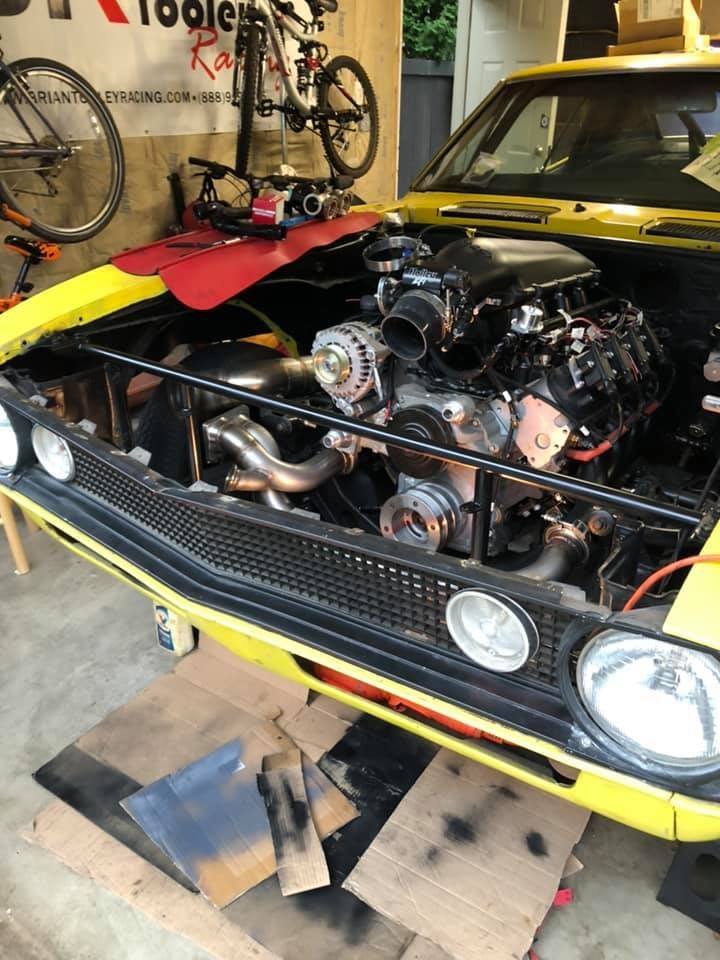

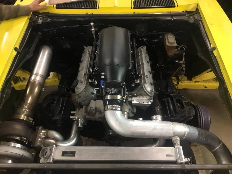

My turbo system is pretty simple, truck manifolds and a Shearer a/a intercooler.

driver's side is modded
are you asking for a 4th gen?
Any pictures of the driverside? Mine is going into a c10
Biggest issue is the power steering pump.
Old Mar 7, 2023 | 11:21 PM

how about this? I could snap you some pics this week if you want
do the truck manifolds fit with the stock steering ?

For mine they do. My (manual steering) gearbox has room to the driver's side exhaust manifold, I could take a pic if you want.
