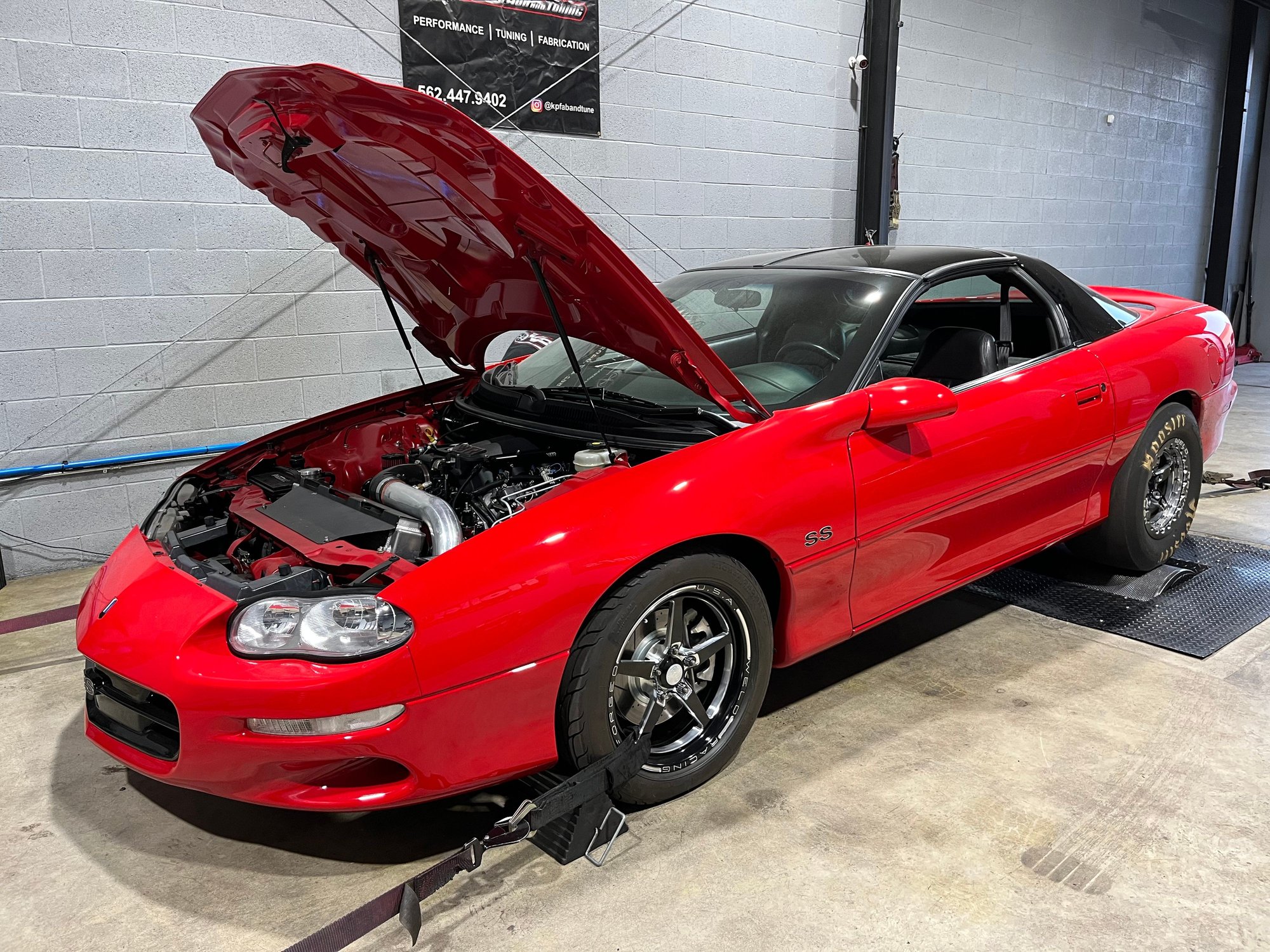

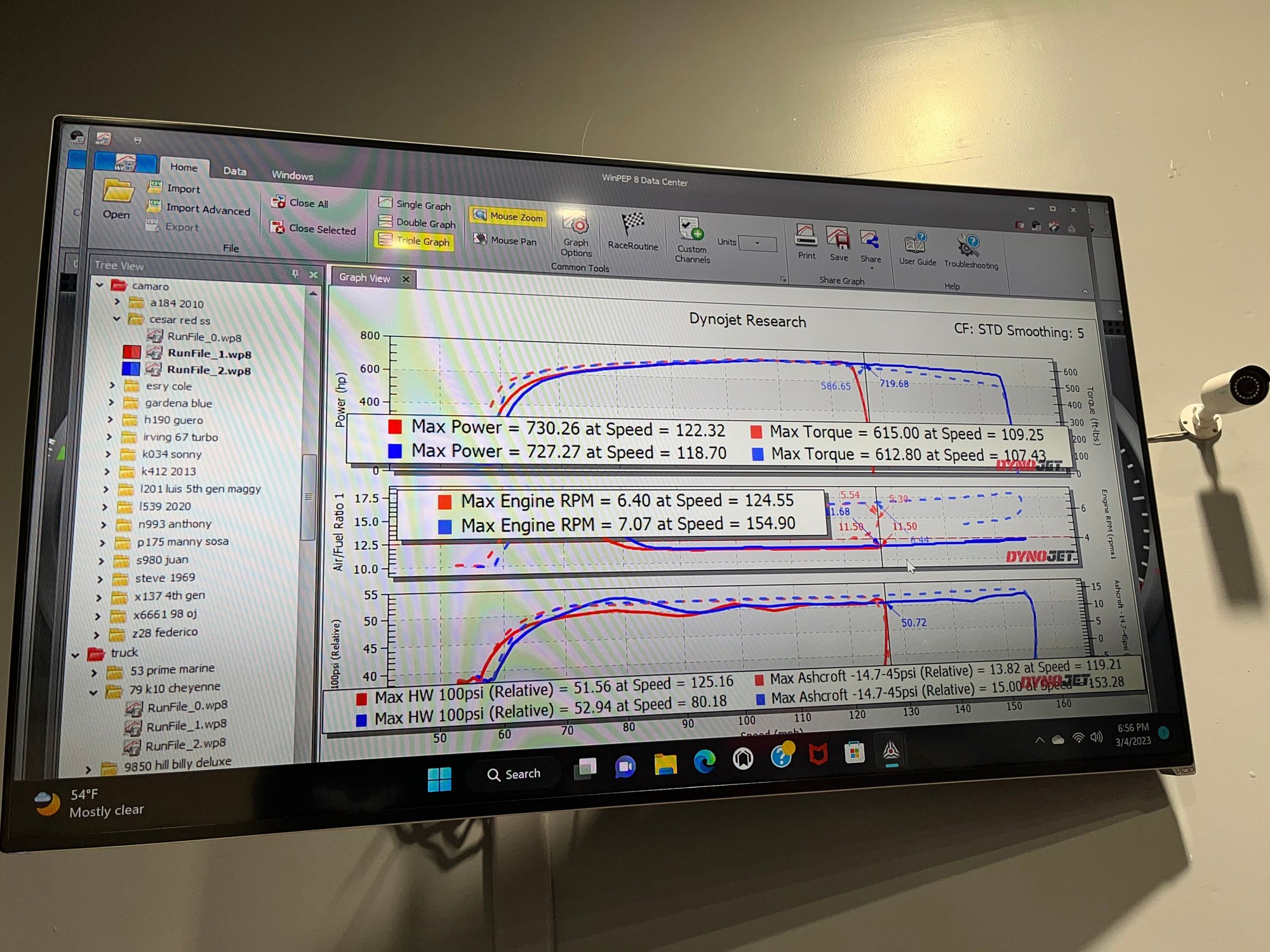

Should be able to get there with that set up. My car just made 730whp with a d1sc on 13-15lbs. I’m on e85 with a Darton sleeved 430” but with small mildly ported 243 heads. This was through a th400 and a very loose converter and 12 bolt rear on slicks.
