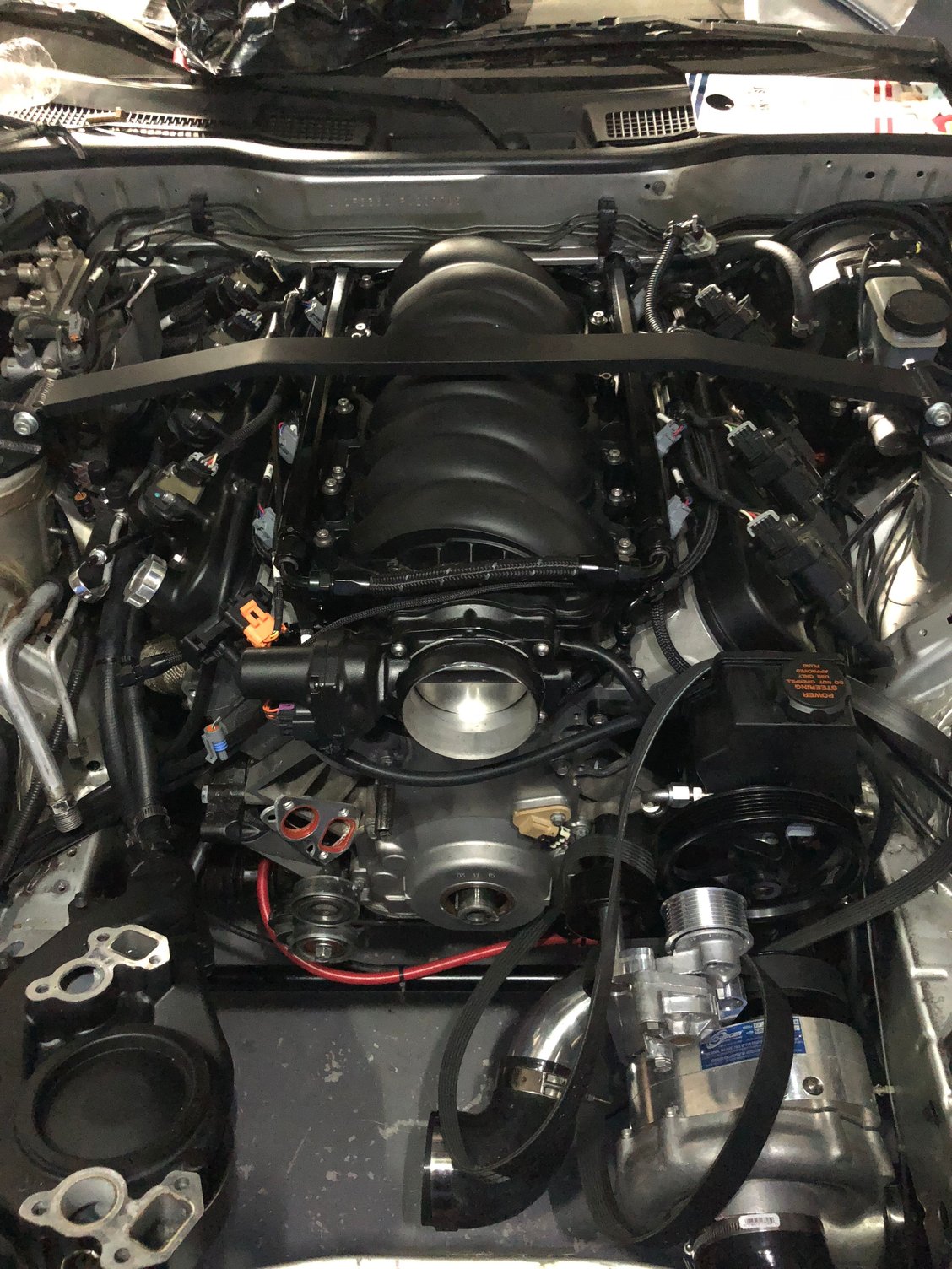

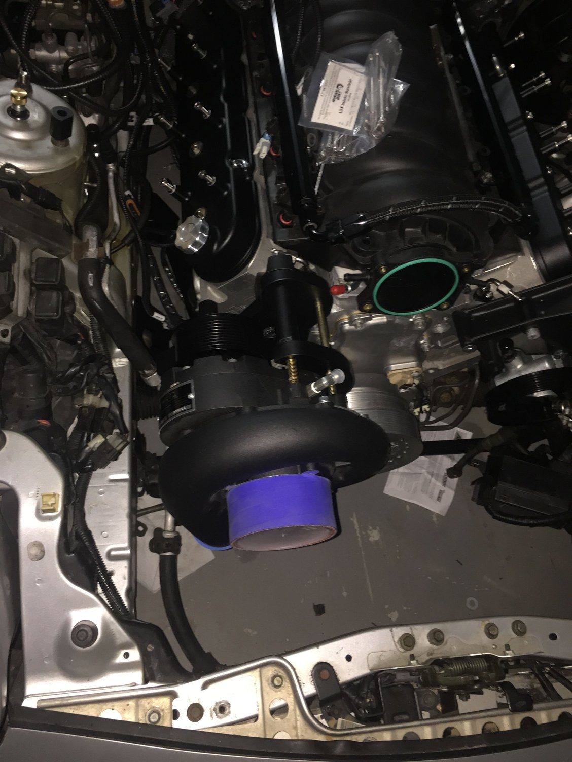

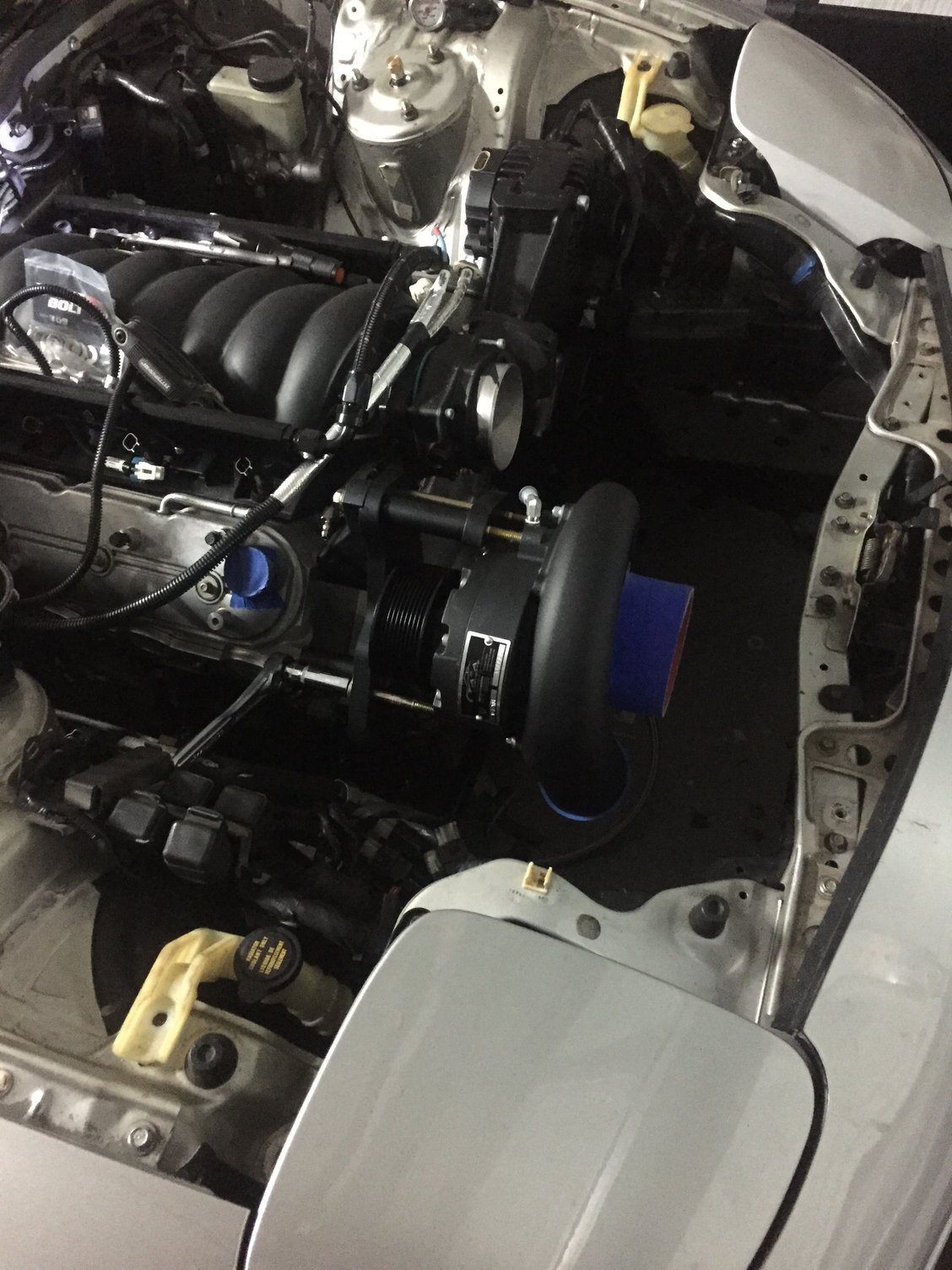

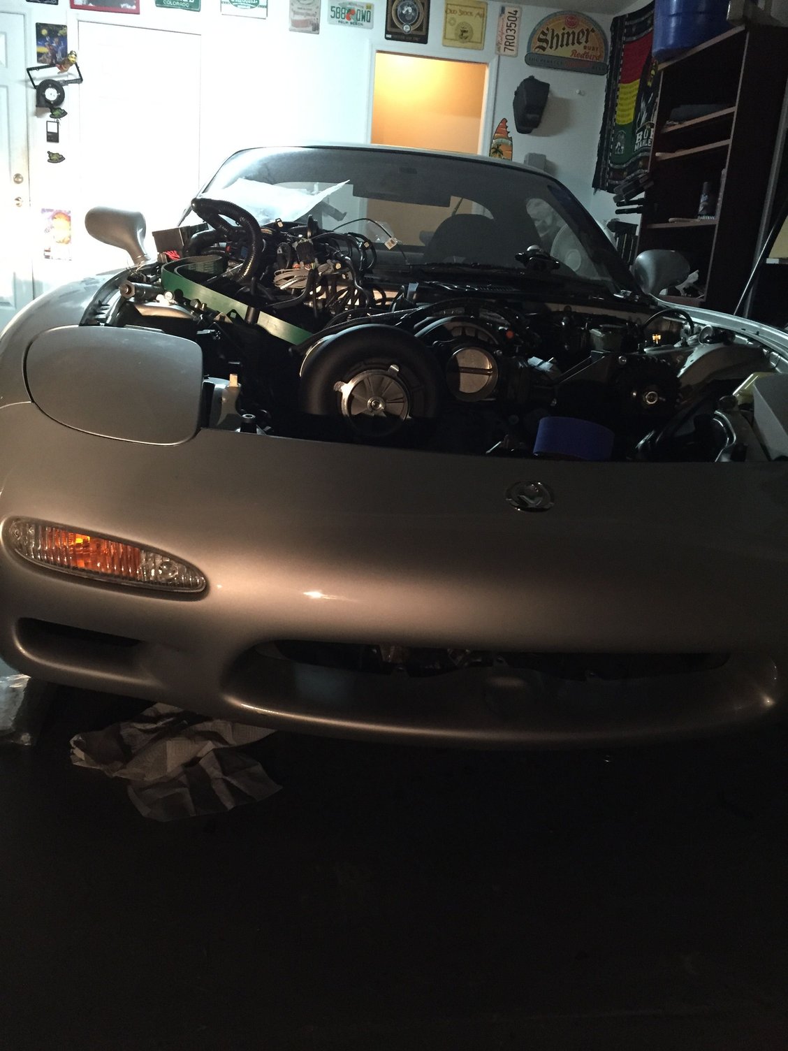

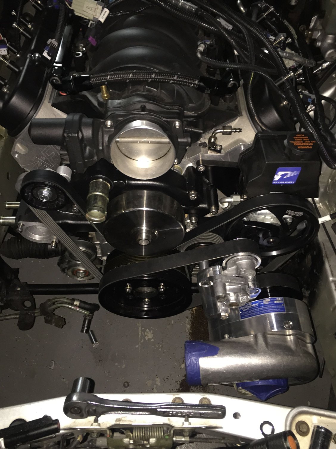

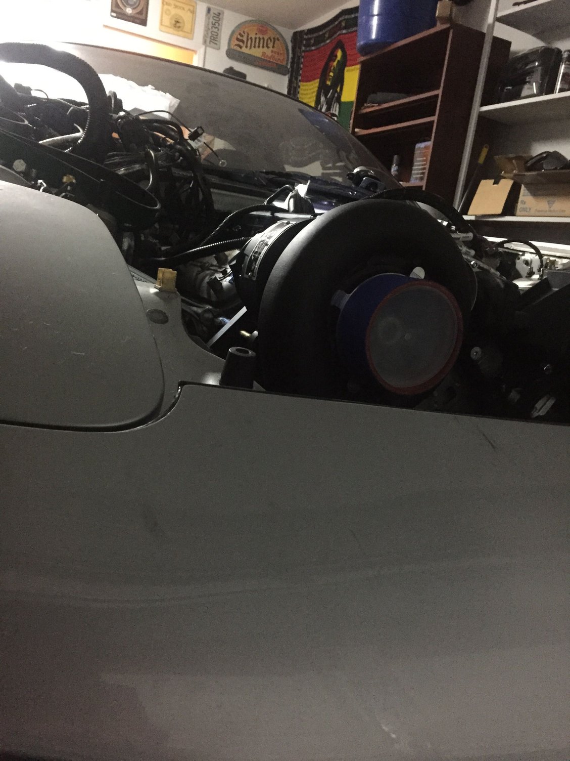

Gonna be hard to find any info on stuff like this. Ive got a 93 rx7 with an f body procharger setup which mounts it on the lower drivers side in front of the fbody alternator which was the only setup I could run due to the sloping hood. I bought the a&a corvette bracket with ysi and it was gonna stick straight out of the hood so i sold it and got this one. Im pretty sure mustangs have more room under the hood than mine so youll have to see where you have the room. I had to tilt my radiator to get the room i needed for the air filter etc.
if you want to save some money piece it together and buy just the bracket and the head unit because everything else will be custom fabricated.
