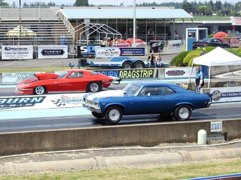

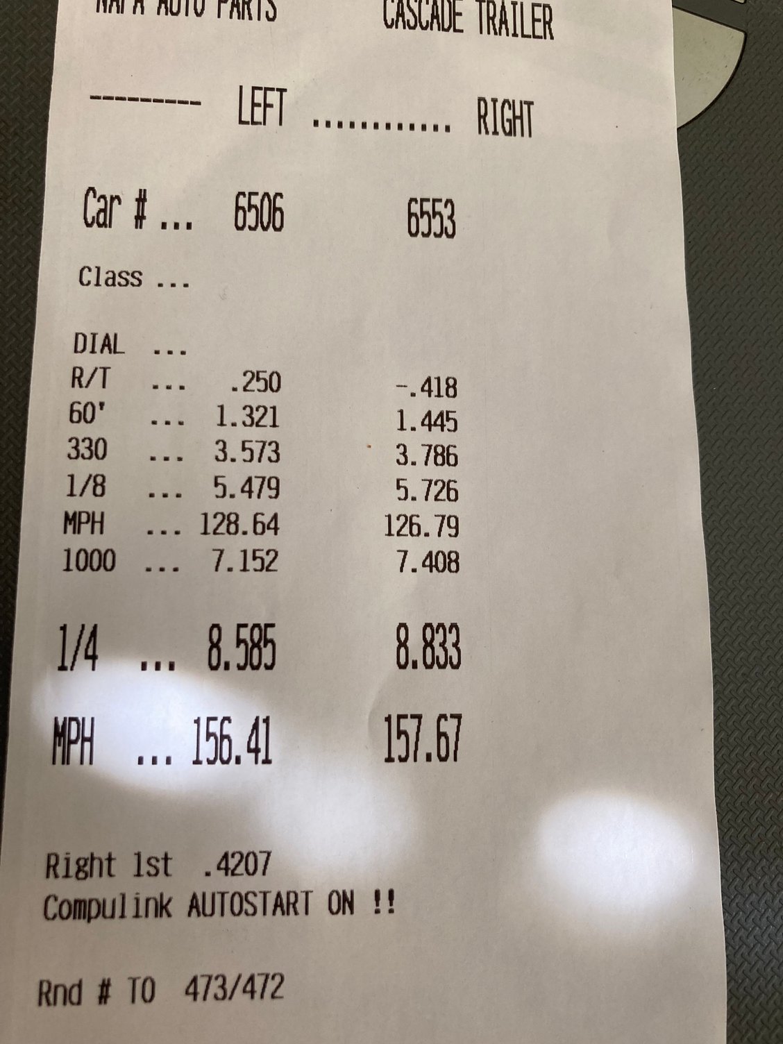

Woodburn Dragstrip yesterday. Me in the right lane. My buddy who I tune in the left. Big tire 6.0 twin turbo 64 chev PU. I left on the second yellow intentionally. Chase is a race right?
Due to the nation wide shortage of VHT, the track wasn’t very good. Sad.

Thanks man. The 60ft times have fallen apart because I tried limiting the front-end travel in an attempt to keep it off the bumper when the track has a lot of glue. I need to go back to where it was, and fine tune from there. Mid 1.4 60's are not good, it should be in the low 1.30's or even high 1.20's.

What did you use to limit the travel? 128mph in the 1/8 with a 3450lb car though is impressive.
Did you let out early, seems he pulled 3mph more on the back half?
