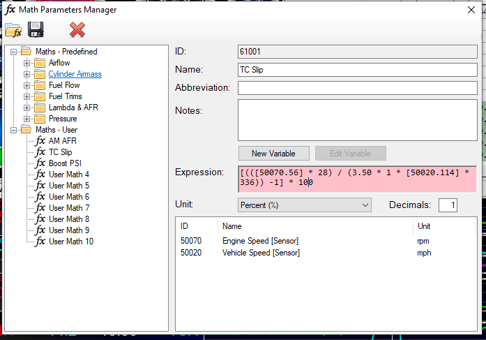

I wrote converter slip math in HPT based on mph and rpm.

@RonSSNova I used the equation from the TCI Converter Slip calculator to create a channel on HP Tuners.
Since I was already monitoring MPH and RPM, should this work when I plug it in or do I have to do a new data log?
Or did I screw this up since it doesn't work lol?
There is a space between * and 336 as well.
