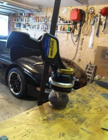

Might try this little “hack” when installing springs as well. Makes it VERY easy.
That is brilliant, always made me nervous kneeling on them and trying to get the screws started before time ran out lol.

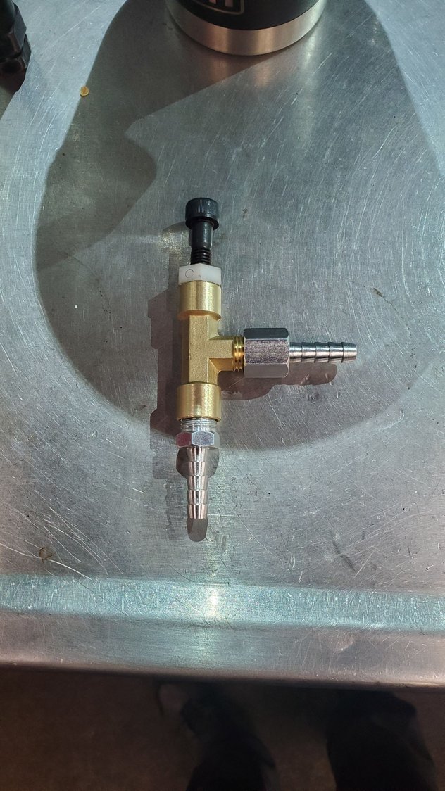

I agree, I got on it a little bit with a fat tune and it pulled good at 10lbs, I can see how its addicting. I ordered the Boost Tee also from turbo smart, going to leave the 7 psi spring in it and use that to increase it in the car. I may have to take it out though to keep me from turning it up to 14 or so lol.

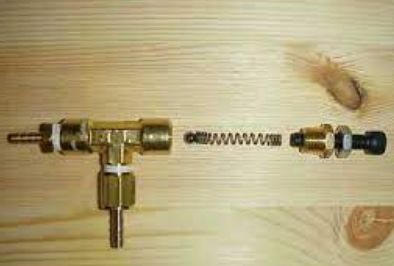

FWIW you can make your Manual Boost controller Bring on boost just as quickly as an EBC with a few cheap parts from the local hardware store. The MBC “T” you bought may already have this. But you can build one pretty darn cheap as well.
Basically need a ball and spring to act as a check valve. That holds the air signal back until your target boost is reached. Basically slamming the gate open. Without It, the gate creeps open before the target boost is reached giving you sluggish response.

I also made a boost controller
