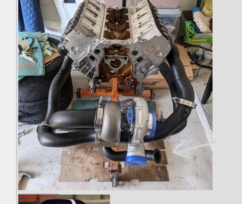

Definitely bench test the gate , whatever pressure is required to just make it float ( easily moved with fingers) is what it should deliver. Variables are back pressure ( will,open early) , and placement for priority flow -- will have higher boost with poor placement. Plenty of guys using 44mm gates with 7875 s , IIRC REL3RD has a Huron kit and had to add a gate , moved 1 and added a second both in good priority locations ( outside of a bend ) got any pics of the gate location?

IT
IT IS ON THE END OF THE CROSS OVER PIPLE THERE. THATS THE PLACEMENT ON THE NEW V3 KIT

The key area is where the waste gate pipe joins the main " up " pipes just bellow the t4 flange , doesn't look too bad in that picture. Don't worry about that until you confirm waste gate operation. If you can make up a regulator set up it shouldn't be to hard to borrow some compressed air

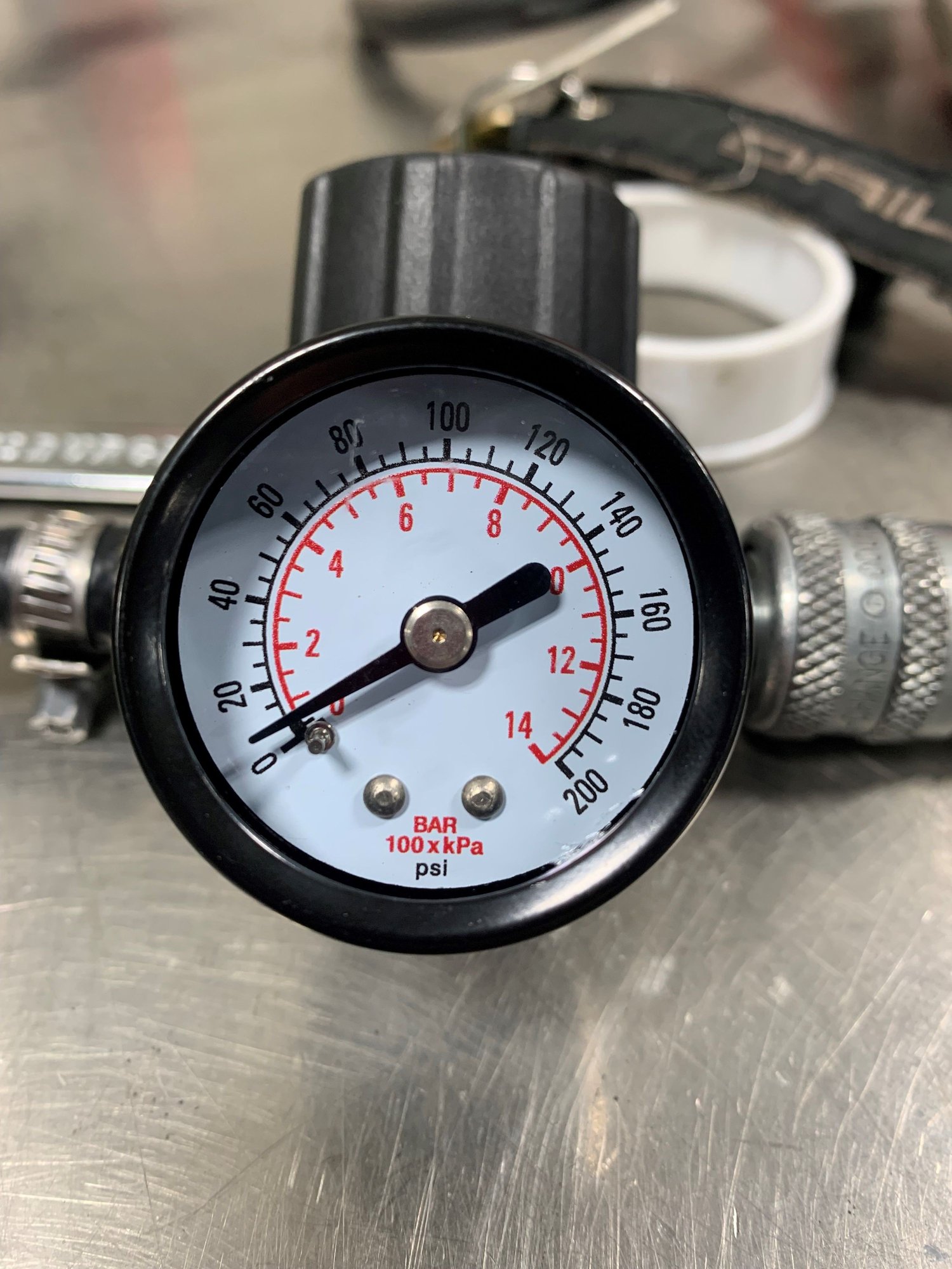

I bought a regulator at harbor freight with a gauge and hose ends. I’m going to take it or work compresses air on one side and other hose to the reference line on gate. Start turning **** til I can easily move it. I believe this is the correct way.

Just brought the car home. I will let you know what it reads on the gauge. I say its on the psi when I can easily move it with my fingers in on the gate, correct?

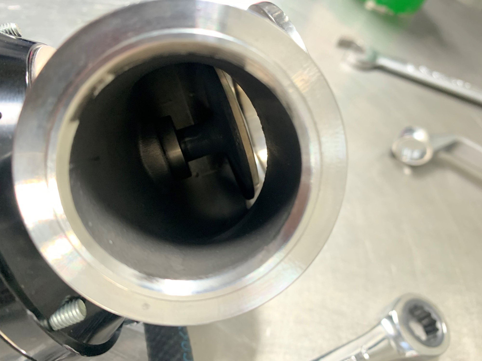

It never really cracked open. Maybe I couldn't get it down that low our psi in the shop this morning was 120 on the air hose. I got it down to about 7 or so and it opened the gate. Is this fully opened? It will not open more than this even if i turned it up to around 15 lbs. I did try to push it in more as soon as it started moving and it seems there is still about a inch of shaft that doesn't go in.

Its the lightest one I had. It only came with two springs a 7 and a 14 I believe. I it has a seven in it. I had it all way up to 15-20 psi into it and it didn't open any more than this. We did take it apart and put this lighter spring in it, maybe it's pinched or something. Should it be all the way open?
Old Jul 17, 2023 | 06:48 AM
ddnspider's Avatar
Posts: 14,628
Likes: 1,778
From: FL
Yeah somethings not right in there. Maybe a messed up diaphragm or a messed up spring or vent valve but that's not fully open.
Old Jul 17, 2023 | 07:10 AM
GMCGreg's Avatar
Joined: Feb 2020
Posts: 749
Likes: 210
Better get it apart and check that diaphragm, while it's apart check that the "stem" is not binding in "guide" smooth and polish as required. I use the same sort of regulator but tee in a low pressure (0-50 psi I think ) to the gate to improve accuracy

I will take it apart and check it out. This is a cheap Chinese gate. If the gate is bad, I will just order a better one like Turbo Smart or Tial even though the VS has good reviews and is half as much.
