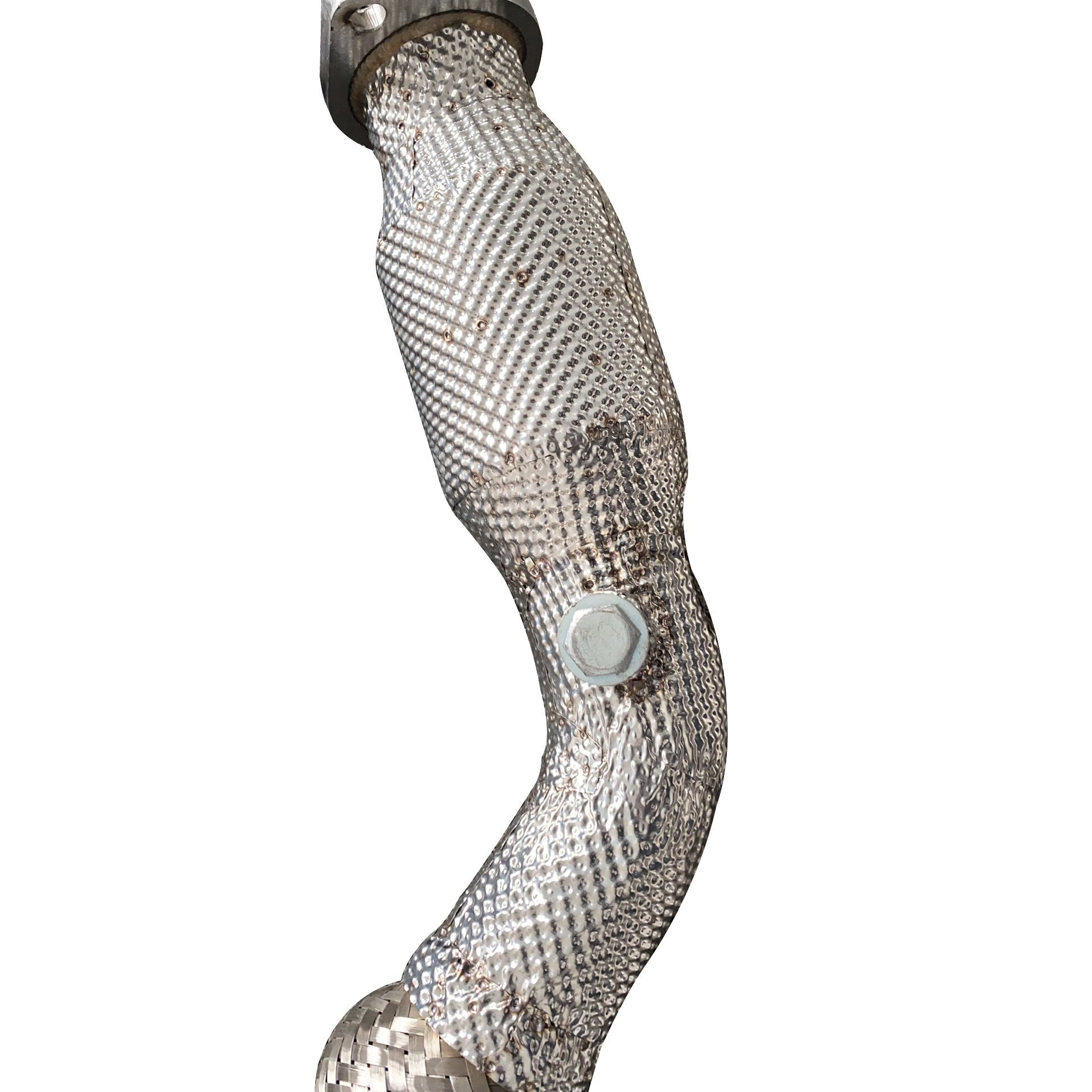

Can you tell me where you sourced the material from? I've seen stainless embossed material. Interested in running this in a few spots on my hotside. Did you space it from the piping or apply it directly?
Old Aug 6, 2023 | 04:00 PM
gjohnsonws6's Avatar
iTrader: (12)
Joined: Aug 2009
Posts: 1,149
Likes: 168
From: Litchfield Park AZ
For complete coverage the part gets sent in. There is also another company selling a similar product but is definitely not the same.

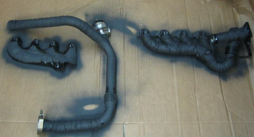

A trick I found was to coat and seal it after it's installed. I use SS safety wire to secure it tightly. Works much better than the SS zip ties. Coat the exhaust well with BBQ grill paint. Then wrap and heavily coat the wrap with BBQ grill paint. This stops the shedding of the fiberglass and locks out oil and water. I've had cheap glass wrap last years and years this way.
It doesn't peel or flake off. I even spray my exhaust housing and manifolds directly with the stuff.
Old Aug 12, 2023 | 10:04 AM
BigBoyWS6's Avatar
Joined: Apr 2023
Posts: 533
Likes: 85
I saw a guys GTO at my builders shop last week who also said over the years he only uses BBQ grill paint. He said he puts 3-4 coats on his hot piping. Sometimes he also wraps but not always. It looked good too, like a nice paint job. I'm definitely doing exactly what Forcefed86 described.
