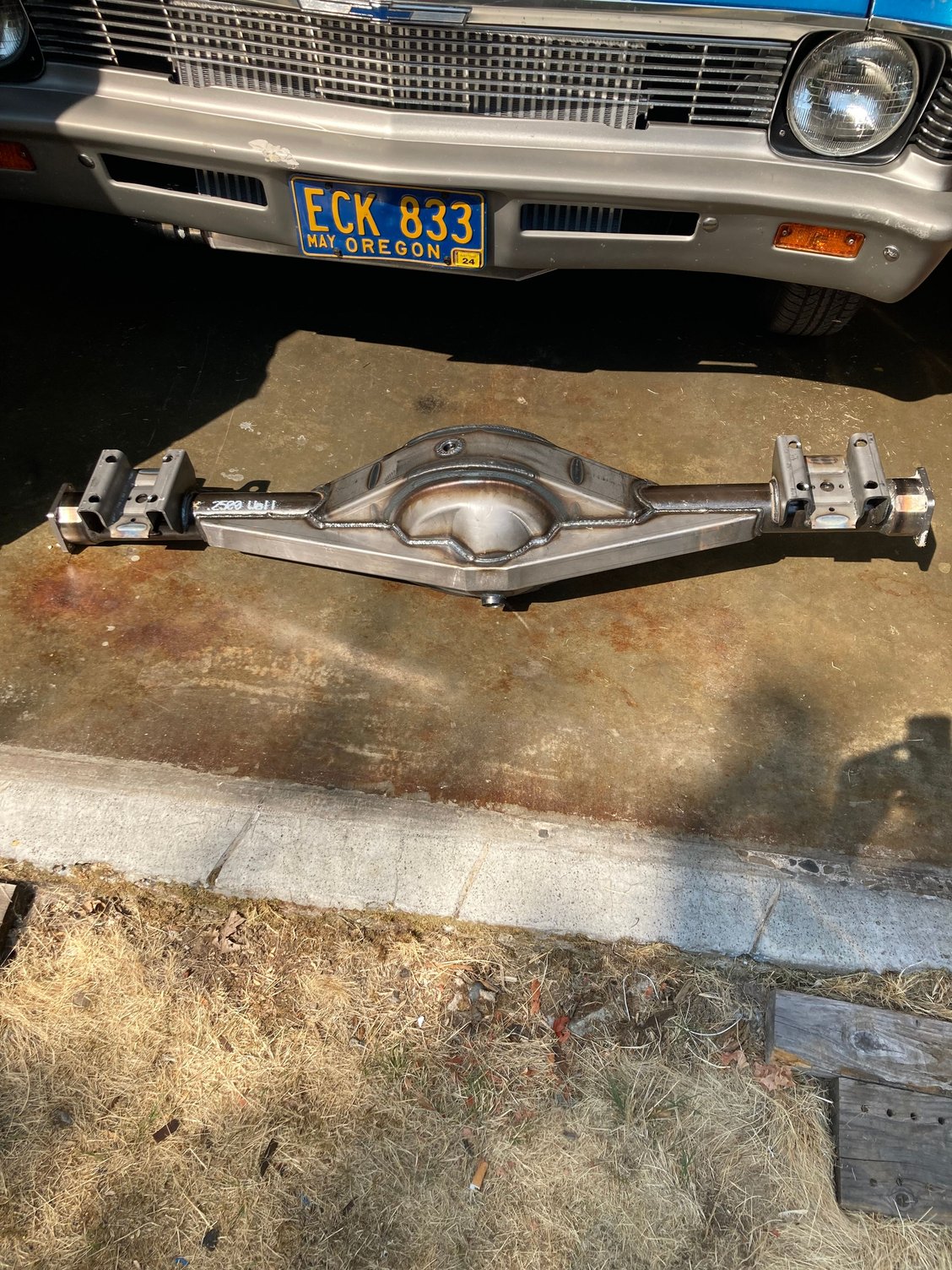

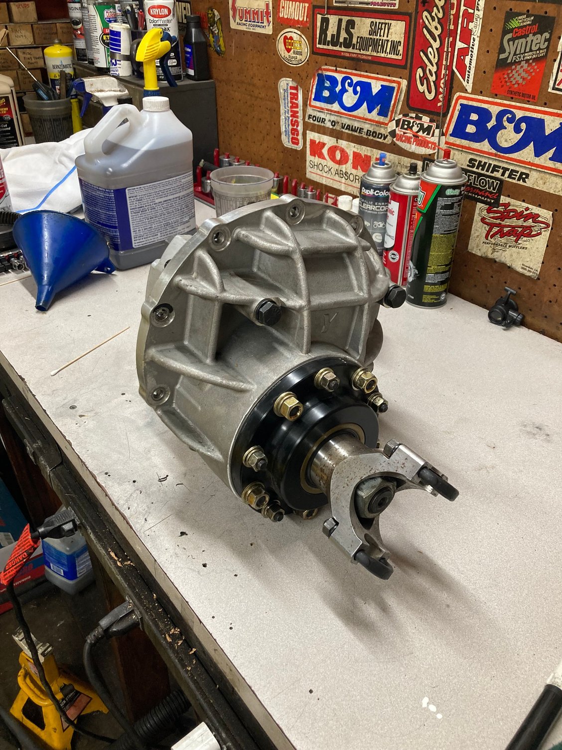

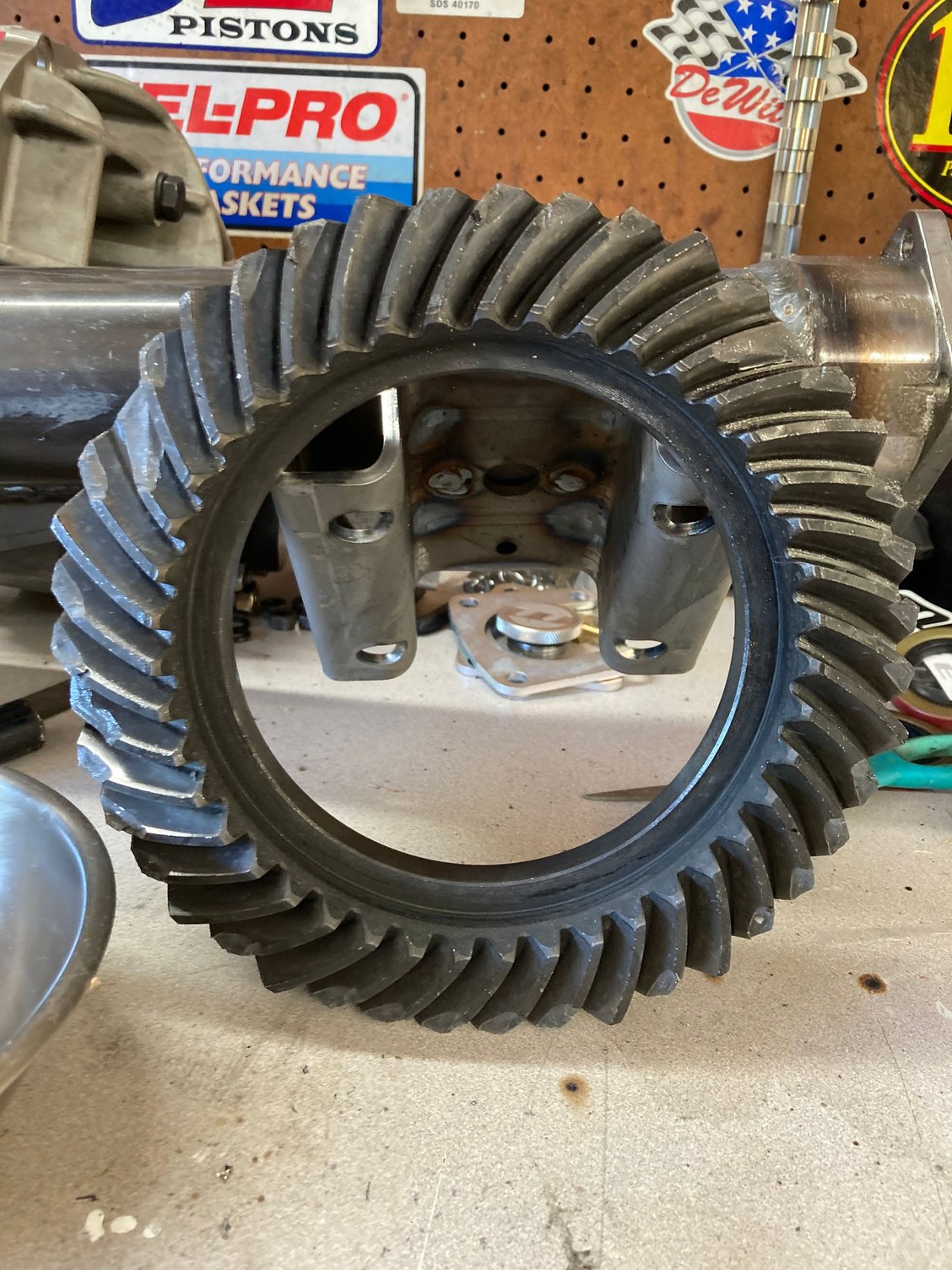

Yep. This was a factory GM 3.31 gear set. The fifth set of gears in this housing. First one to lose teef. All the aftermarket gear sets start out quiet, and begin howling after about ten passes and steadily get worse over time until you can’t stand to drive on the freeway.
So now I have this:
Moser bolt in housing, 1” narrower. 3.50 Pro Gears in the Yukon turd member.
Hopefully someone can use the 12 bolt. It just needs gears and bearings. Will survive under a bit less power.

12 bolts have limits for sure.
I believe the C10 truck 12 bolt is totally different than the car diff. So can’t comment on that.
Before I found the GM 3.31’s, I had US Gear 3.42’s. They howled so bad after a few years I guarantee people around me on the freeway could hear it.
This center section was in my buddies 8 sec Malibu wagon. It was quiet so I hope it still is.
My Calvert split mono rear sections will be here today. So I may have it mostly together tomorrow. Pretty sure I’ll need a longer driveshaft.
