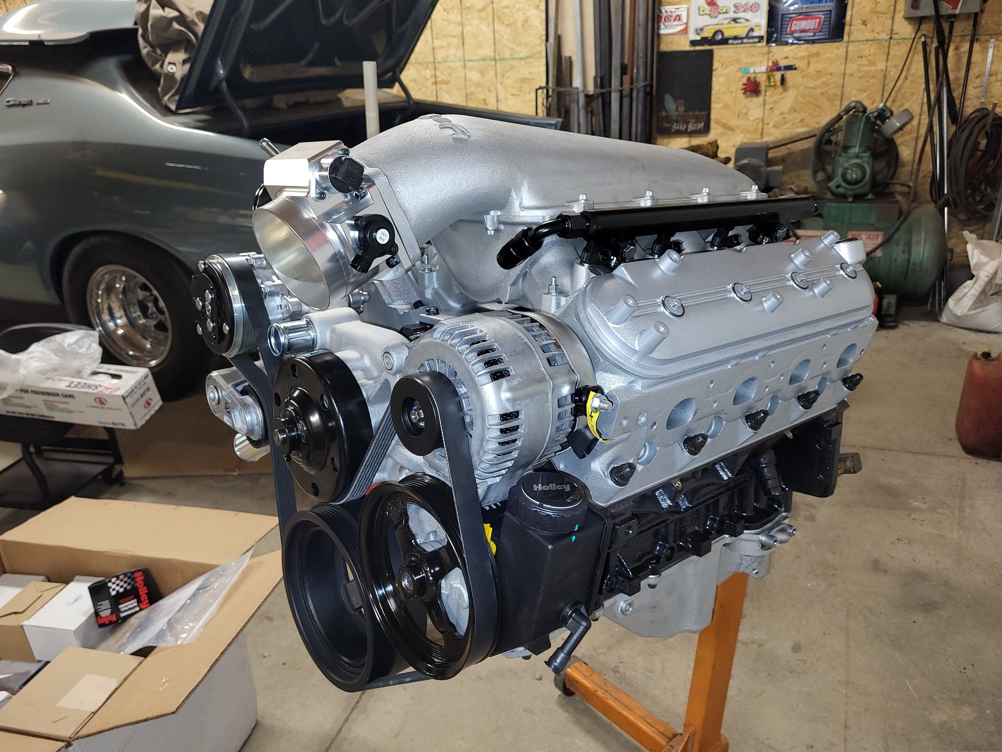

Curious, who's front drive setup is on your engine, I like it.

It looks like Holley’s setup. It mounts everything to the water pump. The WP uses a a LT1 (Gen V) waterpump cartridge. A new one will be any parts store OR local Dealer
Holley has a slew of FEADs on the website.

The front drive is a kit from Holley called a mid mount. This is all going into an 87 Grand National and cutting the frame for ac compressor clearance was not an option. The idea of using 25 year old power steering pump, compressor did not appeal to me either. So a pile of $$ came out and made this happen.
