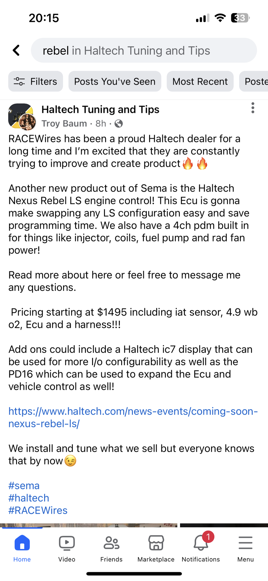

1500$

Is that your guess or did haltech share more info?
Looks like one of their authorized dealers couldn't keep a secret
USD Btw, don't want any Aussies to get confused
