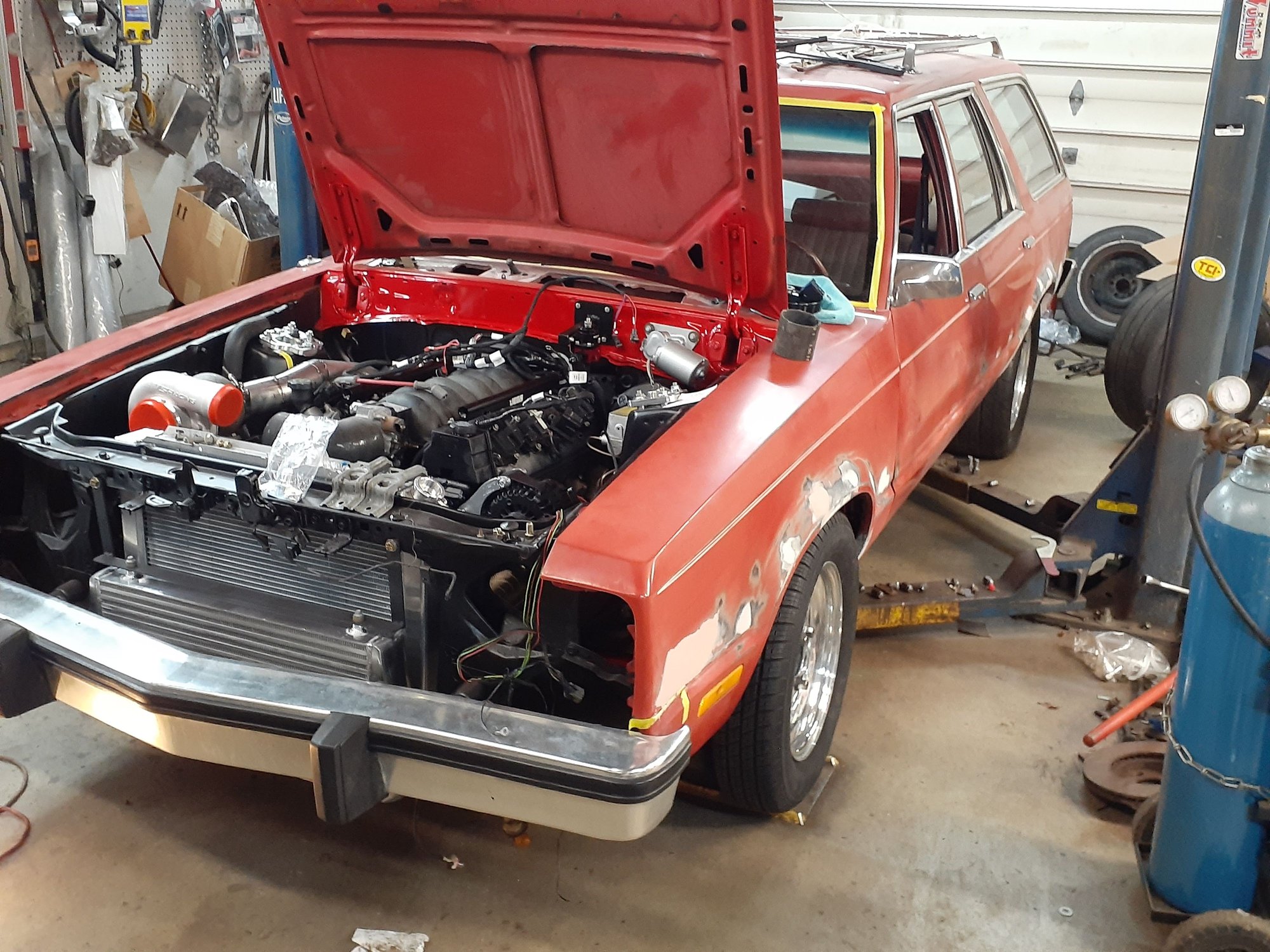

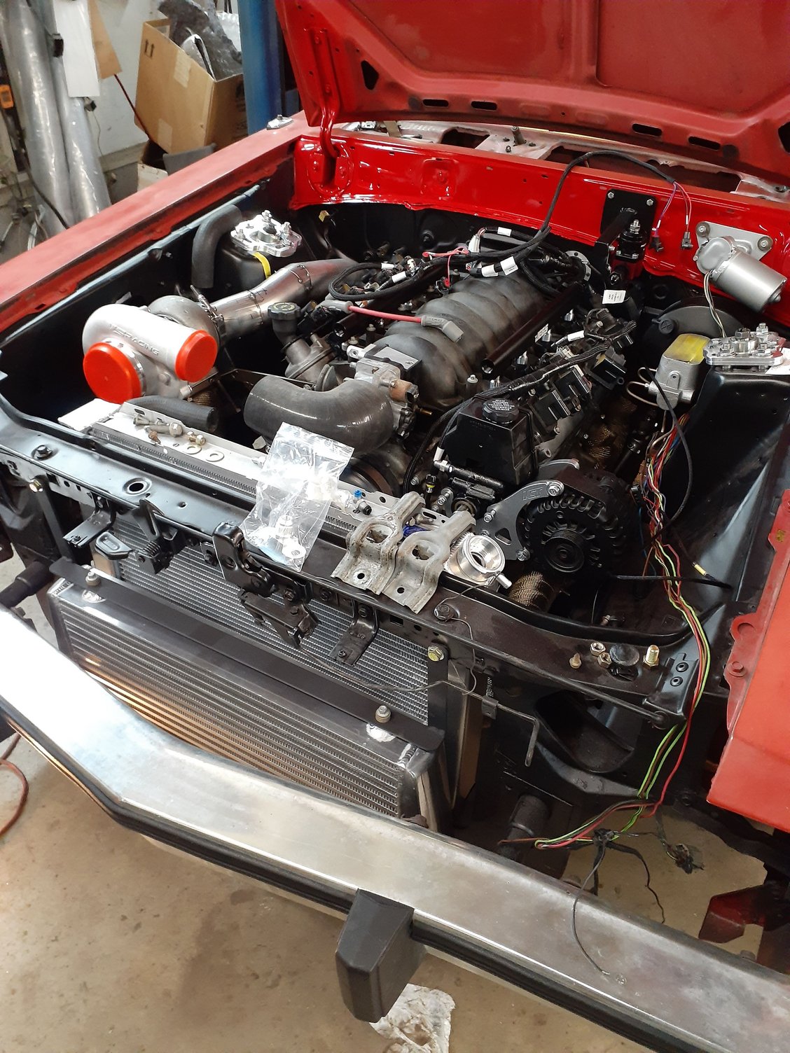

Started a new project, 78 Freemont wagon-why, I like wagons, and it was cheap, and uses Foxbody stuff (actually Foxbodys use Fairmont stuff, they came first, lol). Body was in good shape, had to make a couple panels, interior is great.

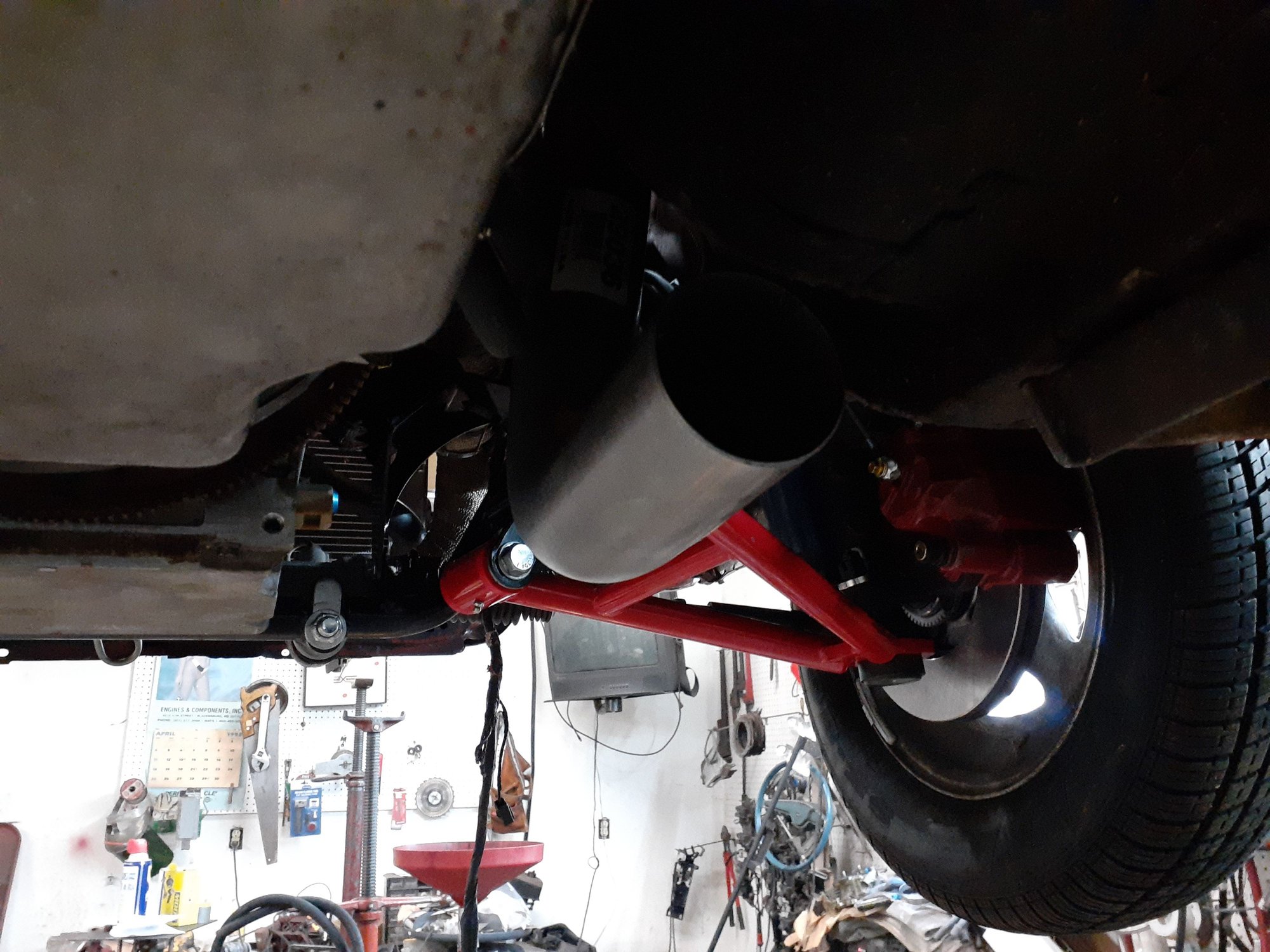

First thing I did was sell off the drive train, reason it became free, and installed a QA1 K member with LS mounts. Installed a bare block and 80E trans to make up trans mounts. Actually made dual trans mounting, 400/4L80E, since I had a known good 400. I picked up a 95GT front brakes and 8.8 rear for $300. That became a learning experience, after buying aftermarket lower control arms, found out I needed longer ones to bring camber into alignment, so had to reorder, so that took care of the camber. Now the tierods are to short, so had to pick up a 95 rack ($50) so all that was sorted out, except the Camaro LS1 pan now hit the rack (would have hit the old rack also). So, offset rack bushings cured that. Picked up some Borg. steering parts and made a new steering shaft, all good now. Since I am facing shoulder surgery soon, sort of looking for short cuts on some stuff, so picked up the LS1 comp, hope its good, and had a $100 80E I patched up, hope it works, lol. Using a VS 78/75 gen 2.5 turbo, same AR as the last one, but looks diff?? I used truck manifolds, welded v bands on them, swapped sides, everything up to the turbo is done, now working on 3" down pipe. I used ICT Billet front drive, Camaro spacing since thats what the engine is, found one that cleared perfect.

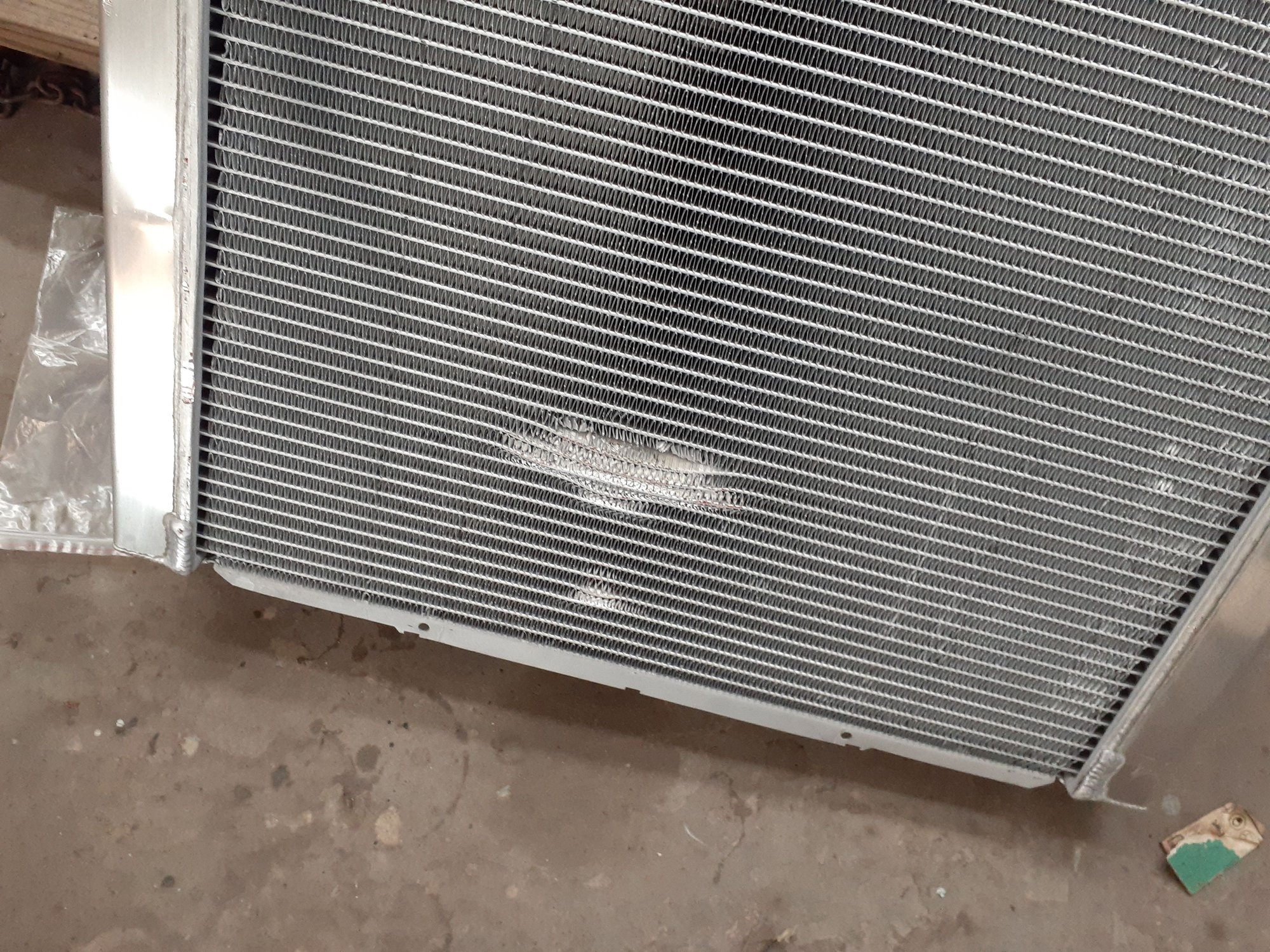

Picked up on of the Summit Be Cool bone yard rads (may have put a hole in it while it was sitting in a safe place, engine stand fell over on it) may have to reorder. There's a reason we go over budget. Picked up a Contour fan for it.
Fuel system is all plumbed, Quantum 380 external pumps, was orig going to use the LS1 fuel rail, put hit the coils I was using, so picked up new rails, better in the long run. Holley X Max will control it, prob use the tune from the Hornet, pretty close setup, makes life easier. I am a duct tape tuner, lol, while not all the bells and whistles, it runs fine for me. Hopefully Fire it up in a couple weeks, would like it running before surgery, hopefully after I recover I can redo (correct) stuff I did to just get it running. For now the old 7.5 rear will stay, did use 5 lug axles, and the stock driveshaft fit perfect with a 400 1350 yoke, 1310/1350 adapter joint.

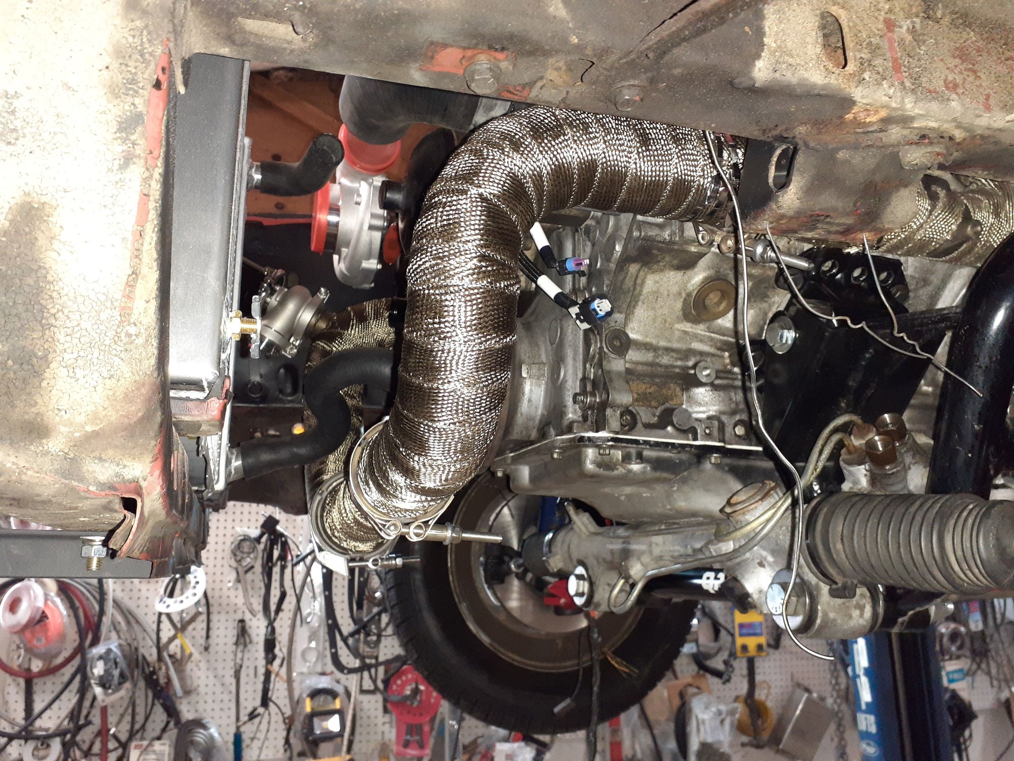

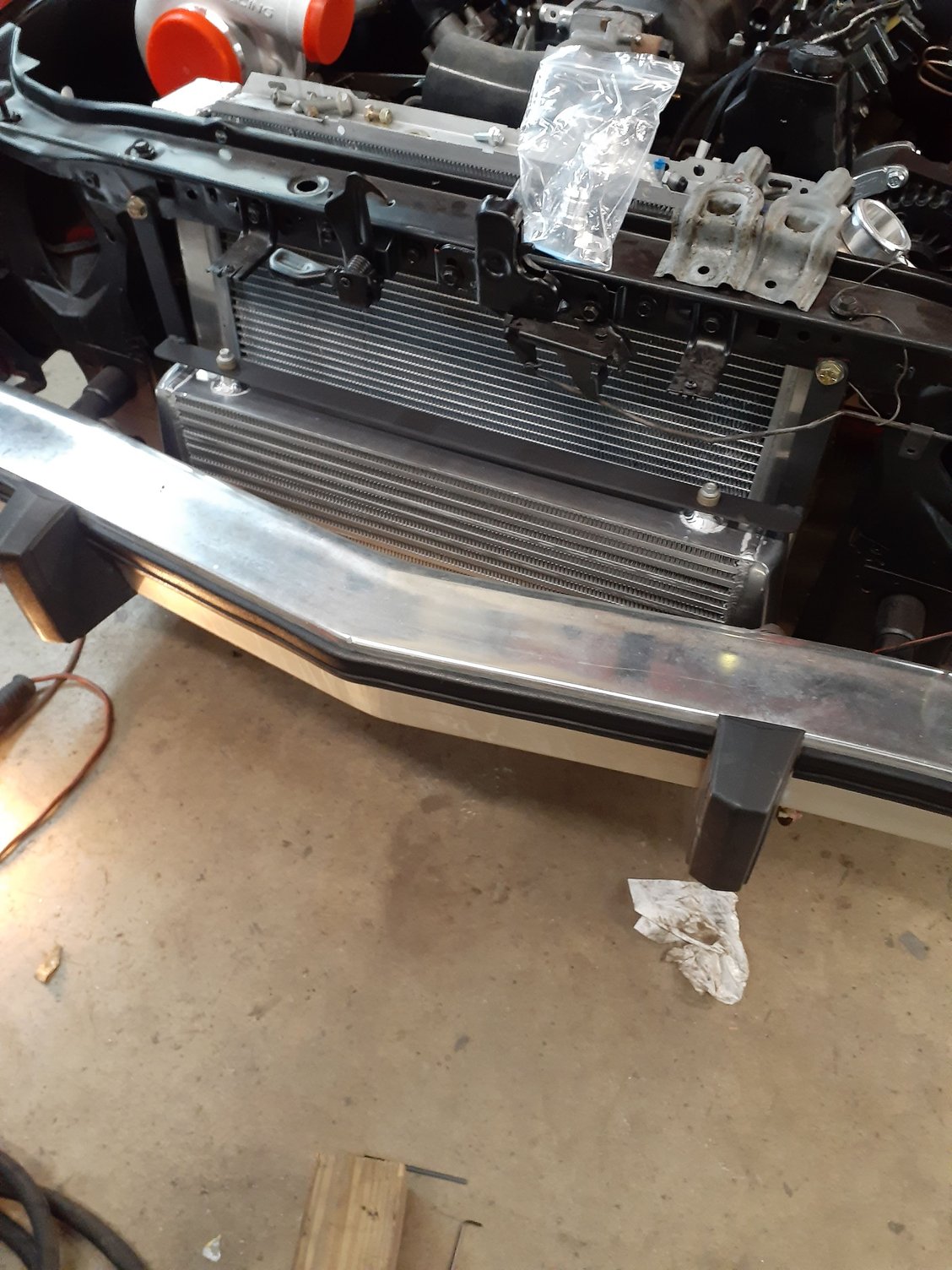

Although the intercooler is mounted, I wont plumb it for now, just run turbo to intake. Trying to figure out a way to pressure test the rad., maybe duct tape would hold 15 lbs for testing, but most likely the thing is toast. Hey Summit, feeling the spirit, I need a rad, lol. I used 2.5 pipe to the turbo, the 2.5 V bands seem to fit the manifolds best, prob won't hurt spooling much. Goal is 500 RWHP, but with the unknown engine won't use much boost, prob build a better alumn. engine later.

May be surprised, that rad may not leak from what I see in the pics. Maybe hose with a frost plug clamped in it can seal it up for a pressure check

Well, some good, some bad, lol. Finally got far enough to fire it up, radiator seems OK, no leaks where it got smashed (so far). I loaded a tune from my Hornet, since it was also V2, same as in the Holley I got. I wanted to update to V3, but knowing my abilities I took the easy path, lol. I tested the fuel system for leaks, all seemed good. I hit the switch to see if the starter worked, kind of used the Fairmont setup, remote sol instead right to the starter. I forgot the fuel system still had pressure, thing fired right up. I really didn't want it running, as planned to prime the oil pump since this motor was used, prob sat a while, but pressure came right up. Since I have fired it up a couple times, checking stuff, feels like it has a dead cyl, seems to be adding to much fuel, lot of blue smoke out the exhaust. My fear is the engines no good, but going to try some stuff first. The injectors are decapped LS3's, I used them in another car, were OK, but loading the info in the Holley is kind of iffy, so ordered some Deka 80's, easy to use the drop down info. Soon as I get them, going to replace the plugs, build a new tune, go from there. Sometimes excess fueling can thin the oil, create problems, but suspect Im not that lucky. If no improvement, start pulling it apart enough to leak test the motor, see where its at. I have enough parts to throw together an L33 shortblock, but def not where I want to be at this point. Almost forgot, another problem, fuel leak at the tank. Welded a sump to a new stock tank, using external pumps, pressure tested it was fine, now a leak popped up, but its where the bung is welded to the sump, it comes that way already done, so not sure what I am going to do there. I'll see how the other stuff turns out, go from there. We having fun yet, lol.

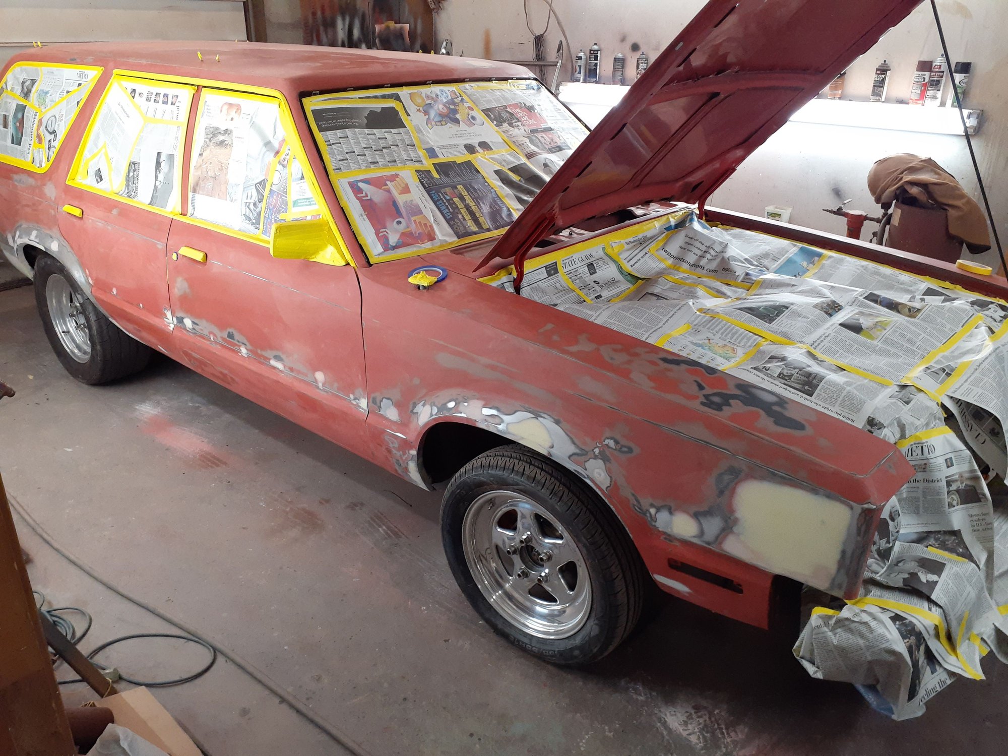

Old Mar 28, 2024 | 07:40 AM
forcd ind's Avatar
Joined: Sep 2007
Posts: 4,188
Likes: 293
From: woodbine, md

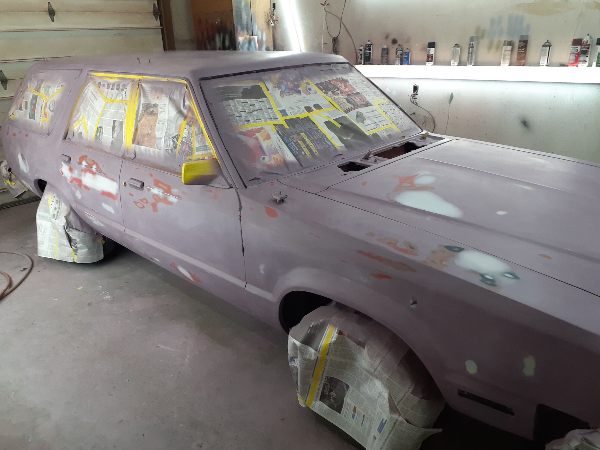

Got the body about as straight as I can, hopefully paint it this weekend, but its been raining a lot. If the humidity gets to high it can make the paint blush, so hopefully I get it in. Should have gotten some slower activator, I'll see how it goes.
Old Mar 28, 2024 | 09:21 AM
Black_Sunshine_99's Avatar
Joined: Mar 2013
Posts: 3,895
Likes: 862
From: Washington
Don't rush it hoss, you've got plenty of time, spring has barely sprung.

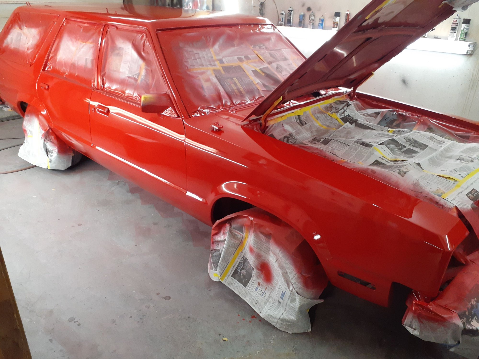

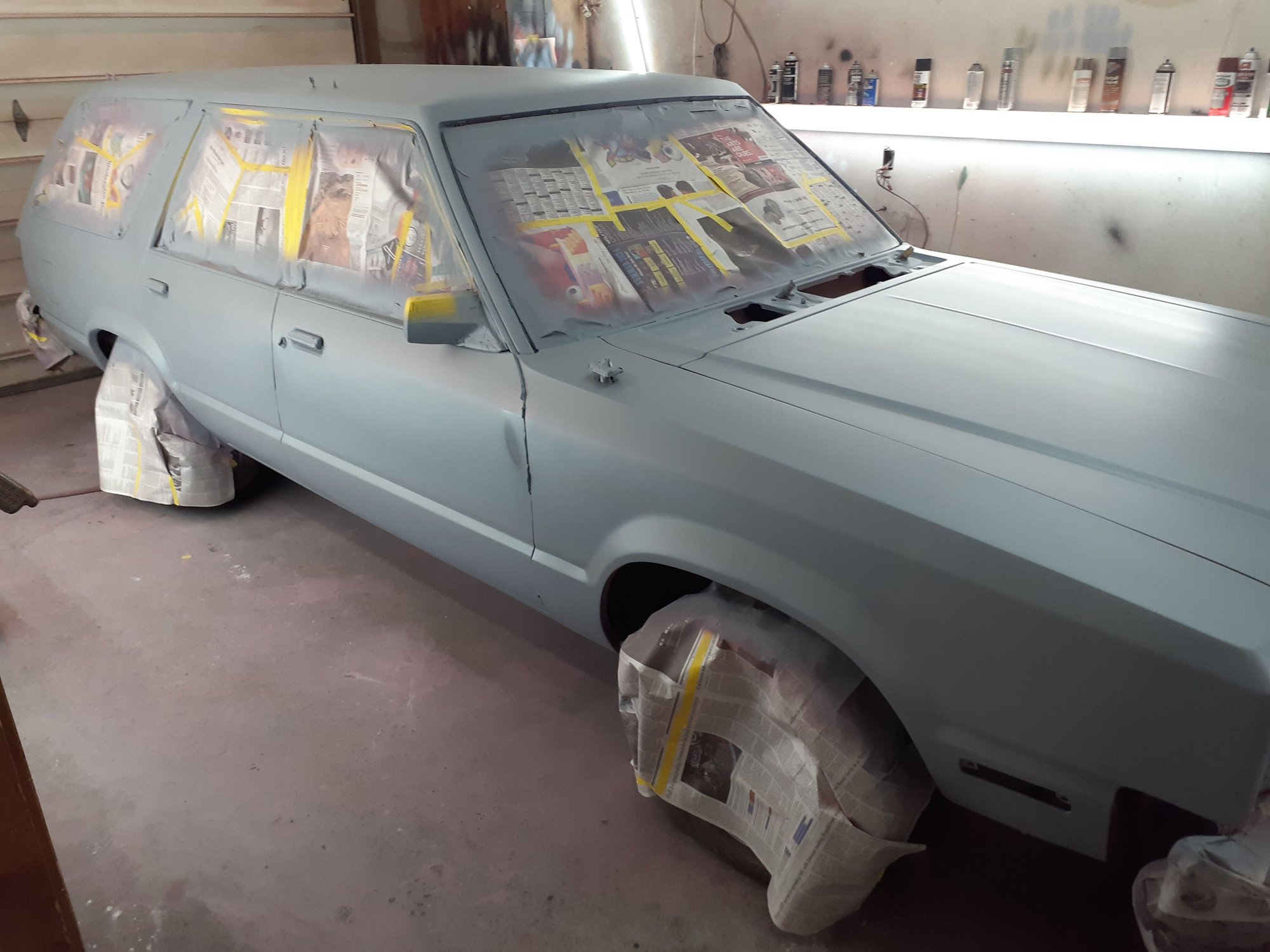

Old Mar 29, 2024 | 05:40 PM
forcd ind's Avatar
Joined: Sep 2007
Posts: 4,188
Likes: 293
From: woodbine, md
Finally in paint, now I can put back on the lift and finish up some things then dial in the tune. Need a couple beers to wash away the paint smell, lol.
