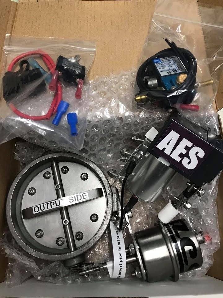

I just ordered this cutout from AES Racing Muffler out of Australia. It’s super beefy and high quality. Come with the whole vacuum pump setup as well for under $400.
