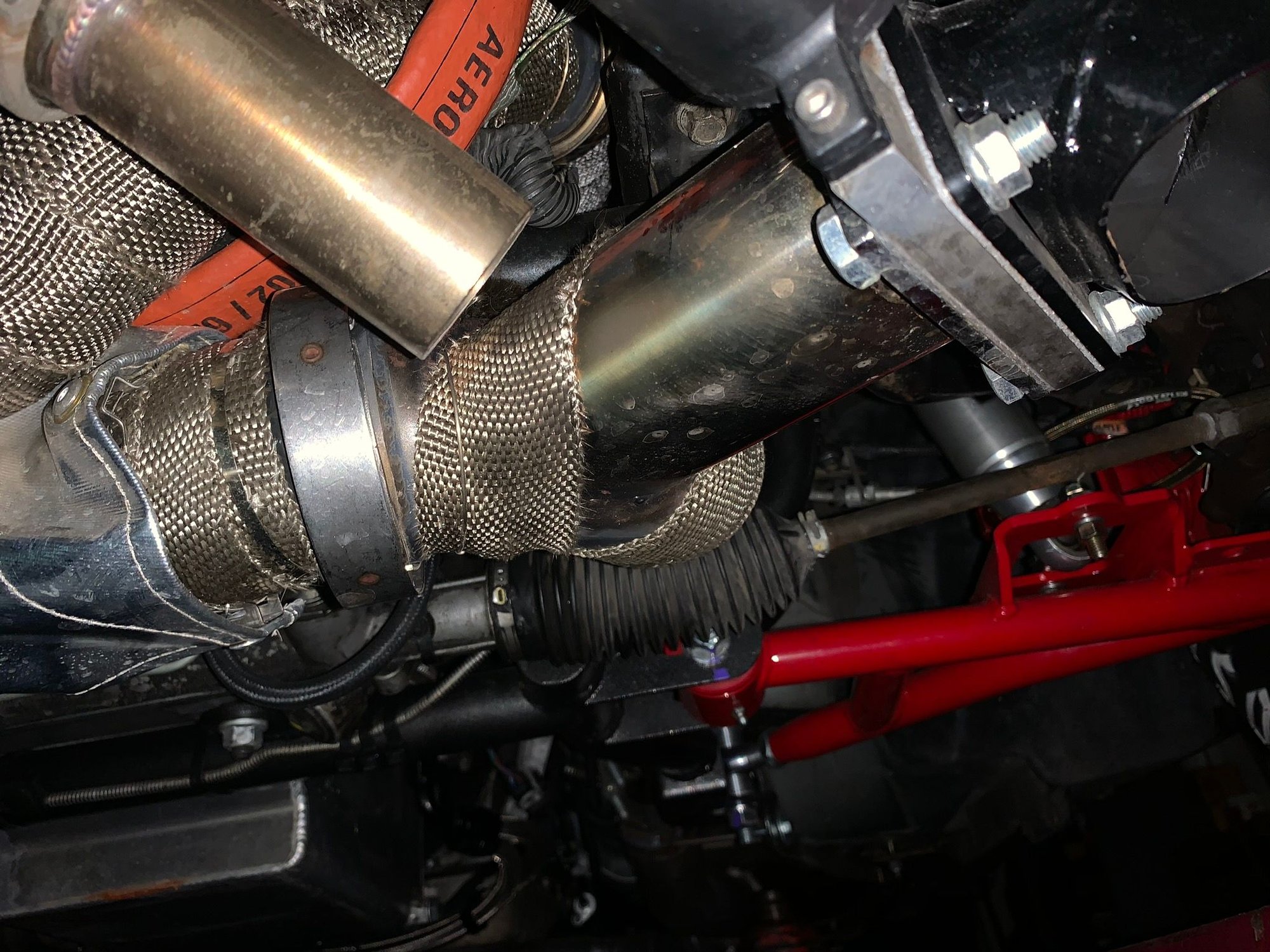

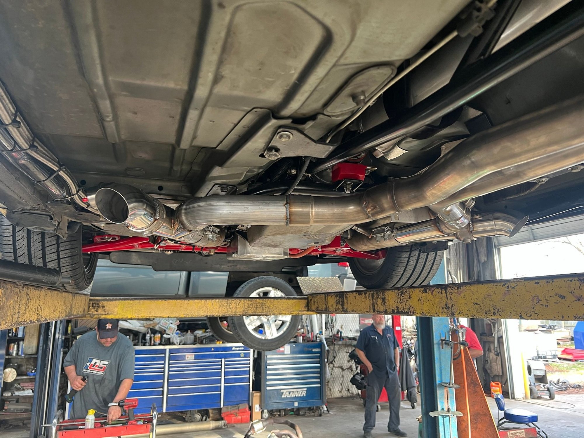

I like the failed position closed (quiet)so I went boost activated loud valves. I would have had to do the quiet vacuum pump thing had I used the other one. I had a QTP Oval on the down pipe before when I was single turbo. No issues that way either.
My setup is pretty slick now with the Huron Hidden Twins going to 3” down pipes y’d into Boost Loud Valves tied to a Hooker True duals with stock exhaust tips.

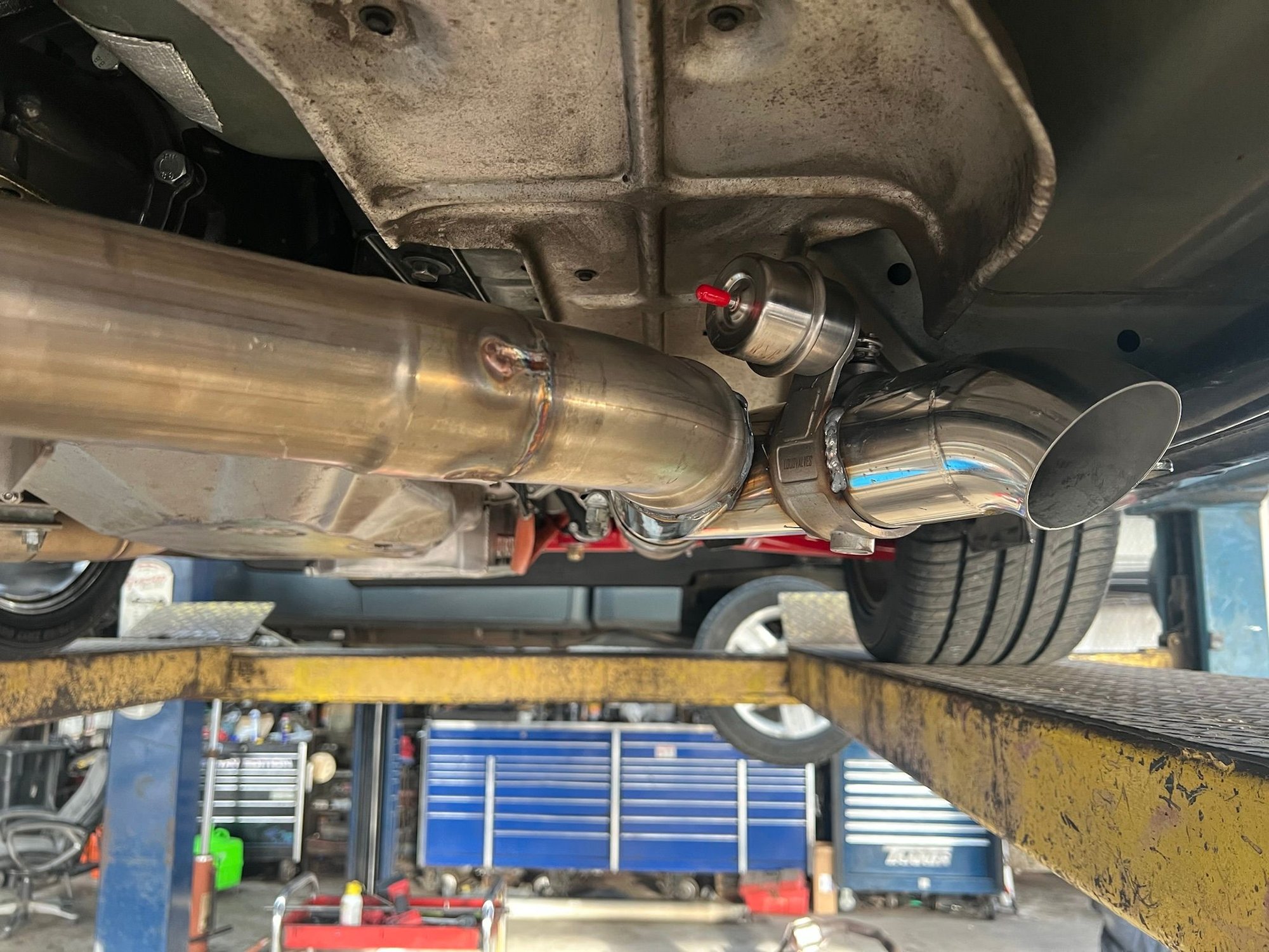

The Single QTP setup off of the Huron T4 AC
