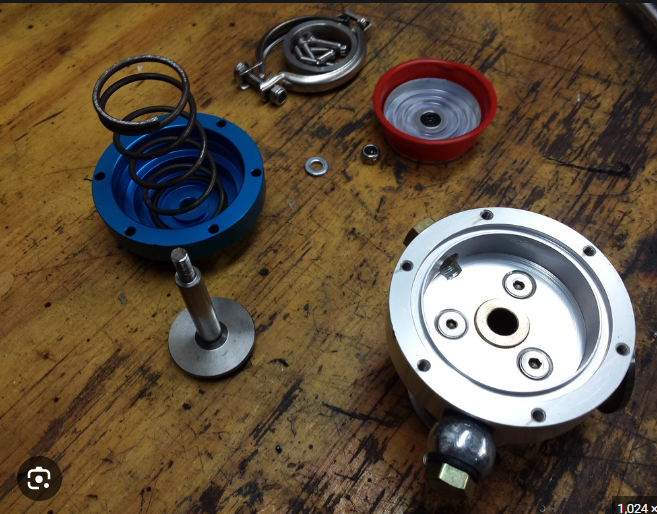

Same here with VS gates on 2 projects with no issues, mine is 30k miles / 5 yrs - no issues and have been 1200+ miles from home on many occasions. Wastegate is a pretty simple device, as long as the valve seats well on the fire ring , the stem has enough clearance and no burrs and the diaphragm isn't torn or deformed/ pinched. Bench test and good to go

I've had Turbosmart & JGS gates both very nice & work well. On my car now is ebay turbosmart compgate knockoffs($50ea). They've worked well but when I got them, pulled them apart to deburr,
clean, high temp lube on the stem & lap the face to the fire ring. Forgot to do that on my friends car & had 1 only move 1/4" before sticking. They worked & still work fine after a little work.
Just my experience, do what makes you comfortable.

You get what you put into it in my experience. These are bottom of the barrel 38mm gates from Ebay. Under $60 each. If placed well, its more than enough gate. I used them on a divided hotside, one per bank.
I tear them apart before running them. Remove any knicks on the valve shaft, debris and crap form machining stuck in the diaphragm. Inspect/clean it well. lap the valve to the fire ring if its bad. (they usually are) Then Re-assemble with red Loctite (super common for screws to vibrate loose). And use antiseize high temp rated grease on the valve stem.
If I do this, I’ve yet to have a failure. Tossing them in without doing it has always bit me. Ideally you want to do this every other year or so for maintenance as well. I’ve been pretty bad about that. Been getting 4-5 year service time with no issues. But I didn’t put 1000’s of miles on mine. I have an 16 mile round trip to the local track and try to get out there most weekends. Cheap gates have been good to me.
