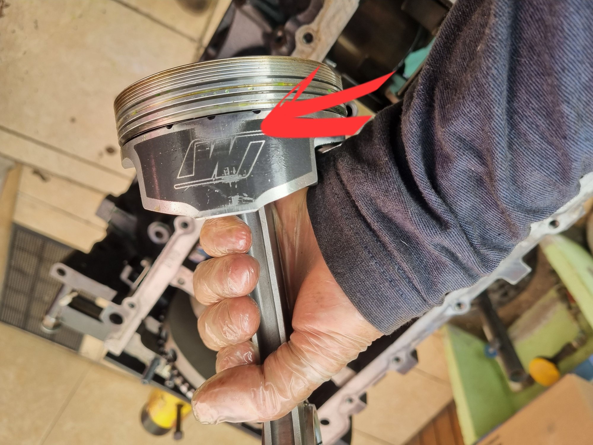

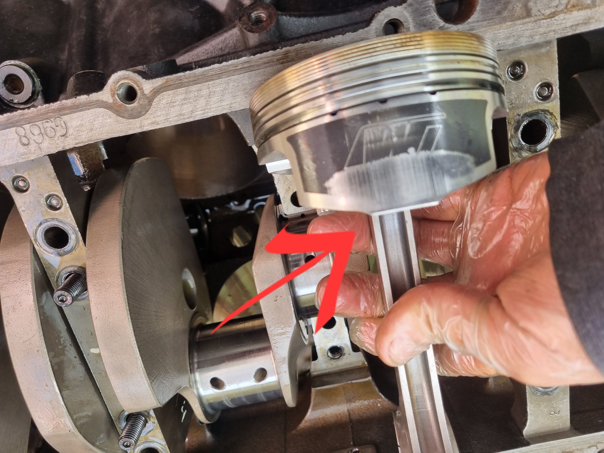

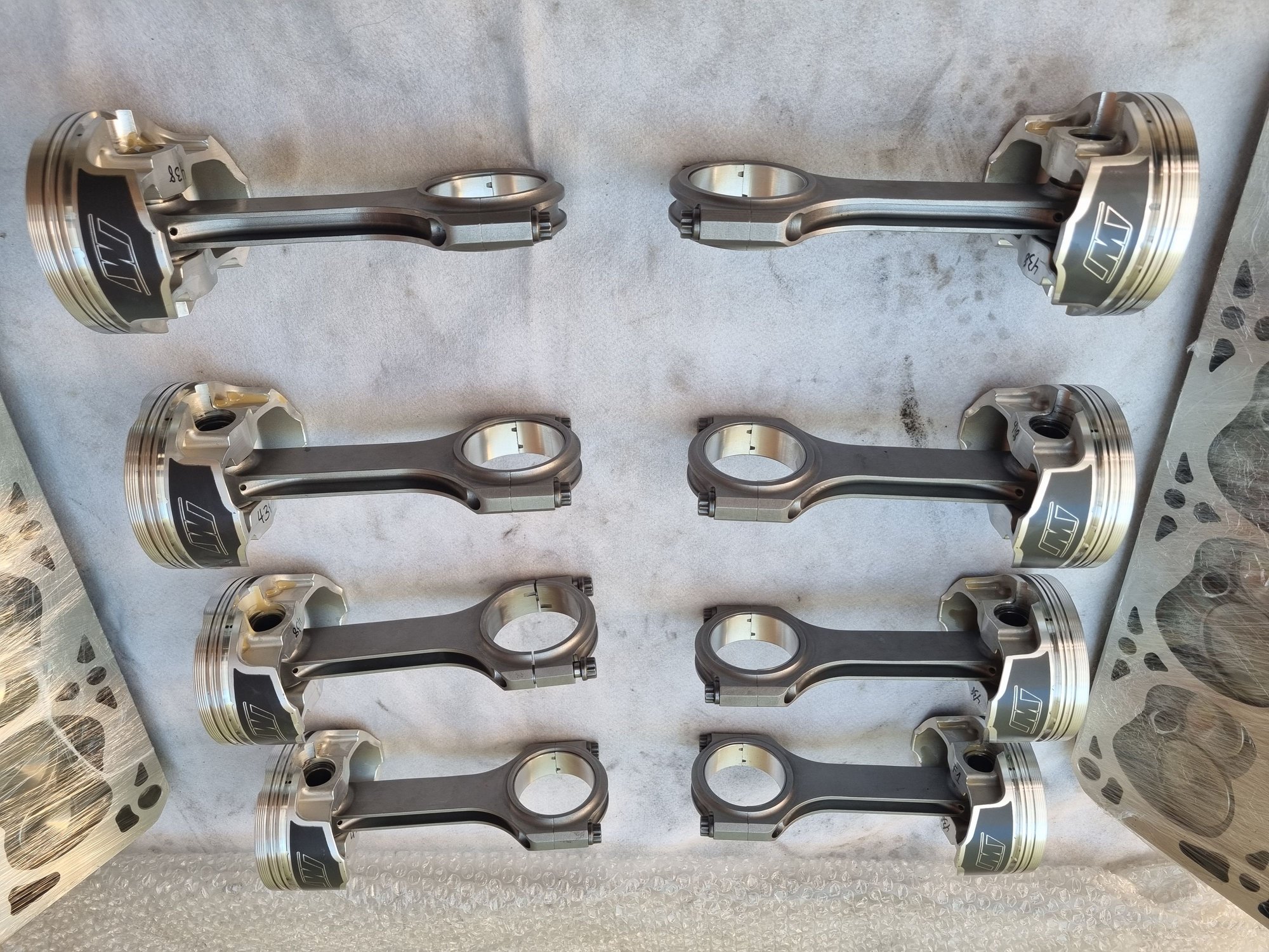

I had a lot Piston Rock with Wiseco Pistons and .0052” กก, pictures

I ran for almost 8 years as a pump gas with the same Wiseco piston and .0038" and without any problem, but now with .0052" (.0040+.0012) it was piston rock.

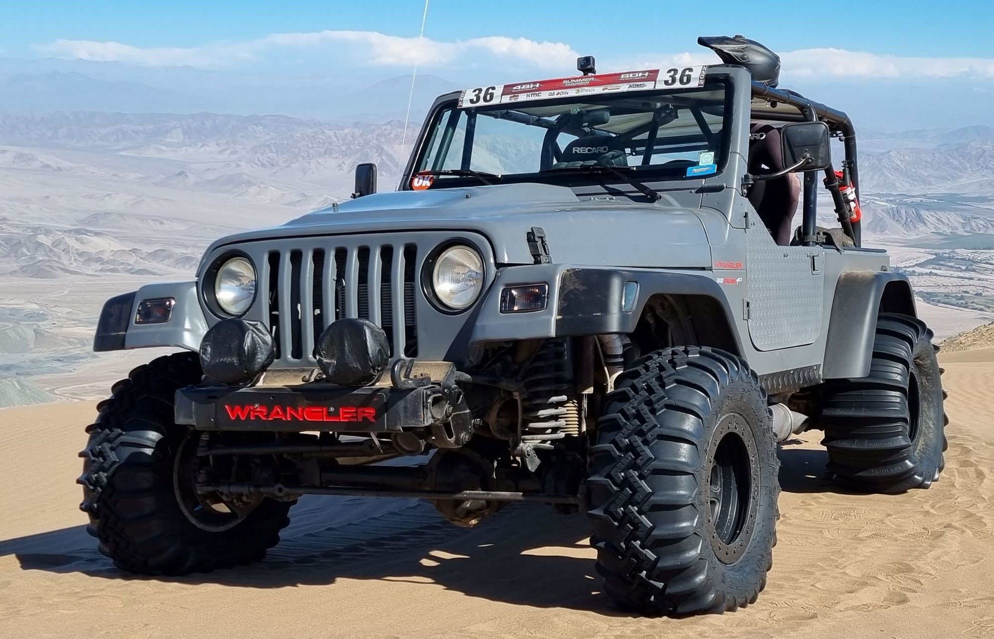

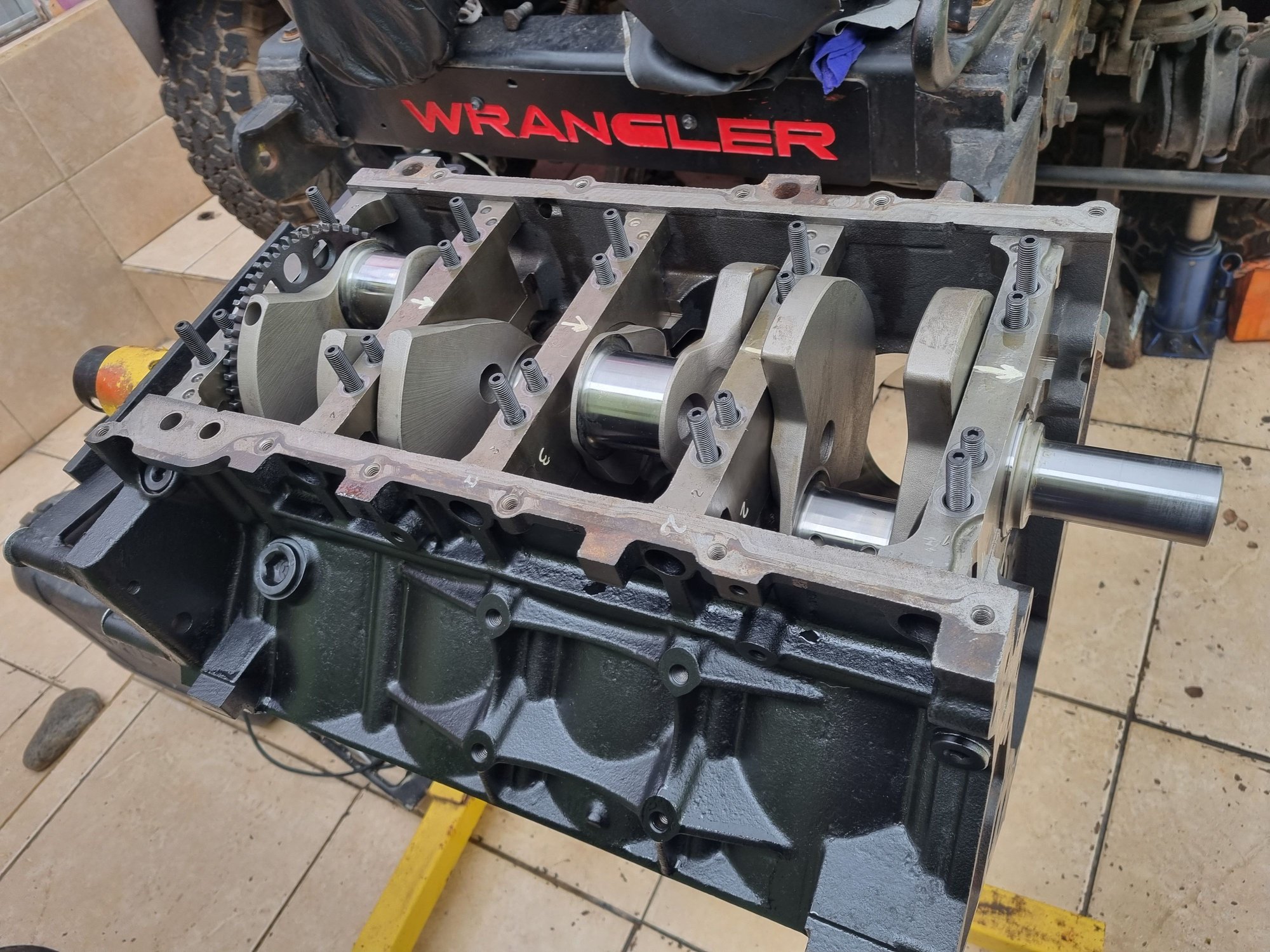

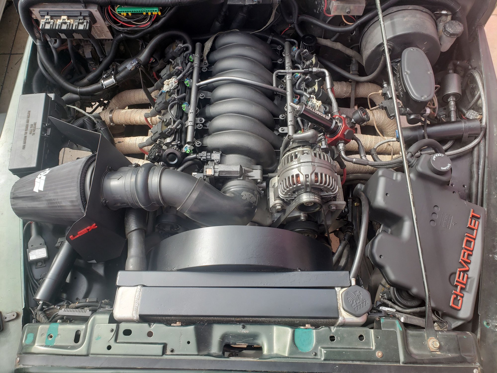

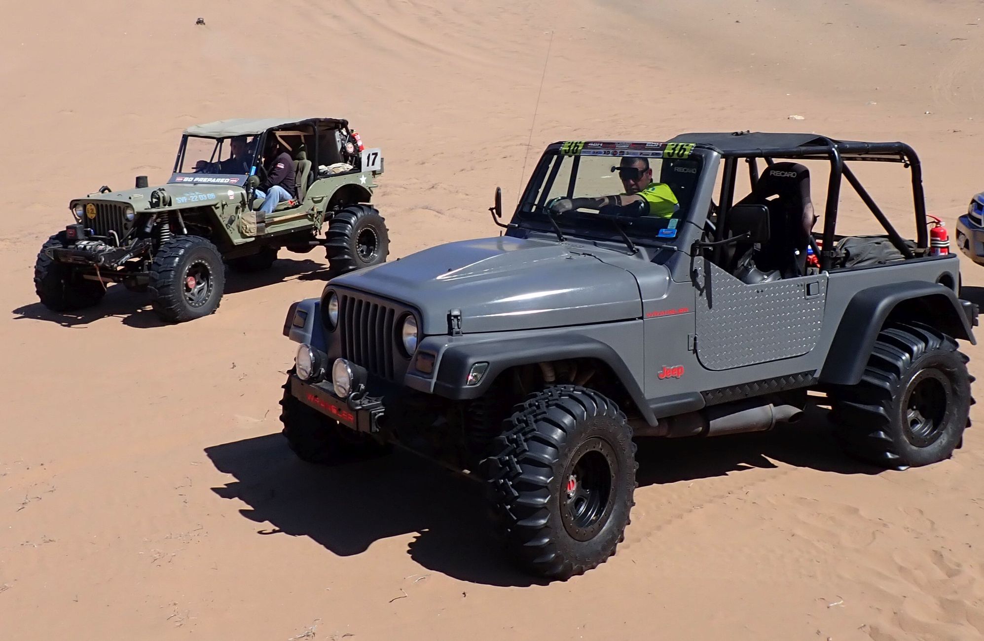

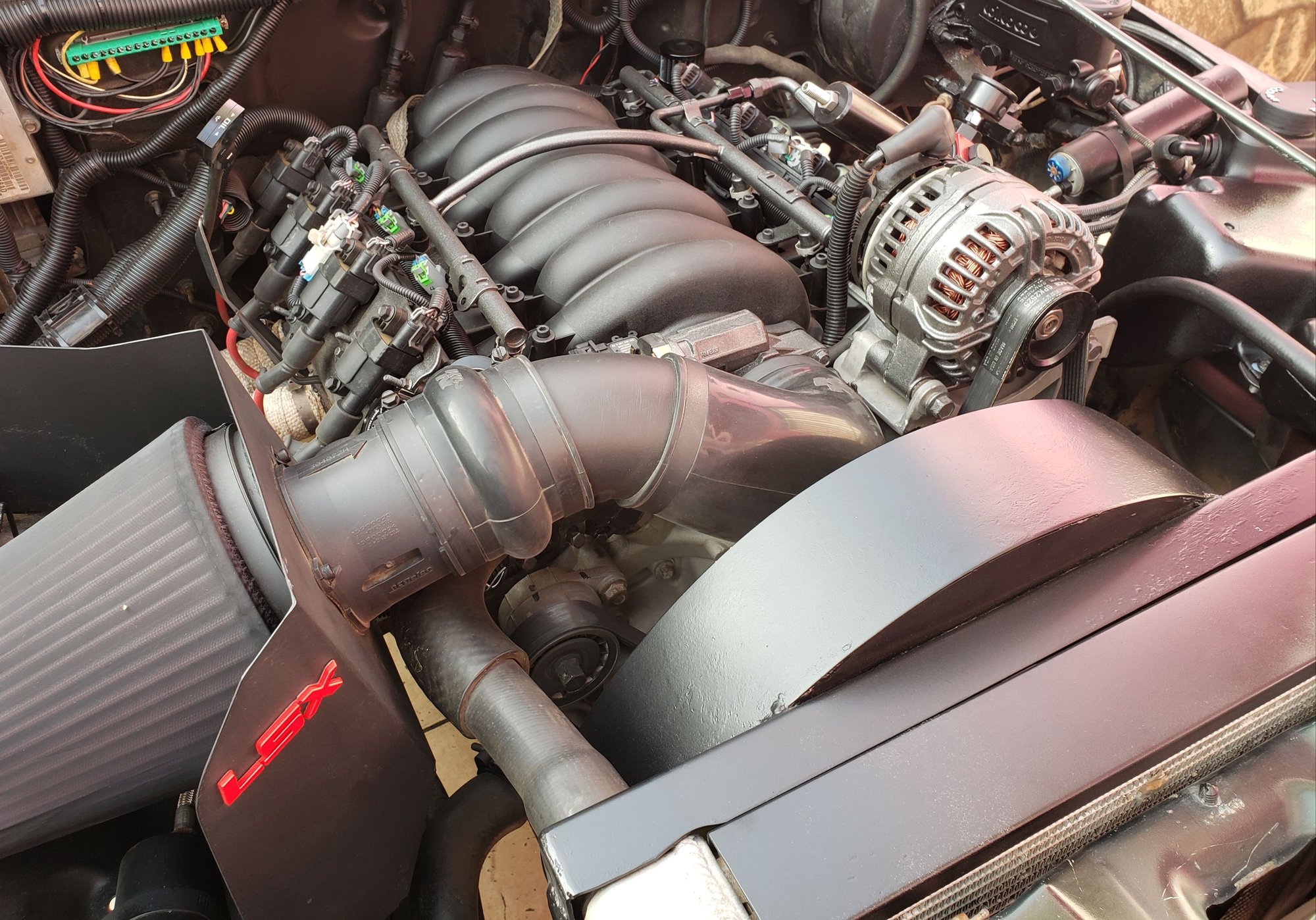

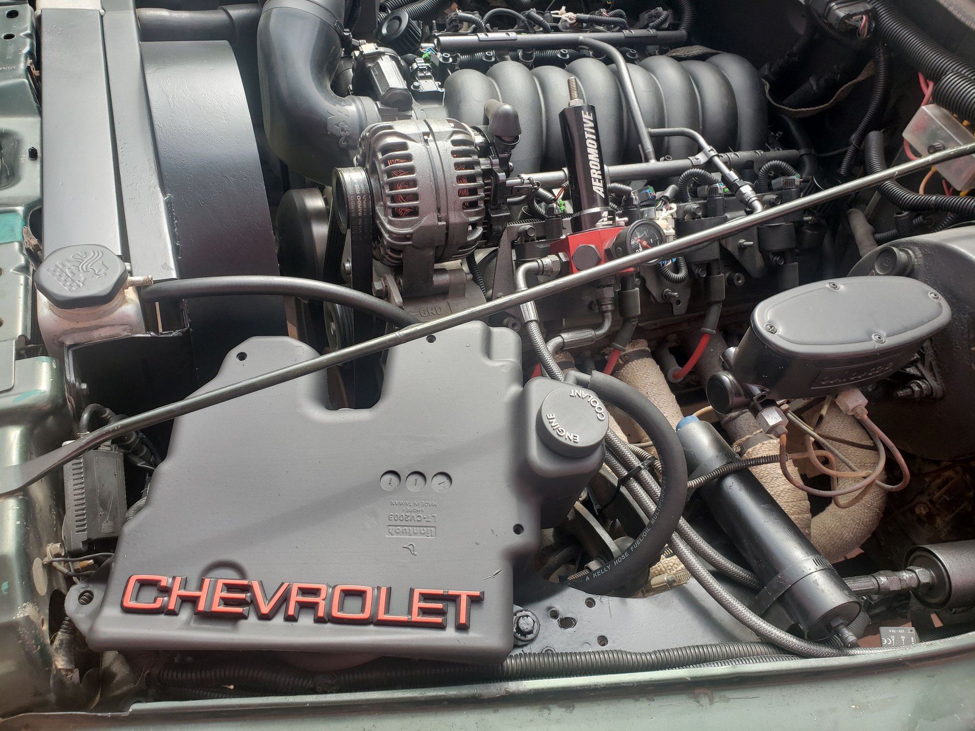

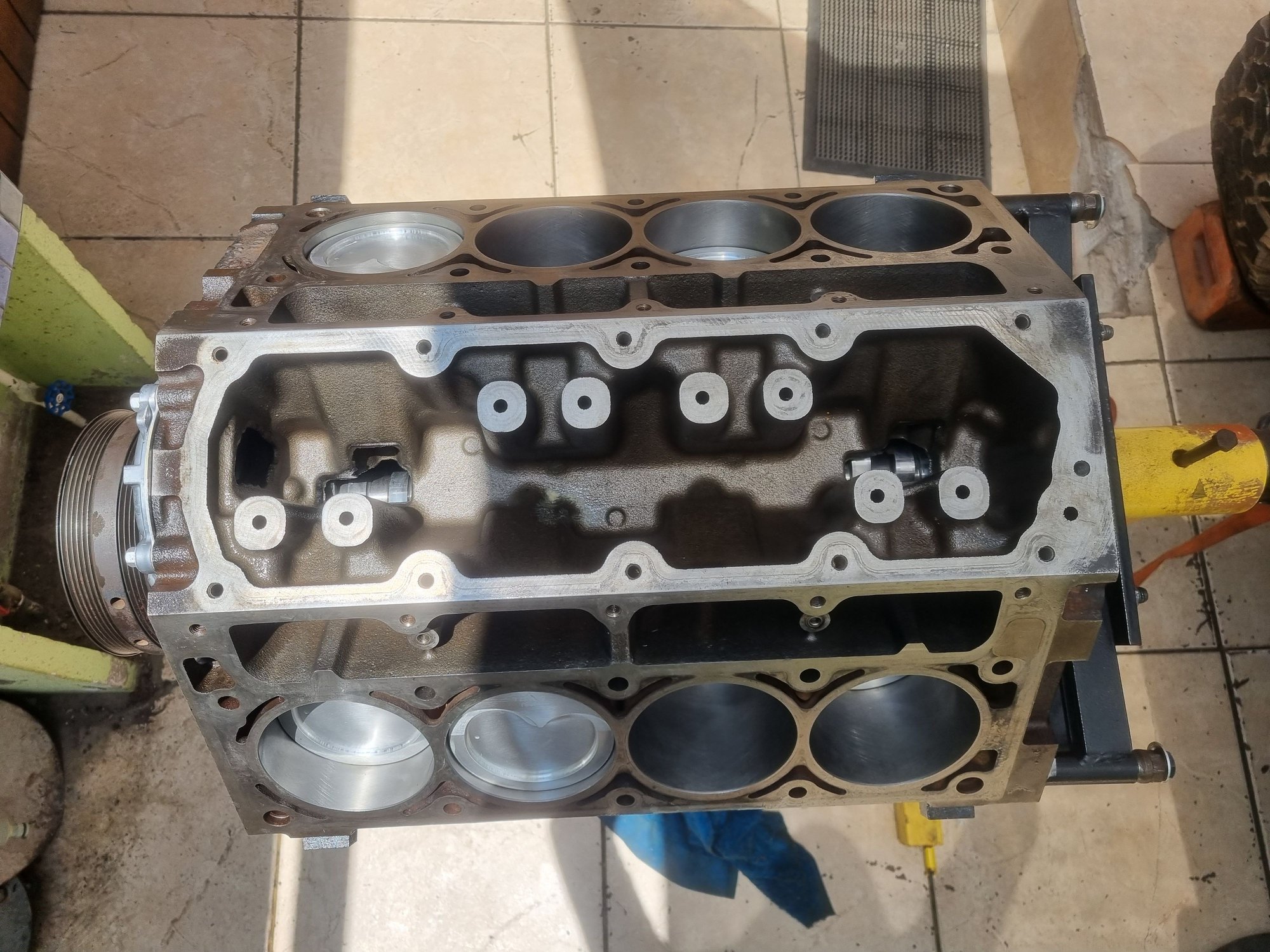

This is my JEEP and 402 Engine, some pics

That thing is wicked! Love it!
