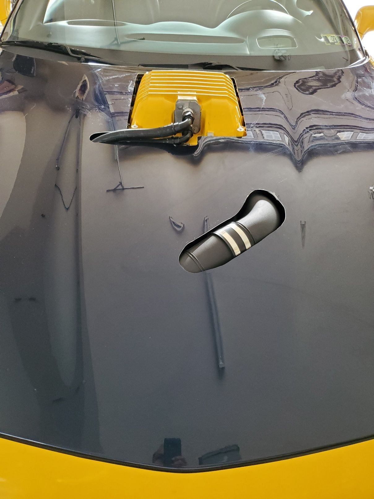

Practice Hood - GLAD I got it. The -10 lines will be easier to hide. The intake tube is going away too.

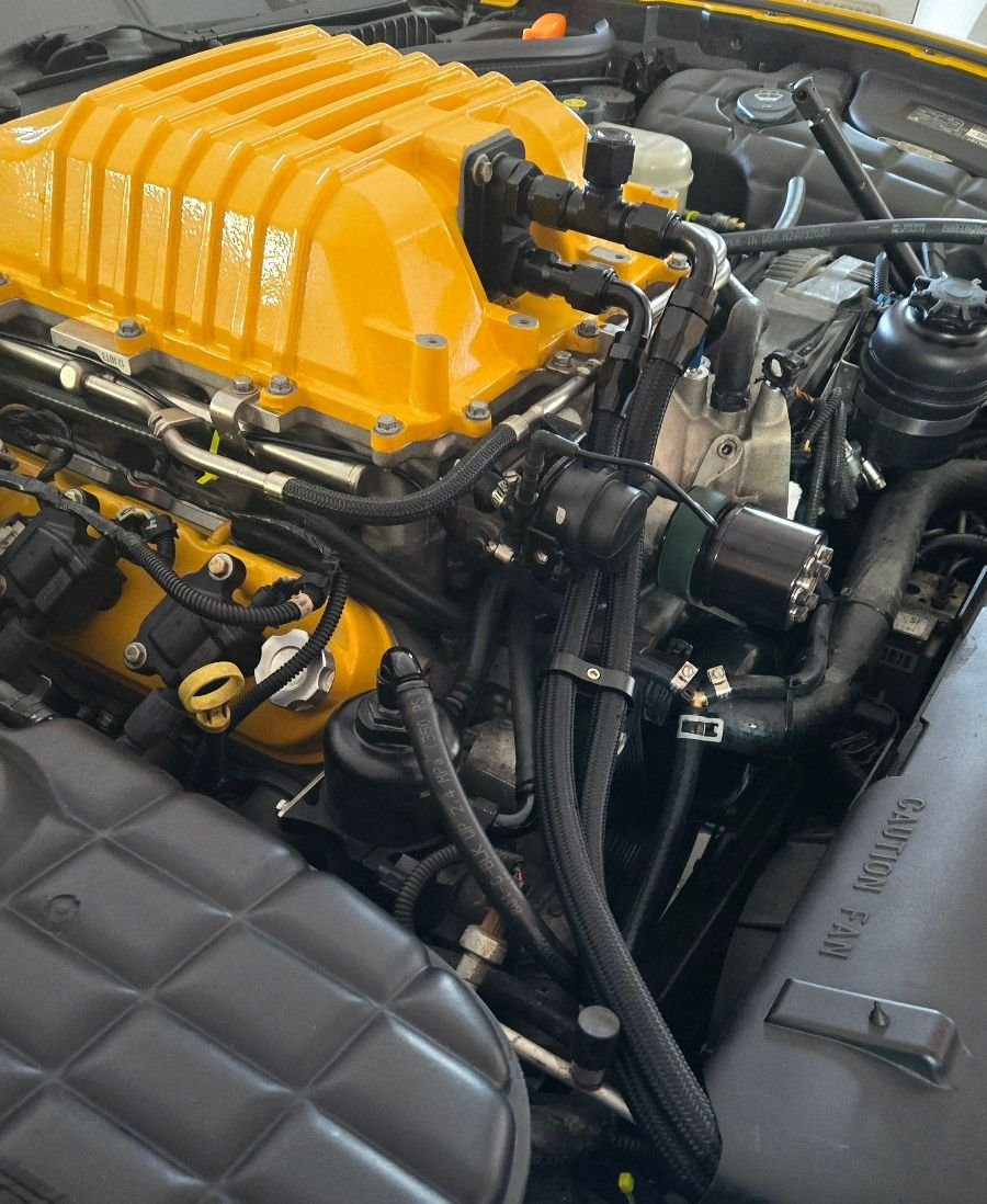

Just a follow up. I got it done and bled - no leaks either. The 10AN T with the cap is the high point and I used it for filling - I don't have a reservoir. What ever is in the system is what I have for cooling. It's not a race car so I'm not really worried,

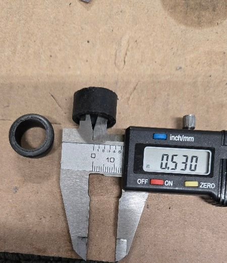

The Hose Barb / AN conversion fitting works if the barb is cut off. The O-Ring acts as a compression sleeve and it holds surprisingly well. Not gonna be a problem at this point.Cutting the barb off the ZL1 Heat Exchanger showed the ID of the Inlet / outlet to be just over 1/2" so the 10AN hose (or ANY size) is limited by that. Here's a couple pics.
I'm happy with the way it turned out AND I can get rid of that UGLY tube showing thru the hood
10AN is easier to hide.
ZL1 Outlet tube - that's as big as it gets!
