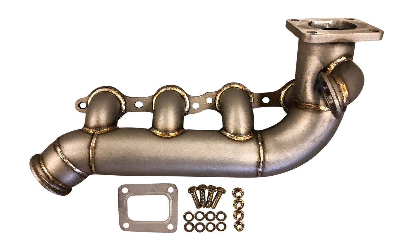

BUY ALL THE THINGS !! (Huron Speed makes a VERY nice manifold, you'll also need a bigger fuel pump )

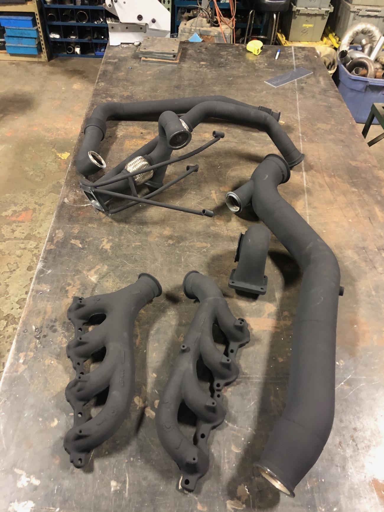

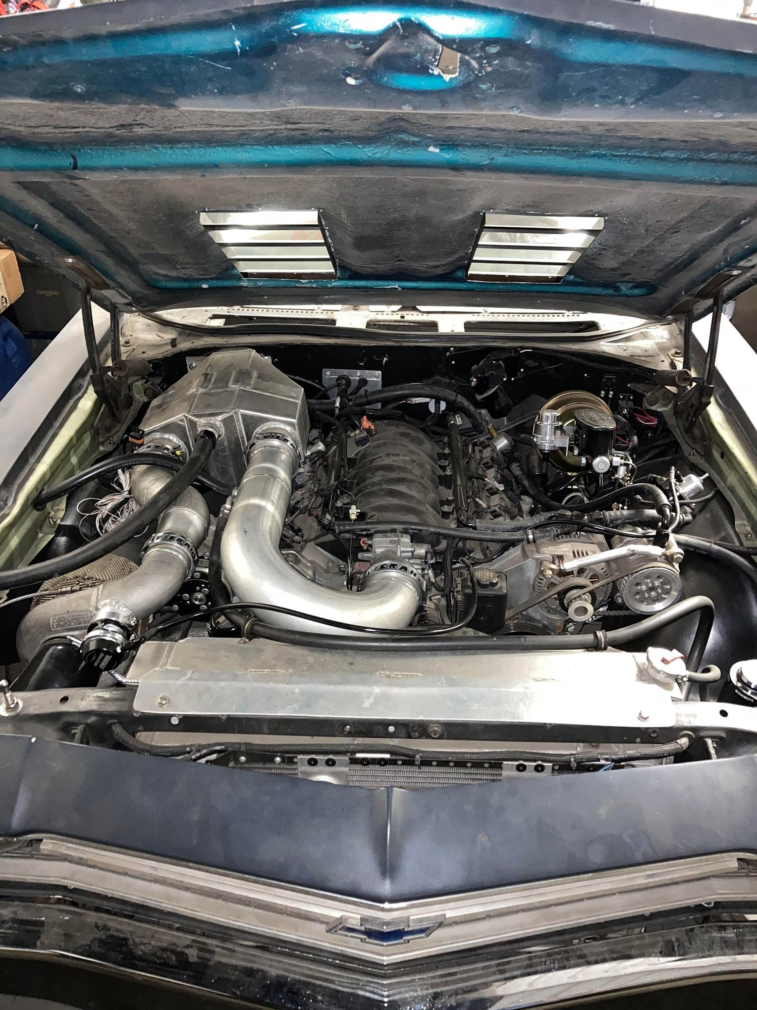

If you can fabricate there is no reason you can't use the stock manifolds.... these are truck manifolds with a 2.25" crossover to the turbo on my '69 Chevelle and large 60mm WG (overkill for your HP needs). I've read that 2.25" can support 1500hp or so before it becomes a bottleneck. The smaller diameter vs. 2.5" should help with spool time also.
You don't need much for a 4.8 to only make 600hp with a turbo. Bigger injectors, turbo, wastegate, intercooler. That cam is tiny and doesn't make much power up top. I would put in something bigger plus upgraded springs. Pull the oil pan and confirm if you have Gen3 or Gen4 connecting rods (Gen4 are stronger and normally were in production engines beginning around 2005).
