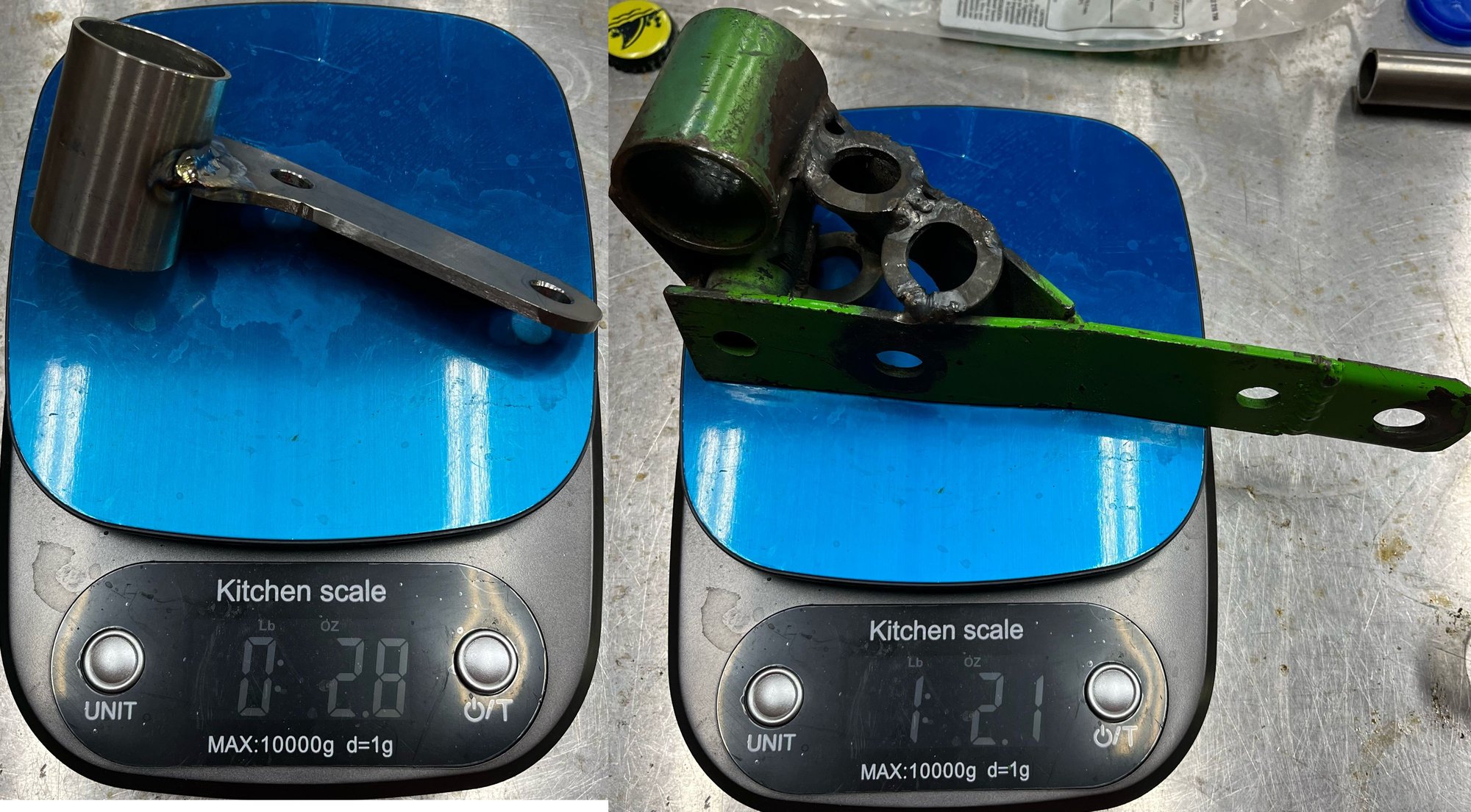

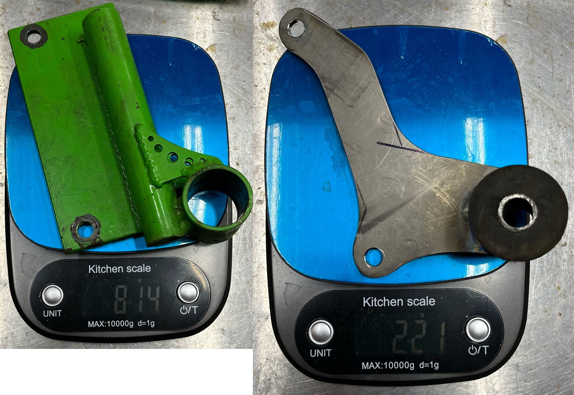

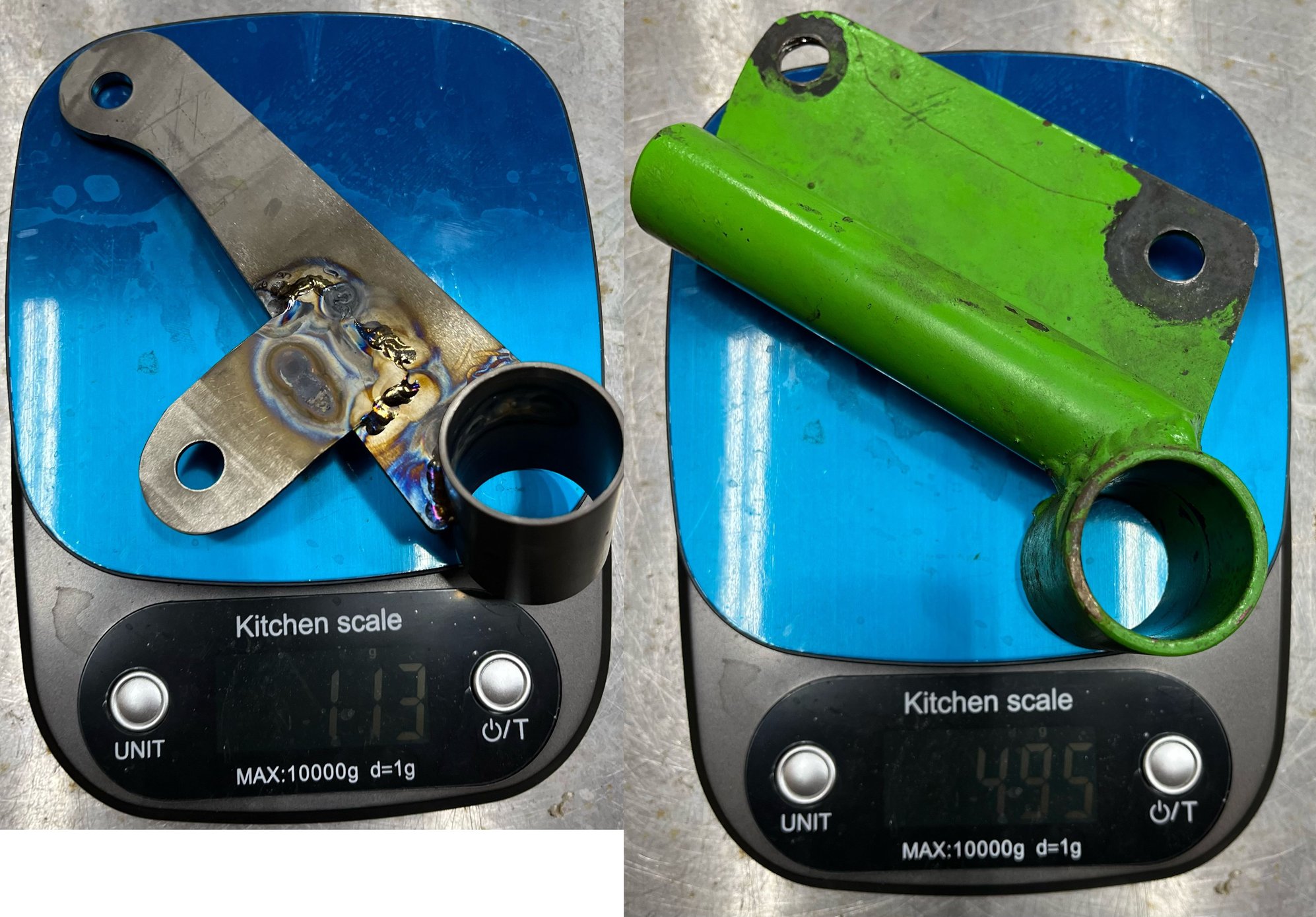

I rebuilt 3 of 4 motor mounts on my tube chassis bug in titanium and it saved just under 3 lb total

man you need a back purge plate and way more gas! You’ll see my setup when i come for my tune lol. Ive replaced all my fasteners with titanium, aluminum, and removed many of them. Also using a bunch of carbon fiber to replace panels like the hatch, roof, hood, and fenders.

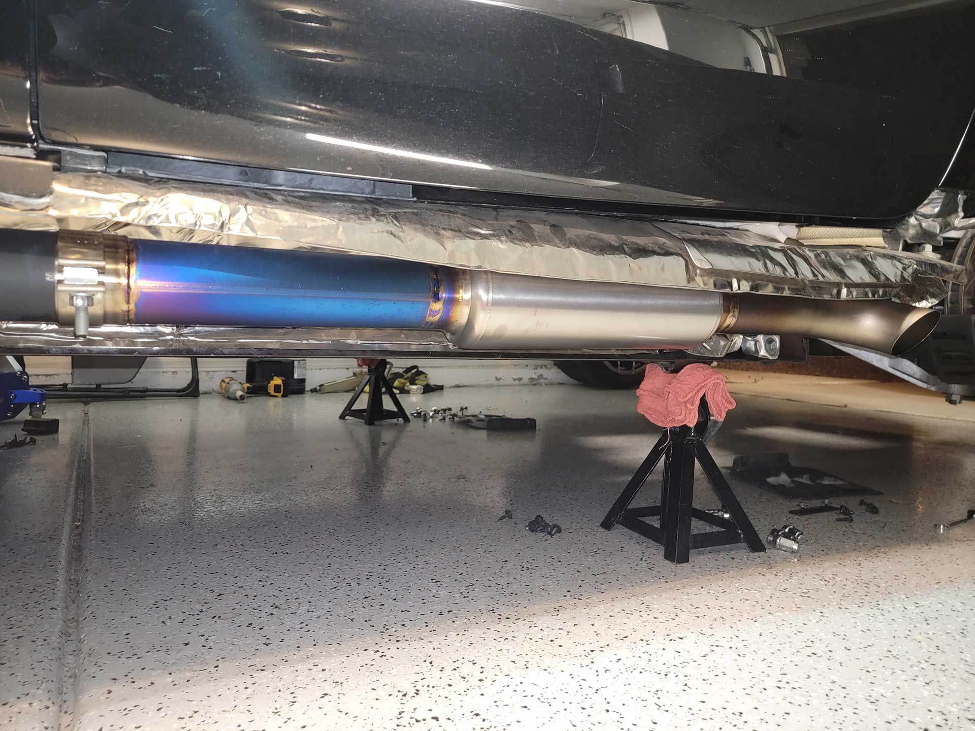

I wouldn't do titanium from an exhaust manifold to a turbo flange but running titanium after the turbo can save a LOT of weight depending on how much you have. Just two titanium mufflers and a bit of titanium for the bends and tips after the turbos on my Viper saved ~35 lbs over the stock setup.
thats great to hear! The old 3.5” stainless x pipe and muffler setup I used to run was over 70lbs so im hoping to lose quite a bit by going to a single 4” in titanium.
