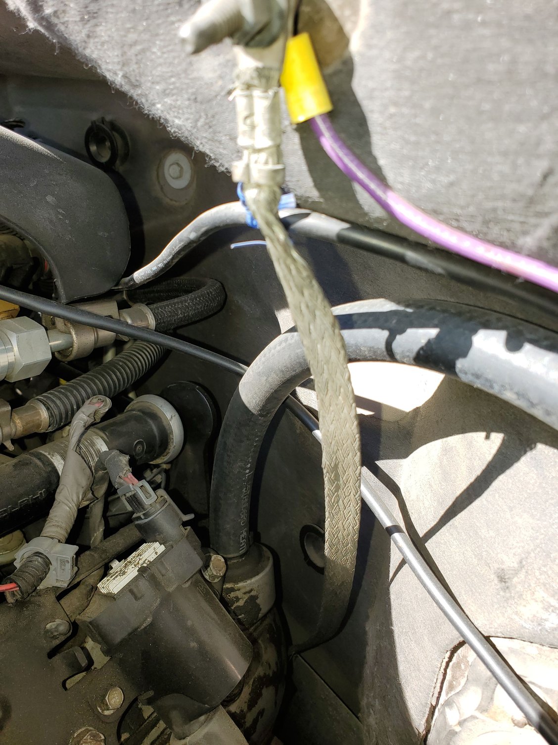

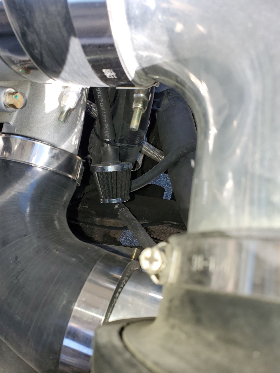

Passenger side Rocker vent hose with TEE fitting, 3/8" chinese "breather/filter"
Is it possible that under BOOST conditions, ( 175kPa) the maniofld pressure pushes BACK through PCV in driver's side rocker cover, overpressure crankcase ?
After a good romp, with 4 or 5 seconds in BOOST, close throttle and I get a YUGE oil smoke cloud out the exhaust: Oil cloud like a worn out 62 Dodge Dart.
Think I need more venting, maybe a TEE fitting, check valve and another breather on the drivers side PCV hose ?

I had the exact same problem, I ran a line from the DS PCV to an oil separator (cheap one) to a check valve, then to manifold, cured problem. Boost is prob. creating pressure in the crankcase, creating problems. I just plugged the PS VC tubes, used a filtered oil cap. I always use an oil sep. if using a PCV valve, you would be surprised how much oil it sucks in the engine.
