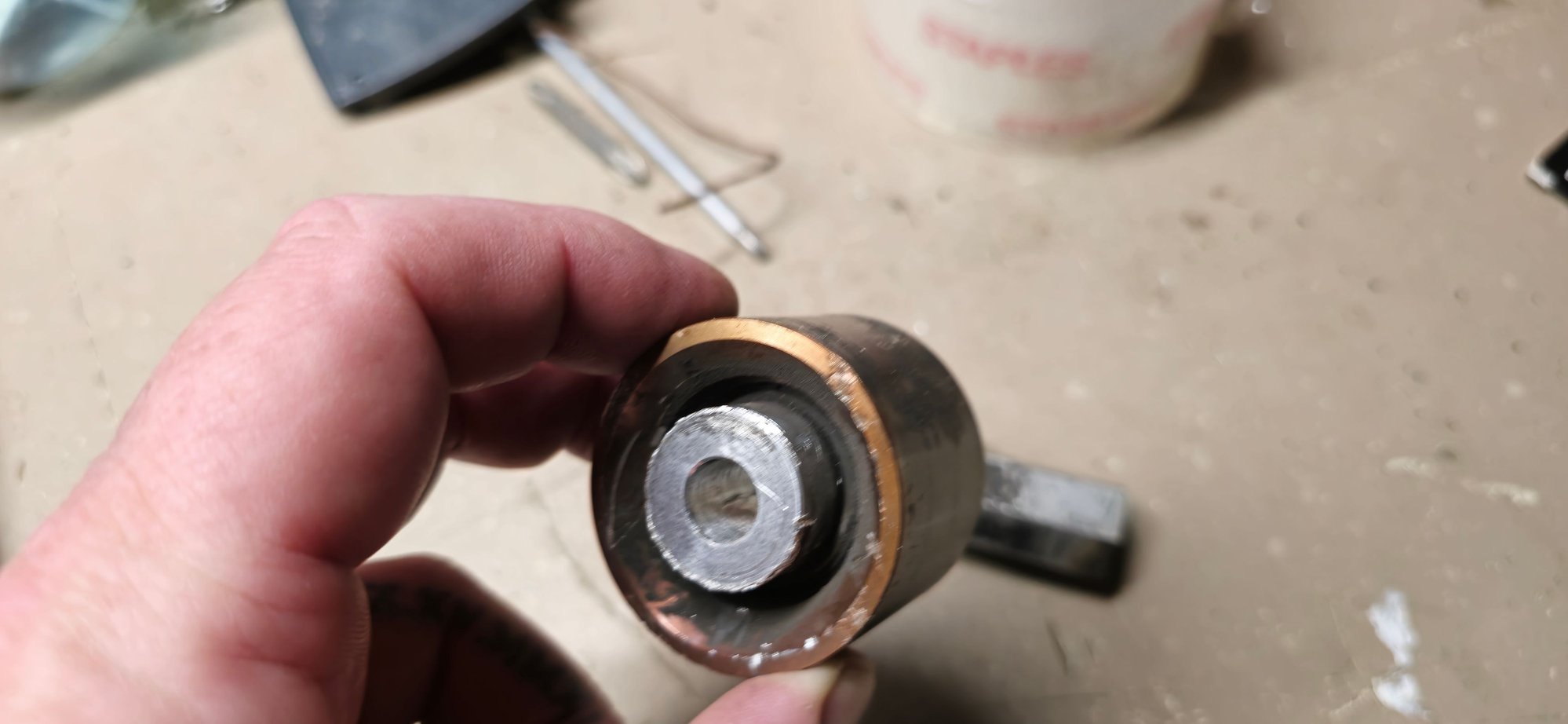

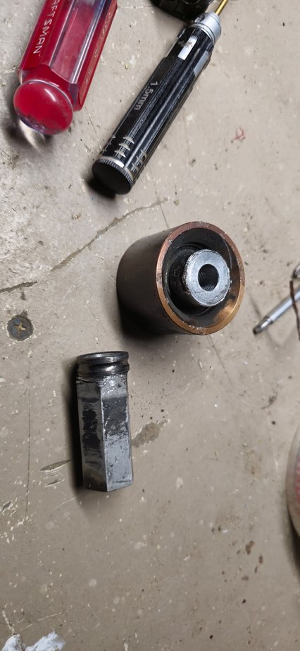

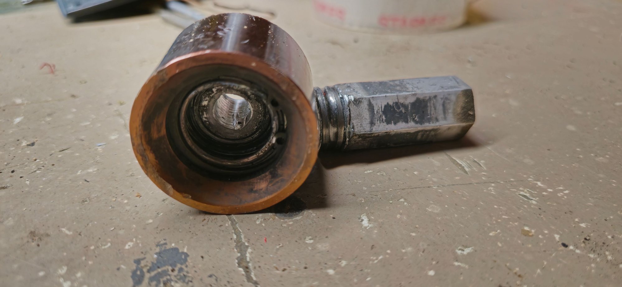

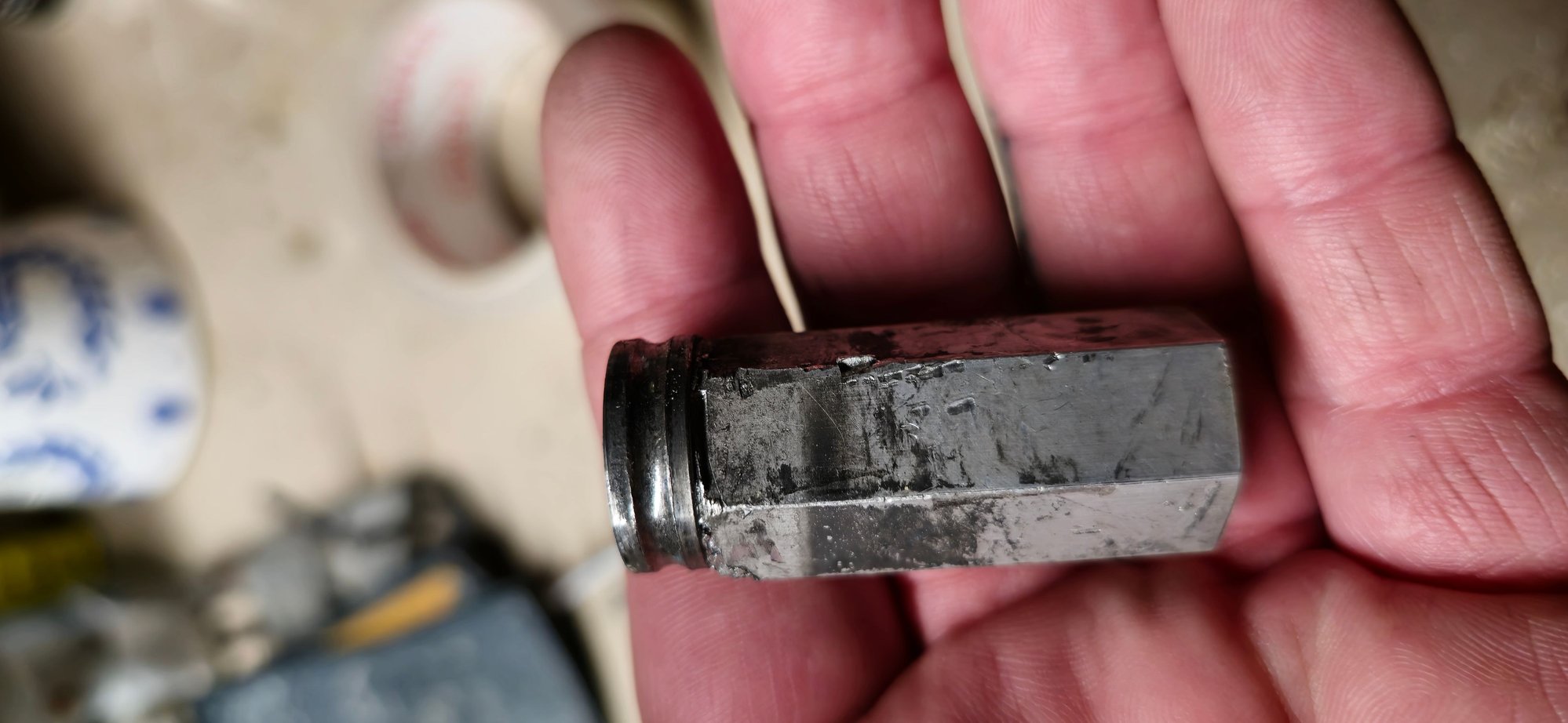

I need the standoff. The bearings look like the ruined the idler and the little piece that goes to the idler is ruined too. I have a picture. Let's see if I can upload it

Dayyumm ! that F'kr got hot and discolored the idler even.....you win !
Let me get mine removed and see what I can get for dimensions. Maybe this weekend

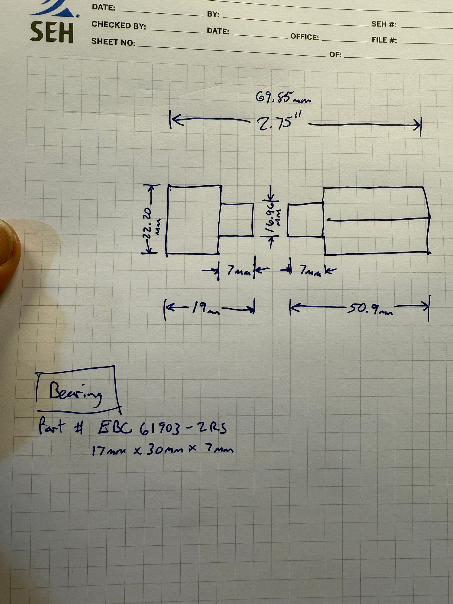

Here you go, this is what I came up with

Thank you.
