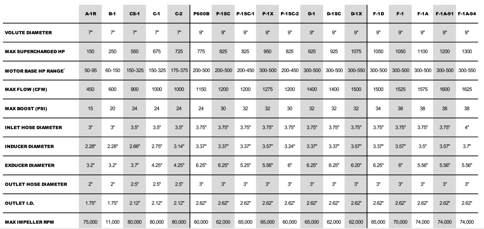

Current power ratings for procharger street head units... With procharger rating the F1a-94 at 1300 and knowing full well they rate the max impeller speed conservatively I do think with a strong bottom end and a more efficient top end I can hit my 1200 rwhp goal with the F1a-94 that I currently have. If not the new F1r-103 coming out is supposed to make F1x power in an F1a-94 size head unit so that would be an option as well.
Keep in mind that the GTO bracket will absolutely not handle a larger blower than what you currently have without flexing and shredding belts. I'm honestly surprised it's holding up so far with the F1A-94 and would bet money that if you were to pulley it any more aggressively it would start being an issue. You can literally push on the blower/bracket and watch it flex and years ago we developed a support bracket to try to stiffen it up and it helped a little bit, enough to run the next size pulley down but nothing more than that.
