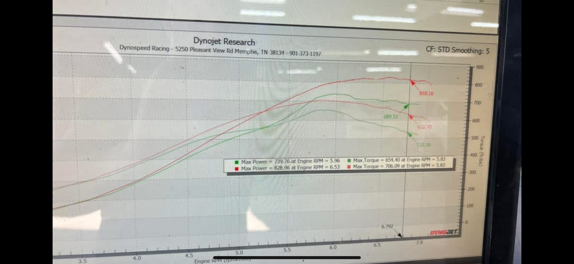

This is a before and after on a sbe ls3 going from 799’s to Brodix br7’s at 15psi.  Depending on your camshaft it probably won’t carry rpm the greatest but you can grown into some better heads.  I have some tfs245’s coming off a customers engine.
This is a before and after on a sbe ls3 going from 799’s to Brodix br7’s at 15psi. Depending on your camshaft it probably won’t carry rpm the greatest but you can grown into some better heads. I have some tfs245’s coming off a customers engine if that’s something you may be interested in.

That is kind of what I would have guessed I'd be giving up going from ported 243's to a $4000+ head. I've always kind of said I'm giving up about 100 rwhp with my stock heads on my current motor with my restrictive exhaust as well. RPM hasn't been a problem at all with the procharger and 232/248 cam, but I shift at 7200 rpm to keep everything safe with ls7 lifters.
