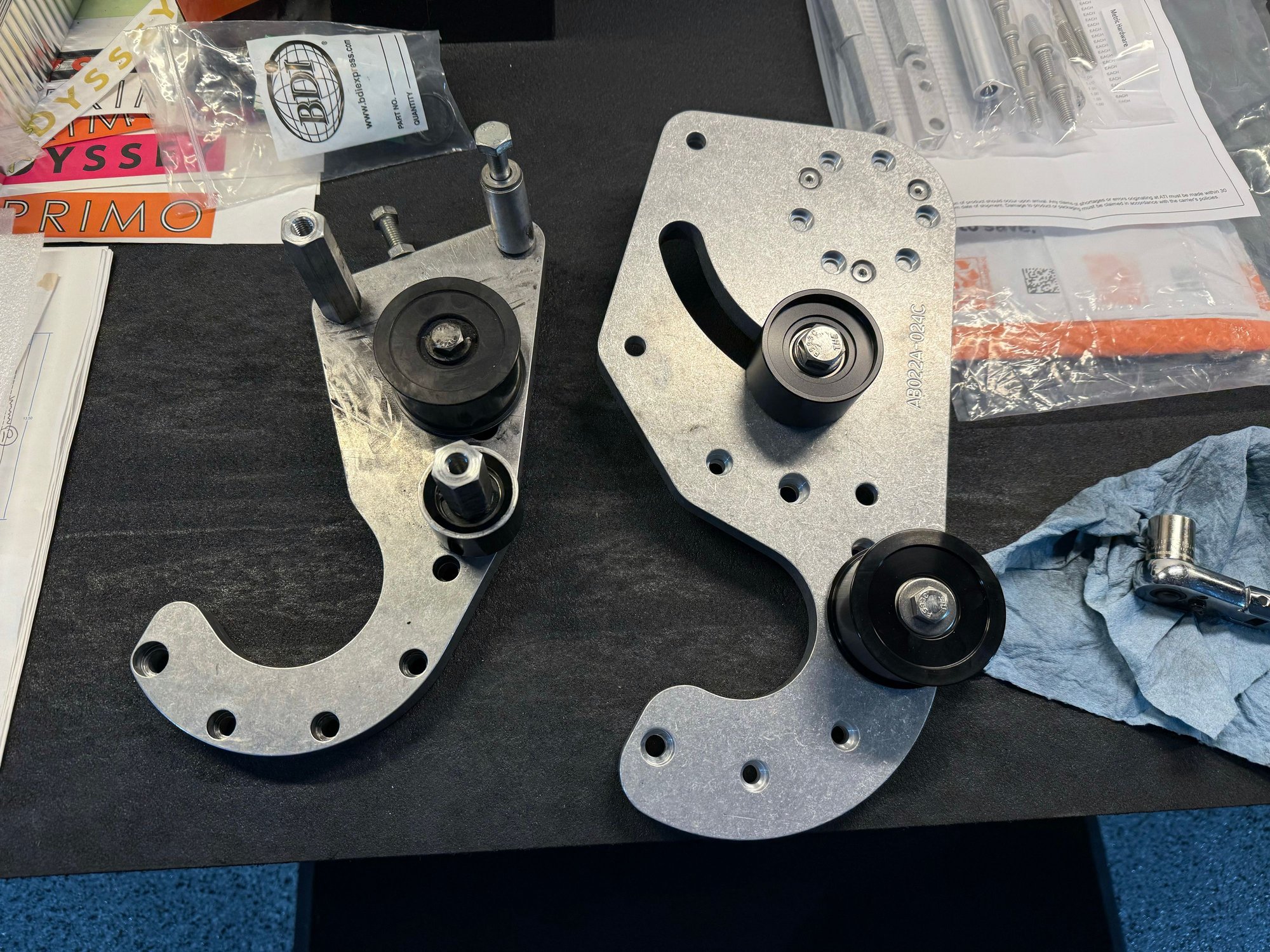

I actually recommend the D1x because some day you will want more. Spend the extra cash up front to get the upgrades. It will make everything much more enjoyable and issue free to buy the upgraded intercooler, bracket(depending on car), good balancer, larger diameter crank pulley, big red bov, etc.

I would contact Bob at Brutespeed for the best price and information.
They have a better bracket/tensioner for the fbody now. I would recommend the race kit with the large 1300 hp race intercooler, red blow off valve, 8 rib setup with the larger crank pulley, ati balancer, and d1x head unit. This will probably be close to 9g currently but Bob can give you the lowest price.
