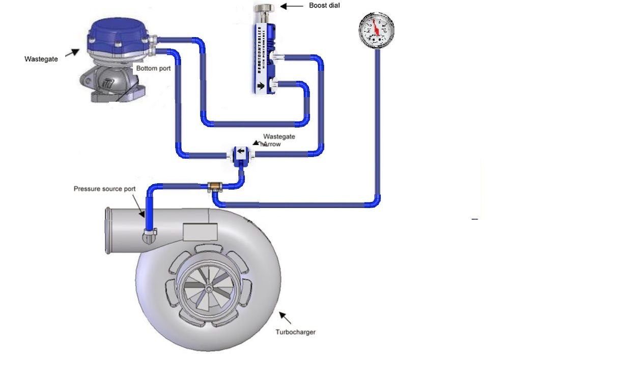

Was hoping someone could give some feedback on vacuum routing, does this seem correct: This is what I have plumbed up, haven't fired since installing turbo on 2001 Stock 5.3.
I read the sticky, didn't see a similar setup, new to turbos.

This is what you want to do. Ignore the "parallel twin setup"

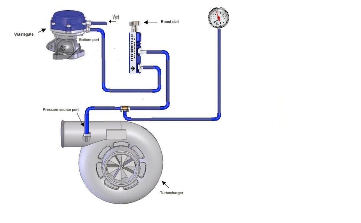

Default revised controller vacuum
So it should look something like this then

If you want to go manual control then yes

I would put the gauge on the intake manifold, so you're actually measuring what the engine is actually getting.
But yeah - that's how my boost tee is setup.

I always set up a boost control like the OP's first diagram, with the exception of using a manifold boost line instead of the compressor housing. Of course I also put the regulator on a switched valve to give gate boost or a higher boost depending on whether I switch to high boost or not. No reason to leave the top port on the gate open for bugs to get into.

Lots of different ways to set it up depending on teh range of boost you want and what springs are installed. If that manual controller doesn't have a spring loaded check ball you are leaving a bit of response on the table.
What boost range are you wanting and what springs are installed?
