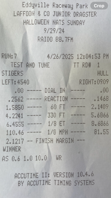

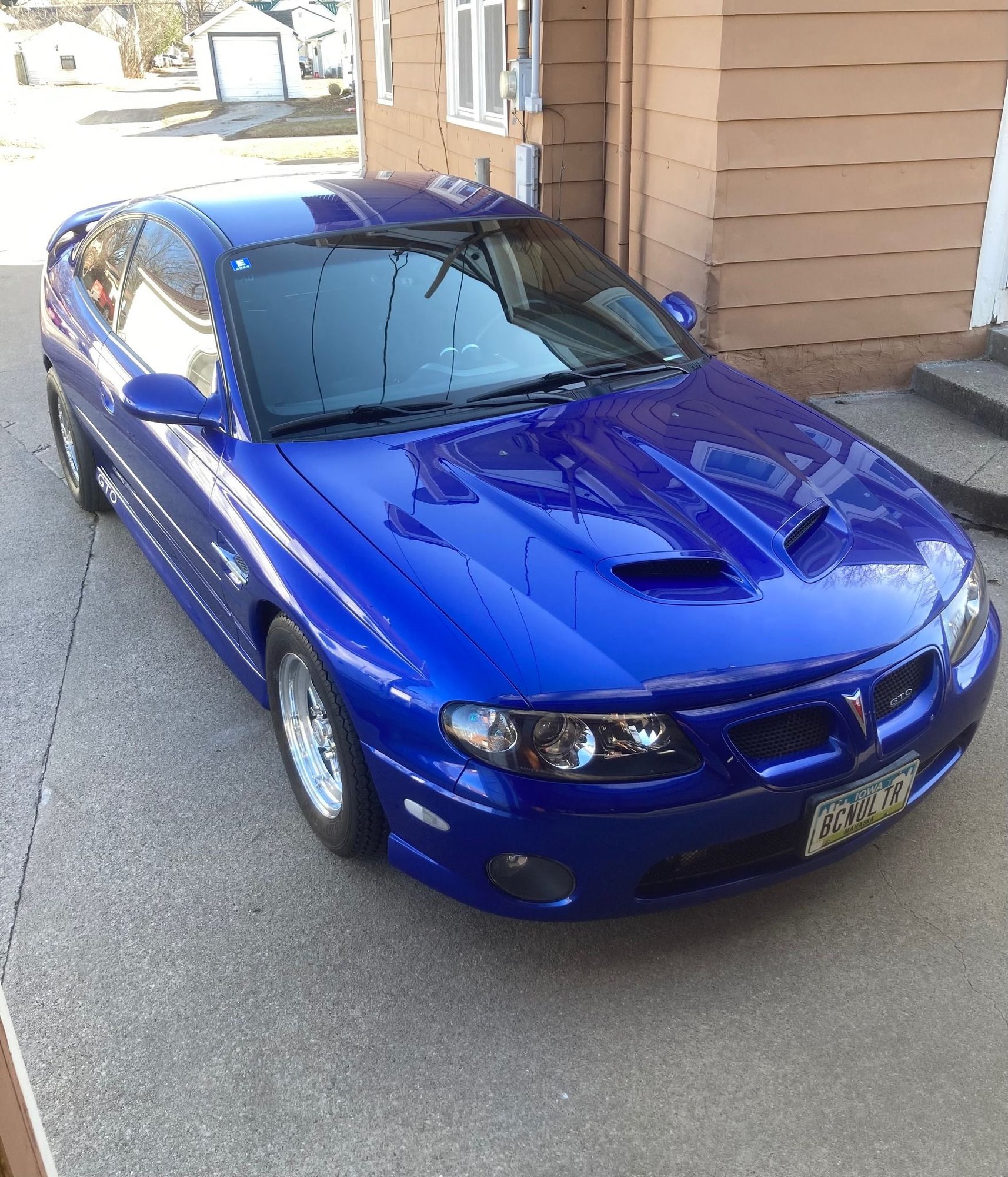

Opening day at the local small town drag strip first pass. Car is a 2004 Pontiac GTO with a race weight of just over 3900 lbs and independent rear suspension. Heavy car with IRS terrible combination for drag racing. Fuel is 50% ethanol and the meth is a pieced together setup I did using windshield washer fluid with 3 bottles of heet in it.
Sitting at the line staged idling like I would in traffic at a stop light. Jumped into it about half throttle and rolled into it from there. Clean pass for data essentially my first dyno pull after the changes.
Holy cow my mph was way down from prior which was last year. I had added a bit more boost which was tuned for with the previous 6 nozzle but hadn't made a pass at that boost level yet. That along with the larger meth nozzle I was expecting to trap higher not way lower.

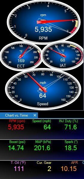

Screen shot from the run showing my AFR. 10.15 holy fat pig batman.

On my next pass The AFR was closer to 10.8 and I picked up 3 mph and trapped over 113 mph with no other changes to the tune. I made another change to take some more fuel out and also raised the 1-2 shift a bit. I was shifting to 2nd at 6850 rpm and 3rd at 7300 so I raised the 1-2 up to 7000 rpm.

Check out the IAT. It was a cool day about 67 degrees but even with the metal btr intake sitting in a lot of stop and go in the lanes for a very long time no ect or iat issues at all. Of course, this was driven to and from the track it's nearly being driven daily currently.

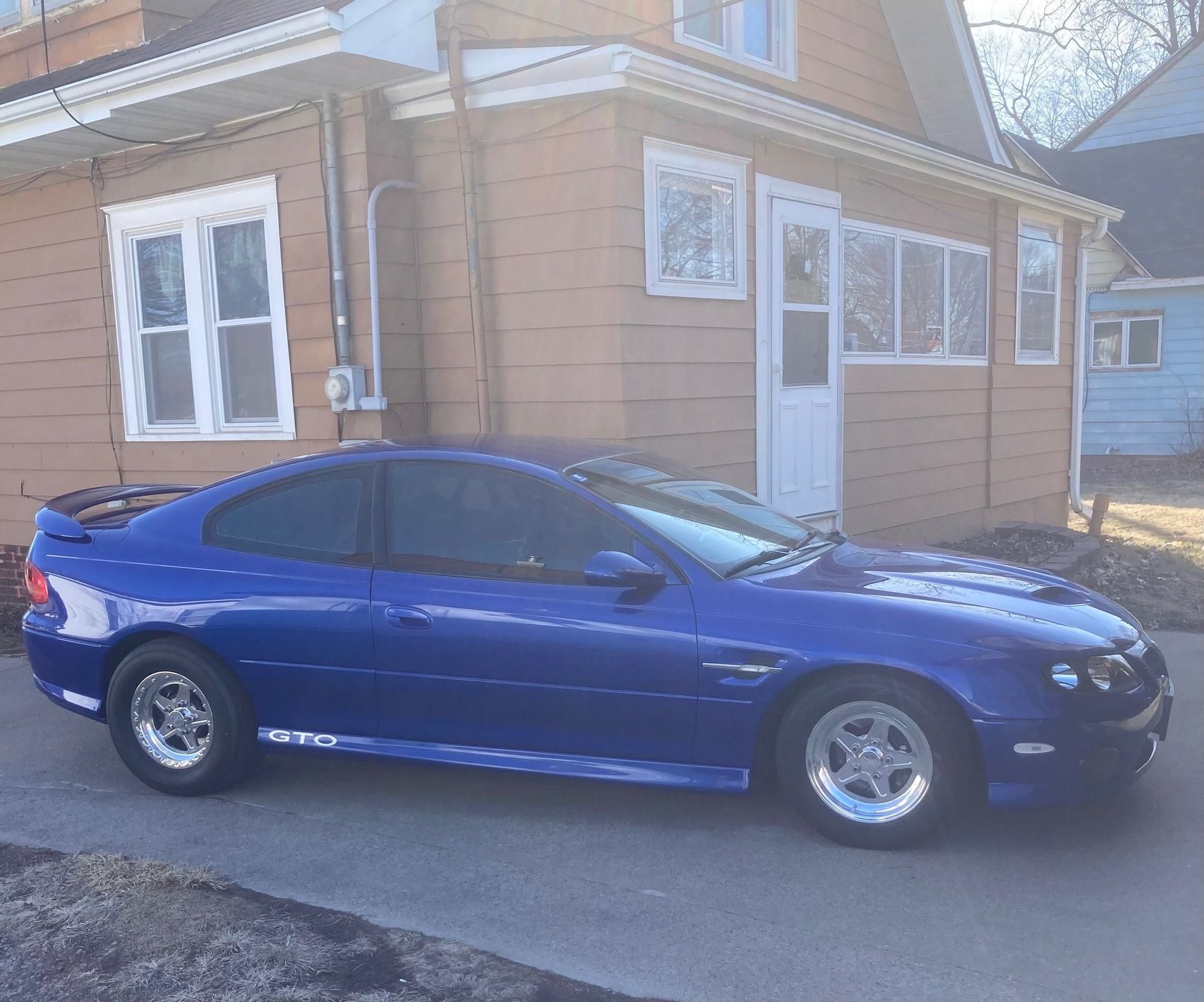

With the tune dialed and getting more aggressive on the launch 5.9x consistently is the goal. Stock ls3 block, stock ls1 heads, btr equalizer intake, ls7 lifters, ws6store rockers, cam motion custom cam, stock throttle body, forged rods/pistons. Long block has been together for over 5 years now. Ls9 gaskets with ARP head studs.

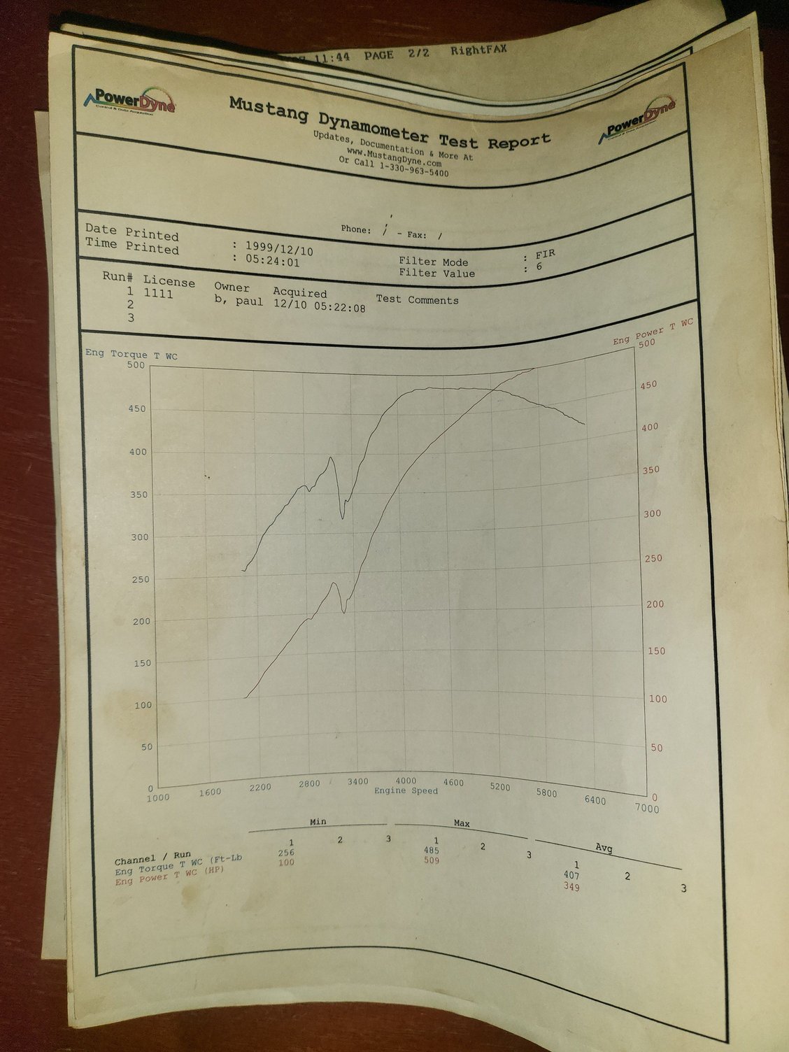

Your post reminds me of some old dyno tuning I was doing on the original rear mount kit on my 2004 GTO. Running 50/50 produced a VERY noticeable bog when the meth spray activated. I don't remember the nozzle size on that Devil's own kit, but I was spraying enough to bandaid a weak fuel system. I tried to find a sheet with 100% meth, but I only found ones from the 50/50 mix.
