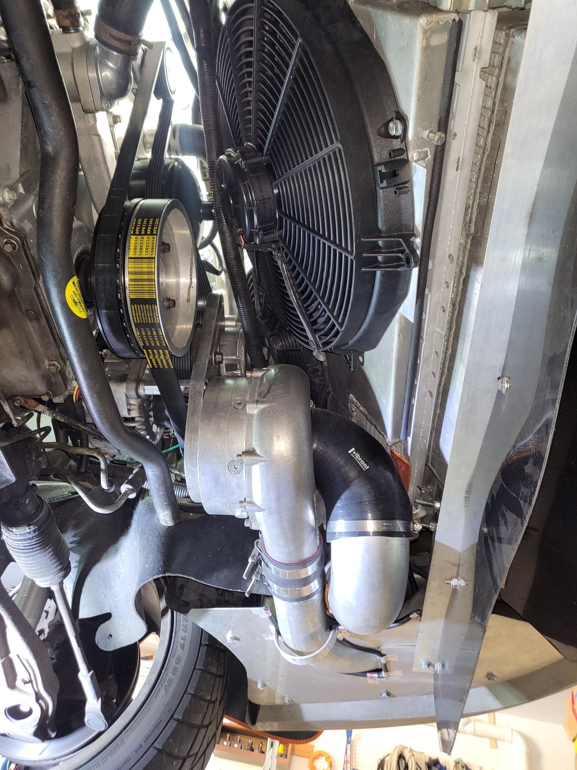

It is a fatter blower than the D1SC. Some have said they don't have issues with it fitting. I suspect that is with the old Procharger F-body inlet hat on the blower. At worst, I suspect you will have to notch stuff if you just want to get it to fit.
I run a custom shroud and I also removed the lower radiator support for clearance (for other issues as well). In my experience, the inlet into the supercharger becomes the restriction, so if you want to make materially more power with the D1-X you have to clear the inlet to let it breath. Once you clear the inlet and run something that isn't the Procharger F-Body hat 900+ RWHP doesn't seem to be an issue. With the factory procharger inlet I was power limited at ~700-ish HP. So, if you don't mind stuff rubbing or a little cutting, I think you'll be limited to ~700 WHP. If you are looking to max the D1x you will need to clear some stuff infront of the blower which means some notable cutting.
The below makes about 950-ish.

Procharger' LS F-Body E-fan Shroud | mmsolutions
Mightymouse shroud above.
That shroud is pretty similar to the one I built. I suspect that gains you a healthy amount of room in front of the blower so you can run the truck hat. Possibly an easy fix for other folks looking for some fitiment insurance when going to a D1-x.
