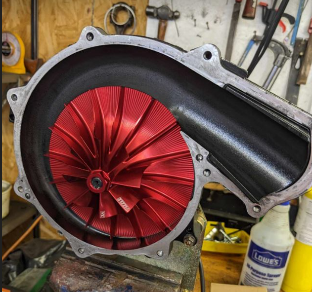

This is a pretty modified ski that has a much bigger blower and wheel running much higher RPM and boost than factory. It has a knock sensor, but no way of logging knock without spending $700 on the logging package.
My concern is this tune is for 93 octane which isn't available here in KS. I was thinking a the price of $4 per 16 gal fill up Boostane claims it would raise octane above 93. So what the heck... might as well try.
The 4gph of 100% meth injection I installed is probably enough to crutch any octane concerns, but it still scares me a bit. This thing makes 16lbs and will buzz to 9200 rpm. factory is 8100 and 8ish lbs. Does 75mph and gets there really quick.
