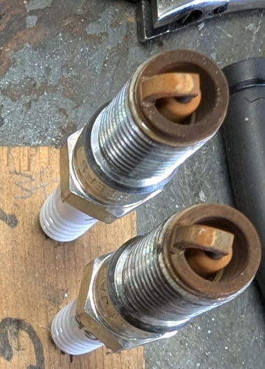

Good ol' Boostane, lol. Not sure what to think of these plugs. Different, that's for sure! Hope that crap doesn't clog up the injectors.
Old Aug 5, 2025 | 01:39 PM
  #55
Full Power's Avatar
Joined: Jul 2022
Posts: 1,046
Likes: 396
From: Alaska
"Hope that crap doesn't clog up the injectors."
. How could that nasty-*** gunk NOT clog up injectors ?
Old Aug 5, 2025 | 02:11 PM
  #56
Forcefed86's Avatar
Joined: May 2011
Posts: 8,488
Likes: 1,036
From: Wichita, KS
Its mentioned in their product description. The MMT they use to bump octane leaves metallic rusty looking residues. Supposed to be harmless.
