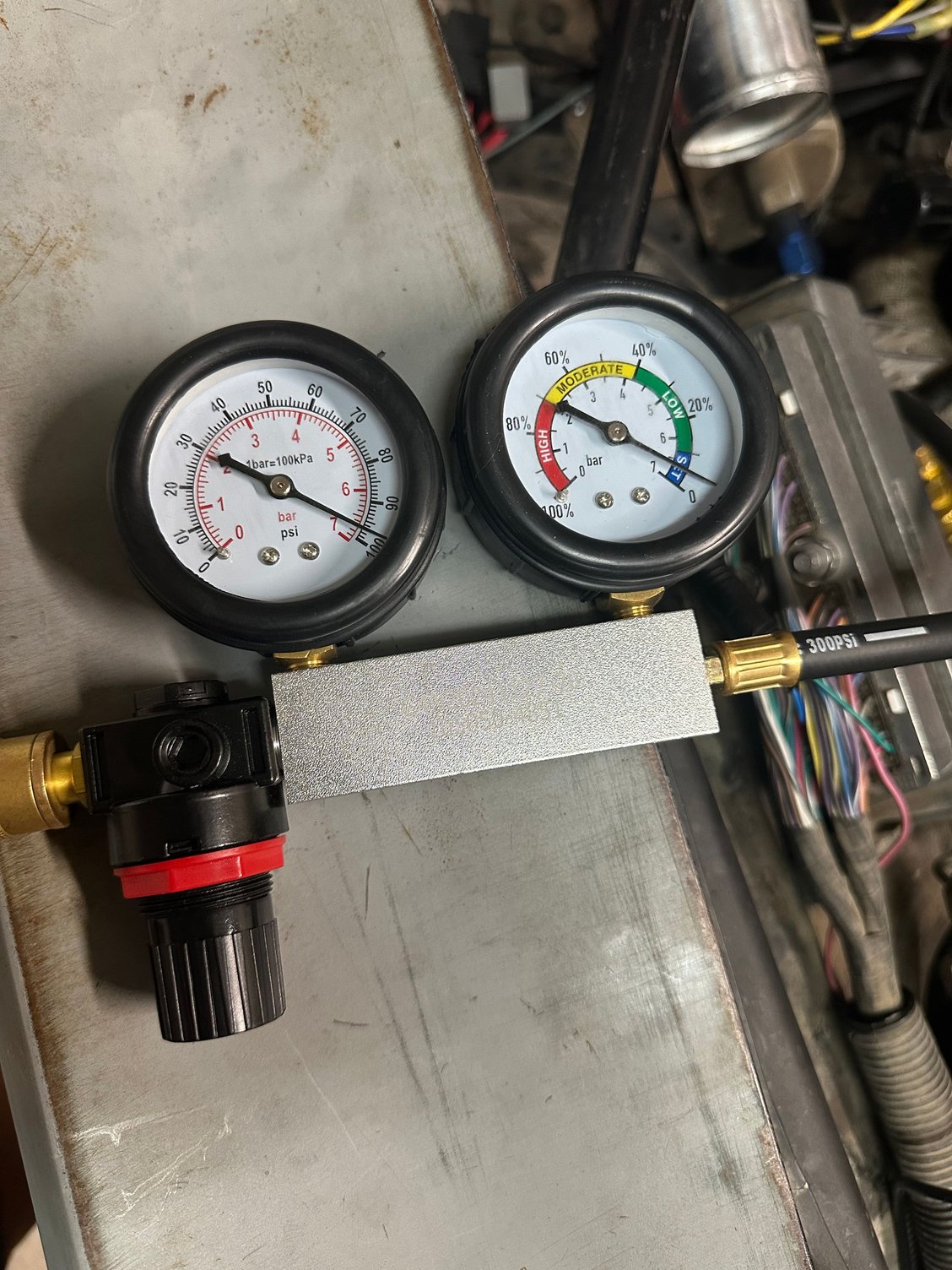

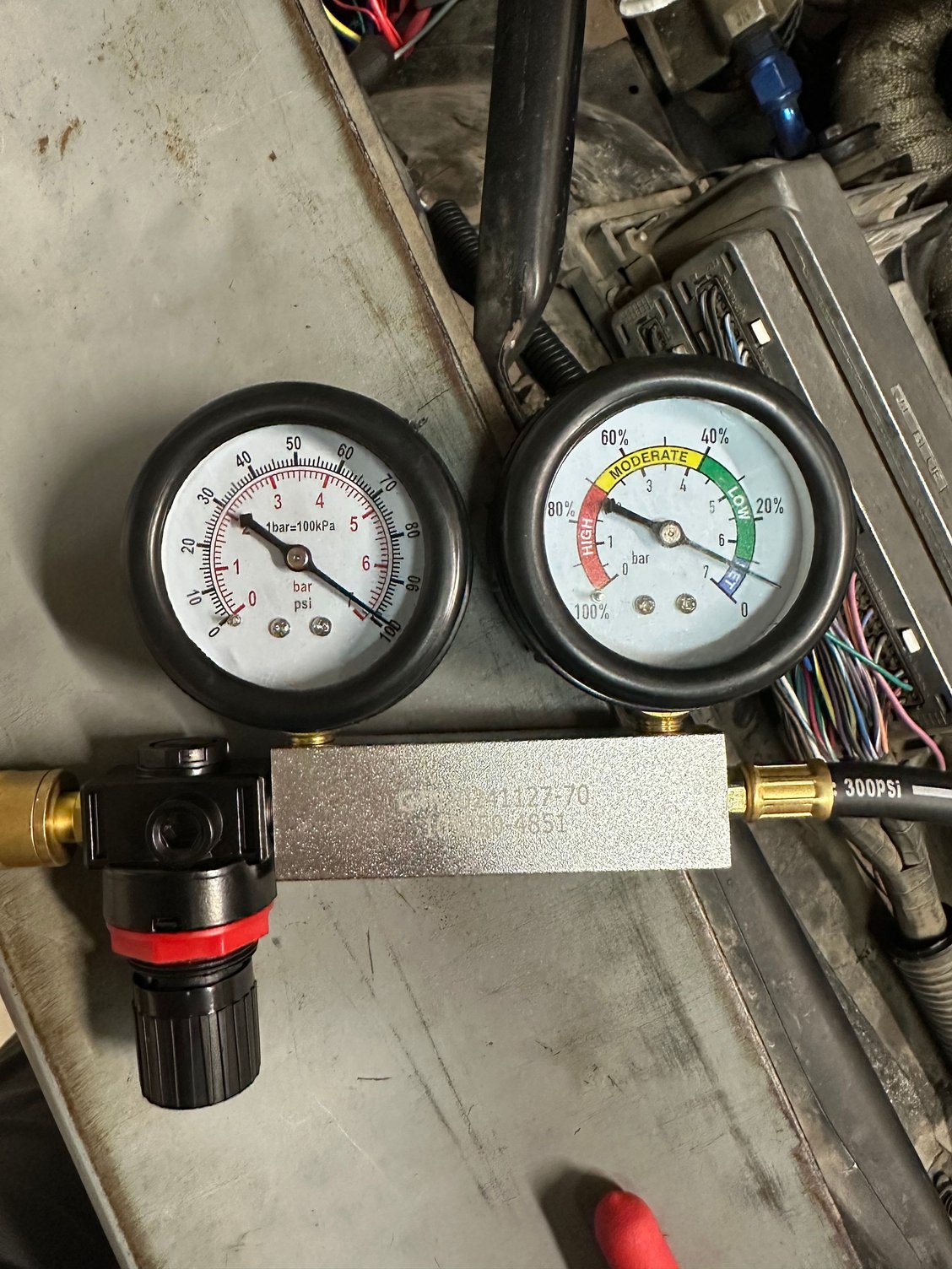

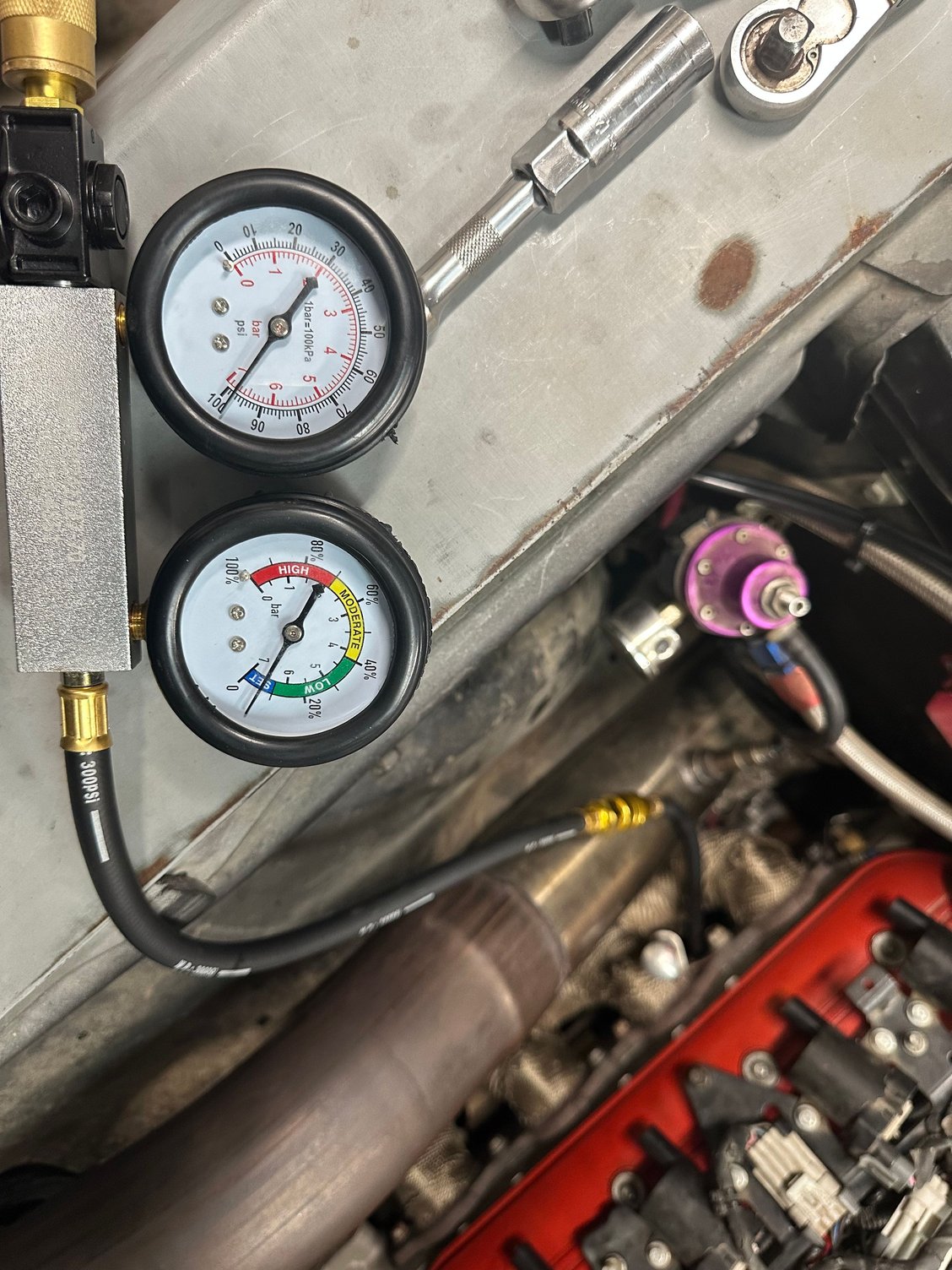

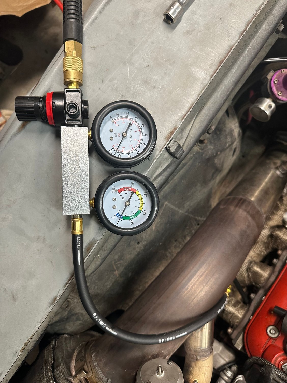

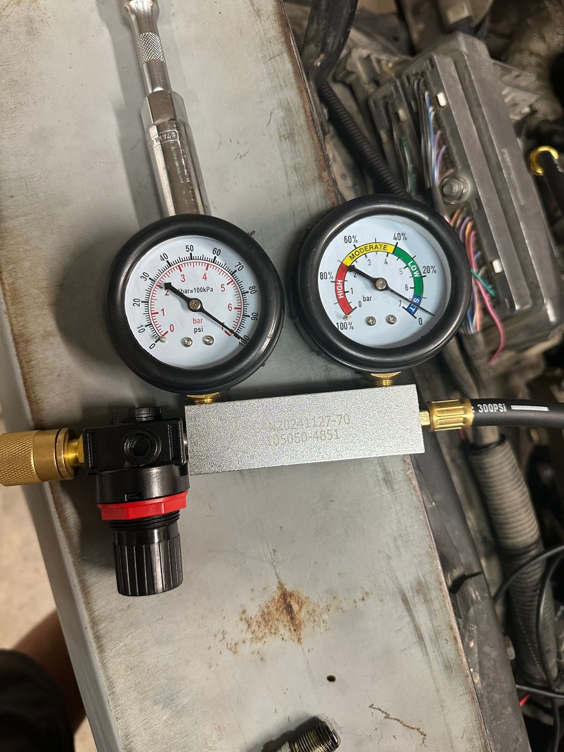

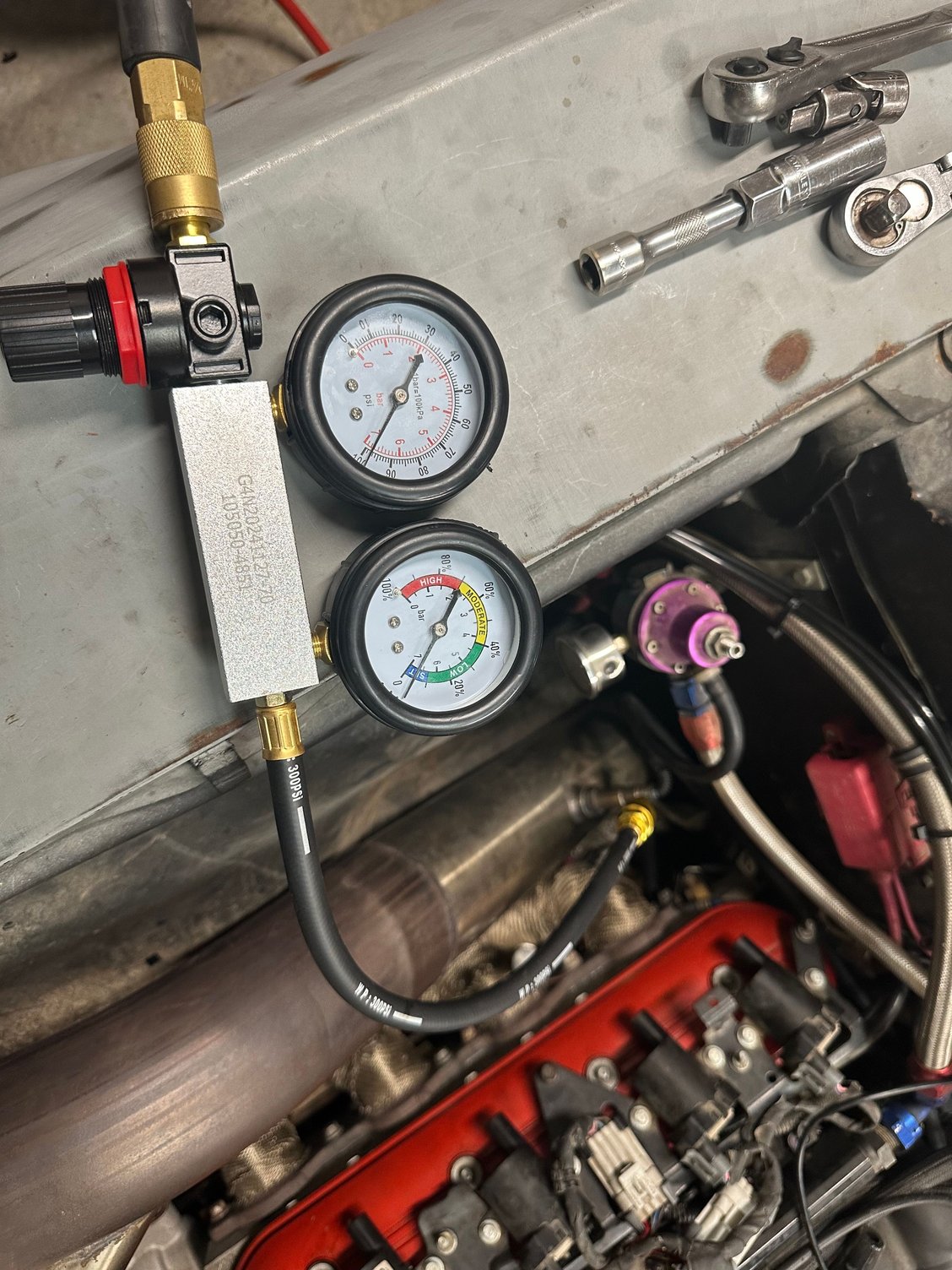

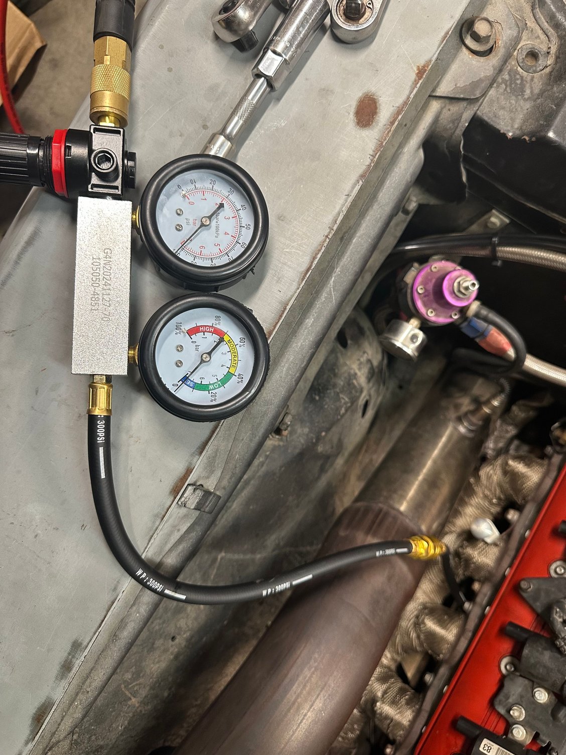

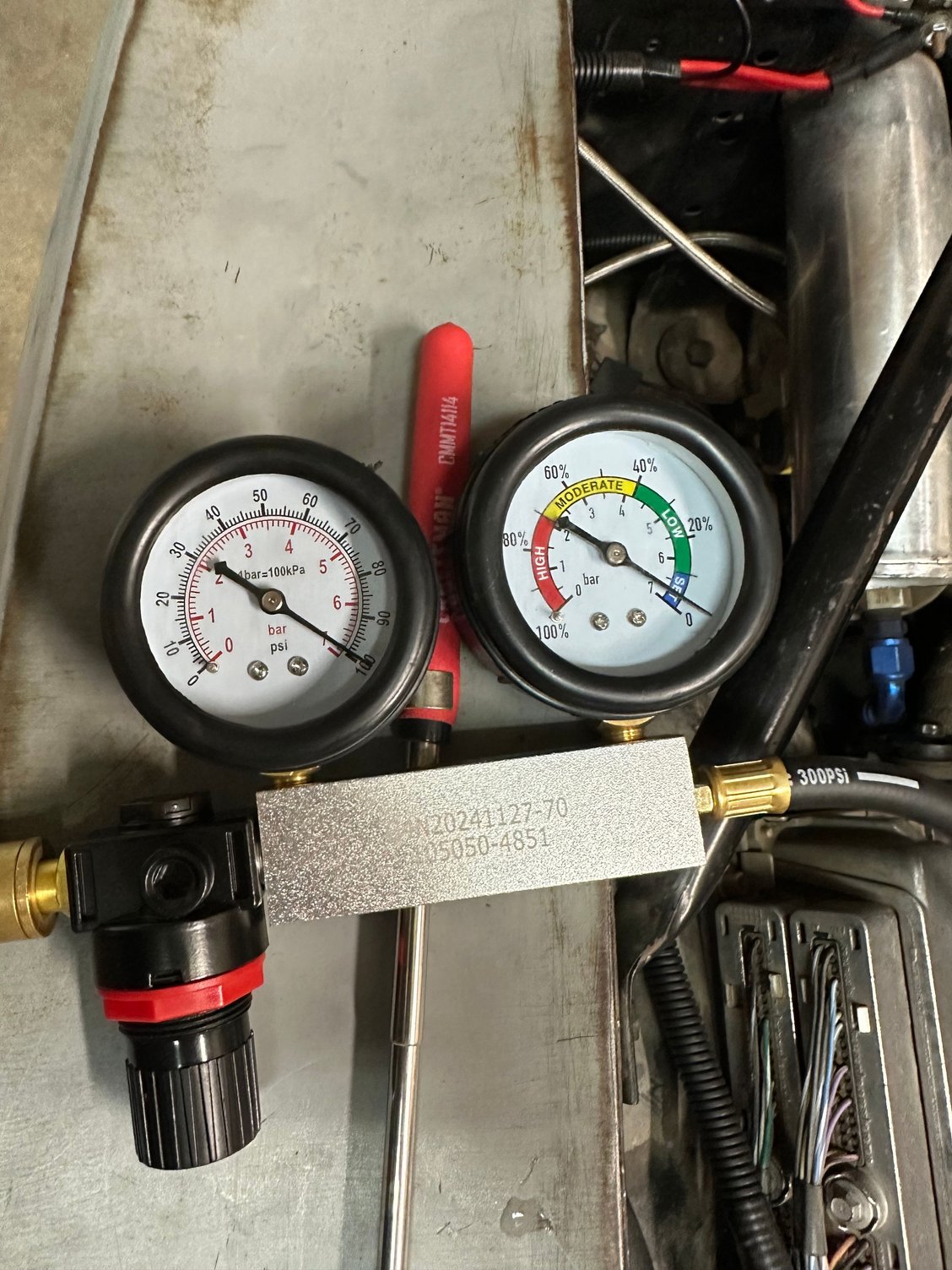

@forcd ind ran a leak down on all 8 today, despite it being 107. Everything looks solid to me.
Cylinder 1
Cylinder 1
Cylinder 3
Cylinder 3
Cylinder 5
Cylinder 5
Cylinder 7
Cylinder 7
Cylinder 2
Cylinder 2
Cylinder 4
Cylinder 4
Cylinder 6
Cylinder 6
Cylinder 8
Cylinder 8
