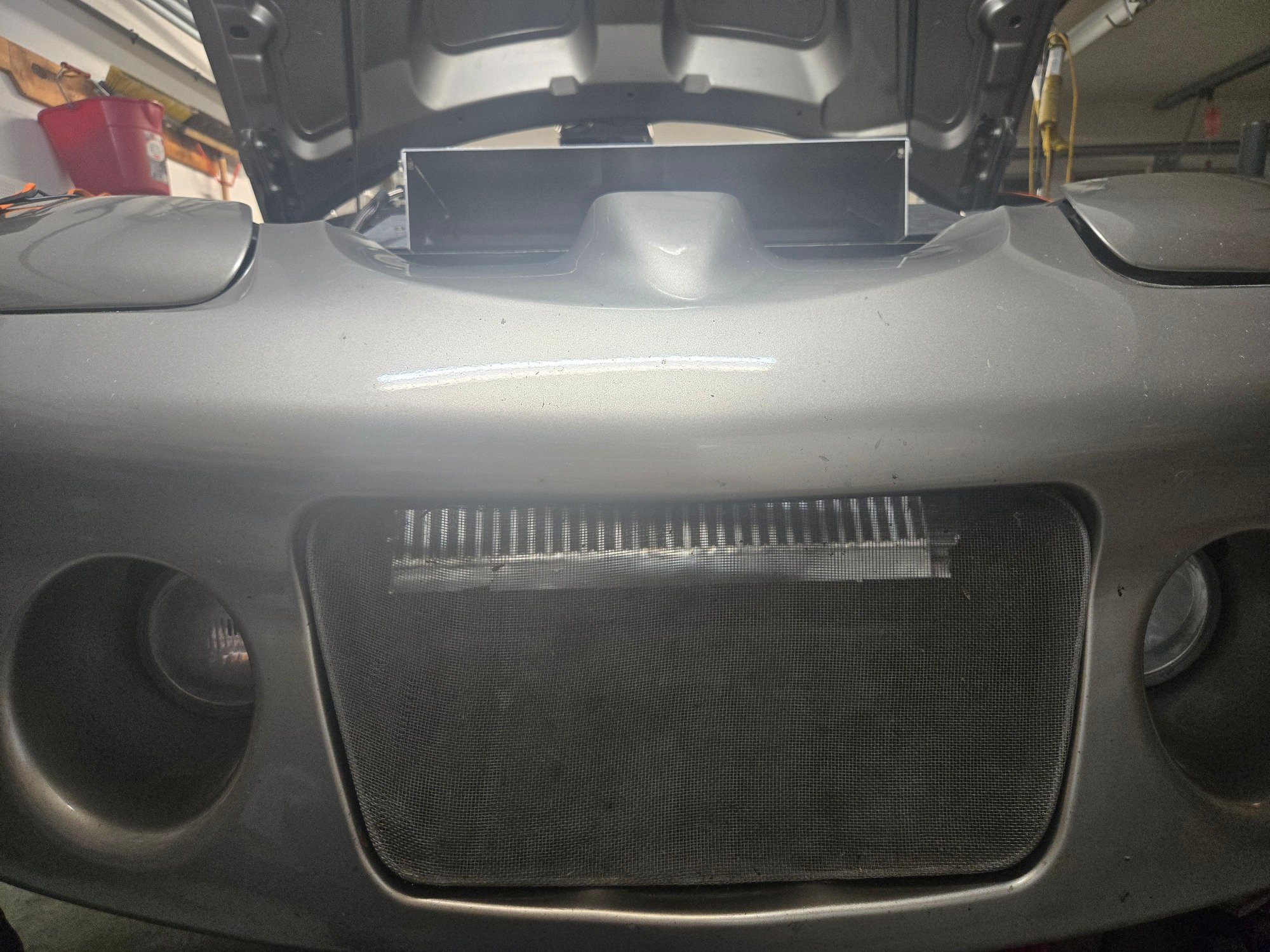

My Formula's front bumper completely encases my intercooler, which obviously isn't good for charge temps. I cut out the space behind my license plate cover, but I usually leave it on when cruising around so my intercooler doesn't get filled with bugs. I'd like to open up the area under my bumper somehow so air can flow upwards into the intercooler, but I'm not sure what would work best. I thought of just cutting some large round holes, but I don't think much air would flow into them. I don't want to ruin the structural integrity of the bumper, so if there was a way to insert a small scoop of some sort and rivet it to the bumper so it keeps it somewhat rigid, that would be ideal. I do NOT want to cut anywhere on the front of the bumper besides what I already did behind the license plate cover. If anyone has ever done anything to improve the air flow, I'd love to hear about it.

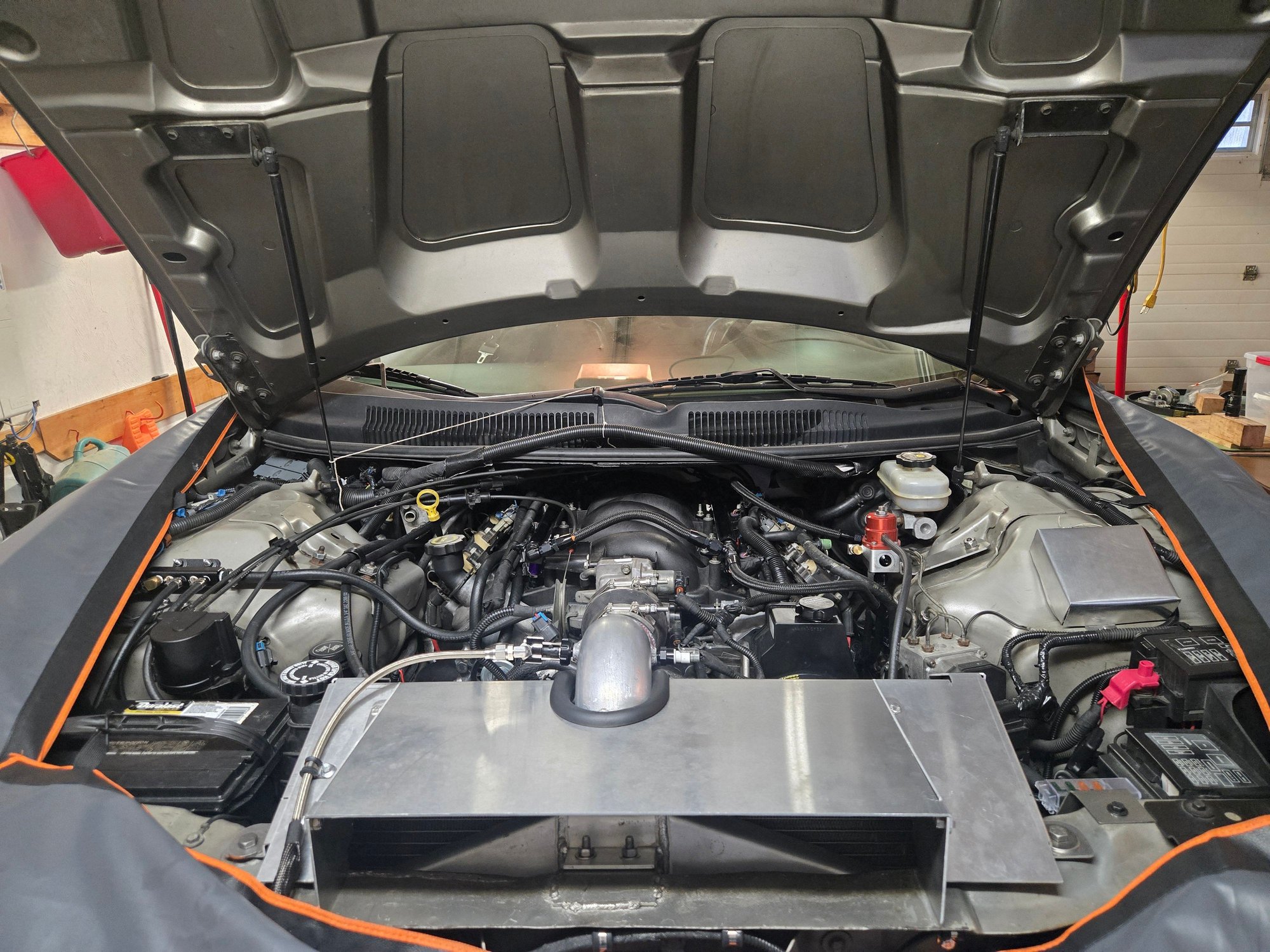

I did a few things to help get air to the intercooler.
1) Radiator shroud that routes air from the ram air down to the intercooler and radiator.
2) Opened up the front plate area and put on a fine mesh screen for bugs.
3) I run an air damn along the base of the intercooler to created a low pressure area after the intercooler - this actually made a measurable difference on high end IAT. I did it for the radiator flow at highway speed and was pleasantly surprised on what it did to freeway WOT runs.

I remember cutting my front bumper back in 2003. I eventially came up with a screen.

Mine is like that, you can kind of see it in my avatar pic. I just made it so I can reinstall my cover for a stealth look. It definitely helps. Back to back, it drops intake temps by 10 degrees when I have the cover off.

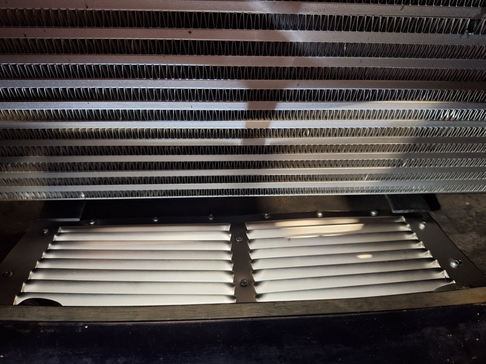

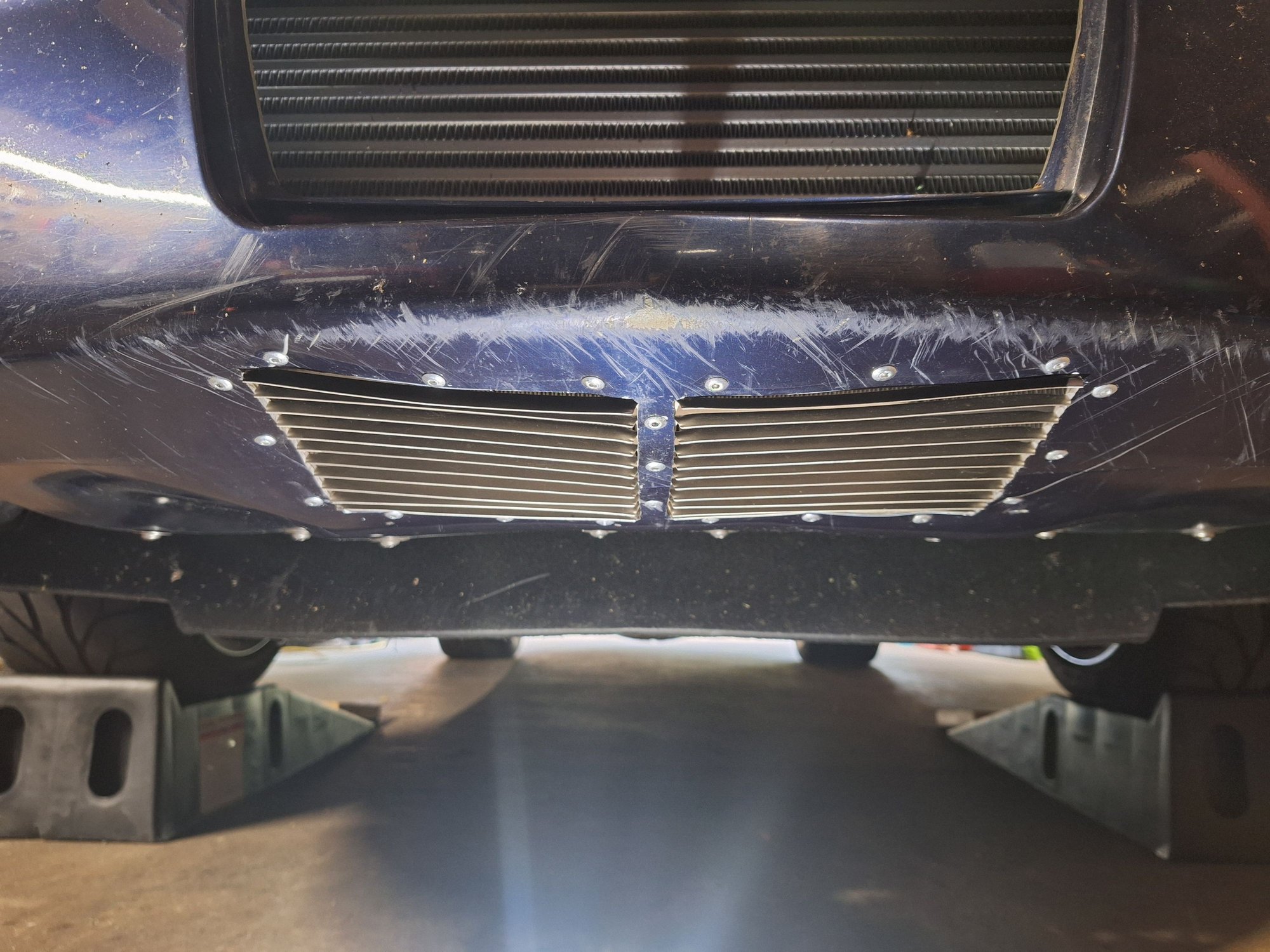

I finally did something to add some airflow in a sloppy way. Chopped up and riveted a cold air return to the bottom of my bumper. It's not very noticeable, and I haven't even painted it. My bumper is terribly beat up and needs to get painted anyway, so I figured I'd do this before that gets done. Not sure how well it works, but it's gotta be better than nothing.

You need a mini lip like the air dam on the back of that hole you got there to try and deflect the air up into the intercooler. The way it is now isn't gonna get you much of anything at all
Yeah, you're probably right on that one. It has made a small difference, however. I'd like to make it more efficient, so I may get a piece of aluminum under there to make a lip.
