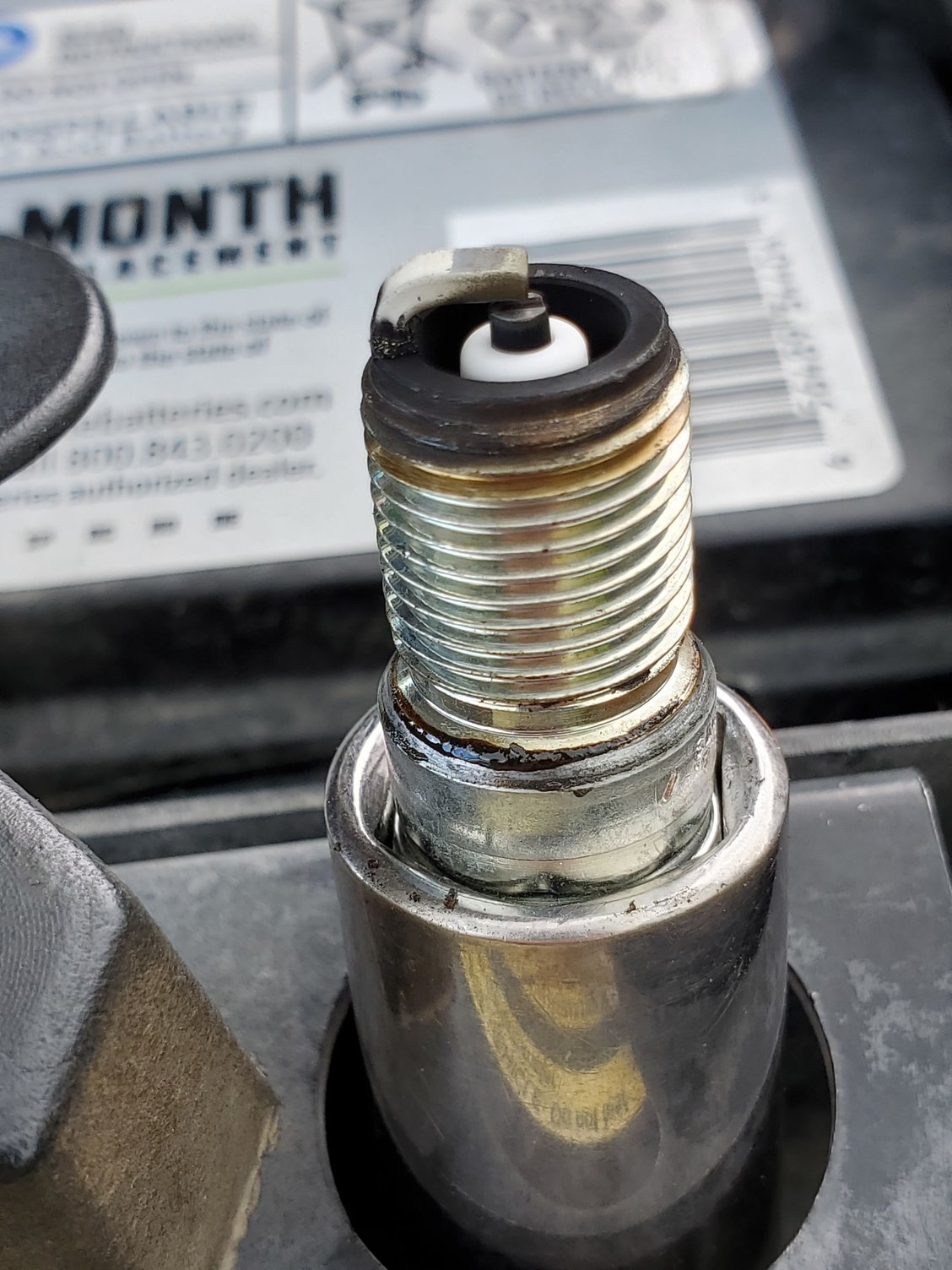

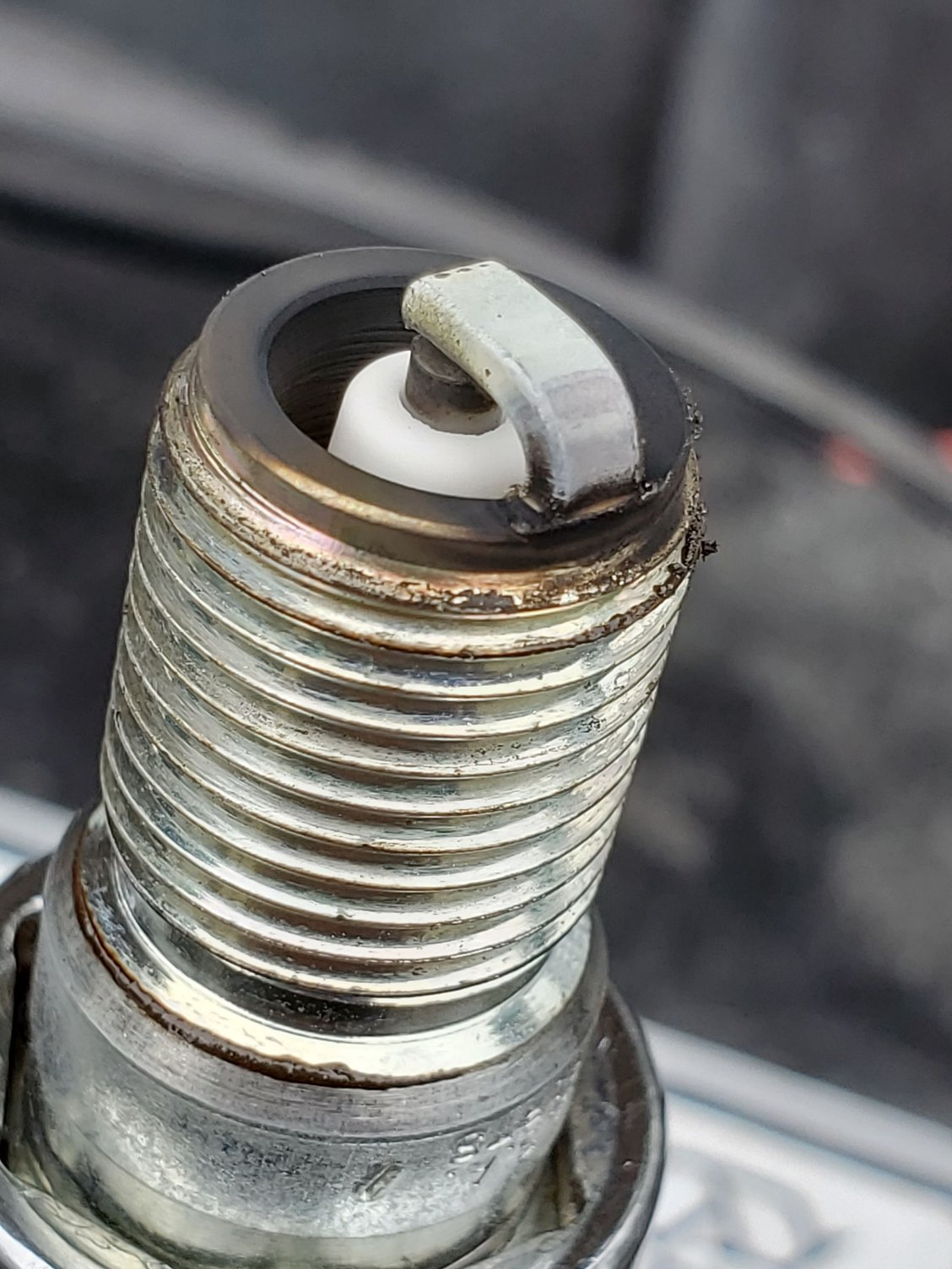

Just put in BR7ef with .028"
8 degrees spark advance at 170 kPa 4400 rpm
How's my timing mark look ?

Gas or E85?
What's the AFR set to?
How's is it tracking vs commanded?
Snow white porcelain...
Cut the threads off and look at the fuel ring at the base of the porcelain.
Minimize the anti-seize

Thanks Buzzard: I am burning best available Unleaded 90octane
Observed AFR 11.5... Commanded about 11.9. PE is not as accurately responsive as I'd like.
Just started WMI system, adding a trickle of 70% methanol through a 6gph nozzle..
.Hopefully: a bunch of experienced old-school tuners will show up here, and we'll have an old fashioned "Here's how we did it back in the old days:" Spark-Plug reading expertise thread.
edit: The anti-sieze is remnant from long ago, previous owner was " Marine Mechanic " everything around saltwater got antisiezed.

What motor? Compression? Intercooled? Charge temps?
So like 9lbs of boost and 13* total timing? You aren't even burning the CAD plating off the plug yet. Its super cold. If you are on 70% methanol you can likely run around 25* or more to 4-5lb range. Then taper off to 13* by 20lbs and interpolate between the two for a nice even curve. I drop 1-2* around PK tq on the whole map. Then get a plug read, bump up a degree at a time from there until the plug reads about 1/4 to 1/2 way down strap and cleanly burns off the cad. Can also watch the threads. Shouldn't see heat getting into the 2nd thread ever.

I misread your post. My fault. I'd leave it as is. I was under the impression you were on 70% methanol and 30% pump gas. Either way those plugs are very cold. (and clean porcelain for pump fuel).
Kinda wonder if its false knock you are seeing. Have anything hard mounted? Engine trans etc? Stock ECU? Either way that's a cold reading plug.
