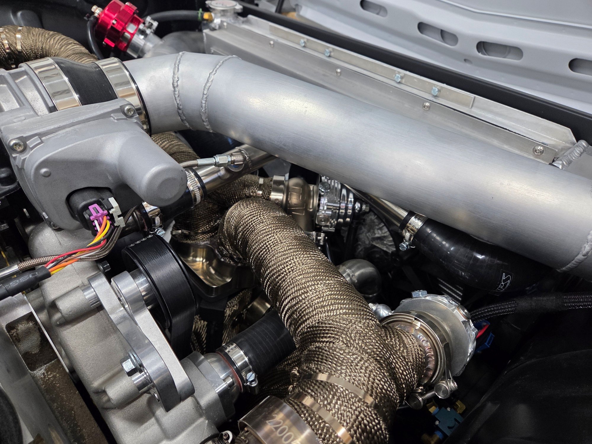

I just finished a turbo build. I wrapped my hot side and downpipe with DEI titanium wrap and the turbo has a blanket on it. Like most turbo builds, stuff is crammed together closely. I am wondering how hot is too hot for certain areas.
I currently don't have any blanket under my hood, just the painted metal. After just casual driving, no real boost, I pulled into my garage, popped the hood and measured temps with an IR gun. I measured the hood at 175*F. My rubber hose running to my catch can was about 200F, and my silicone couplings that attach my SS radiator pipes were about 300F. My aluminum intake pipe was about 150F. I also measured my manifolds and they were 600F even with the wrap and once again, no real boost. Does that seem right?
How hot is too hot for these components? Does my wrap job look OK?

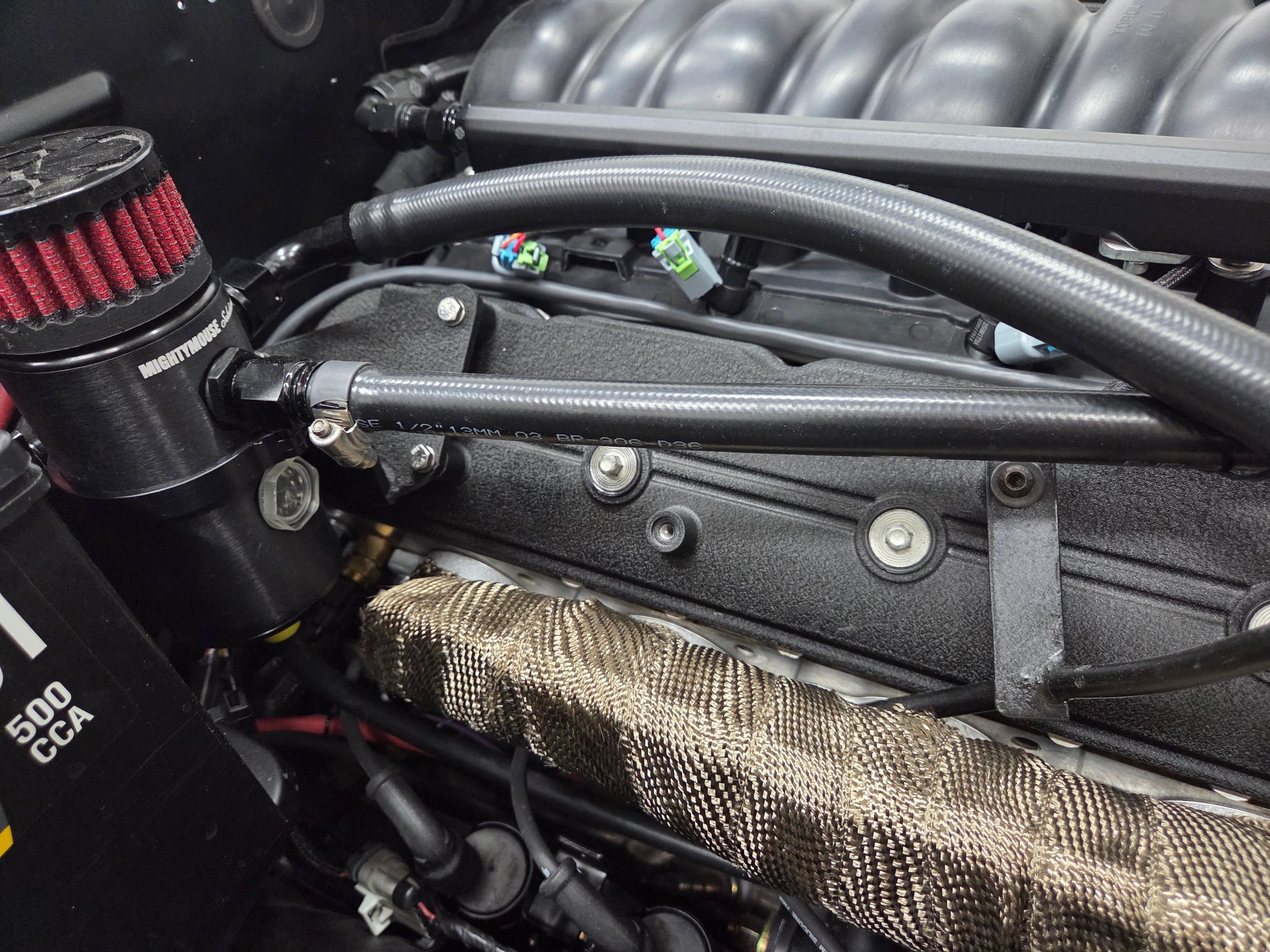

For the rubber hoses, I was looking at some DEI sleeves. But I'm not sure it even needs any protection.

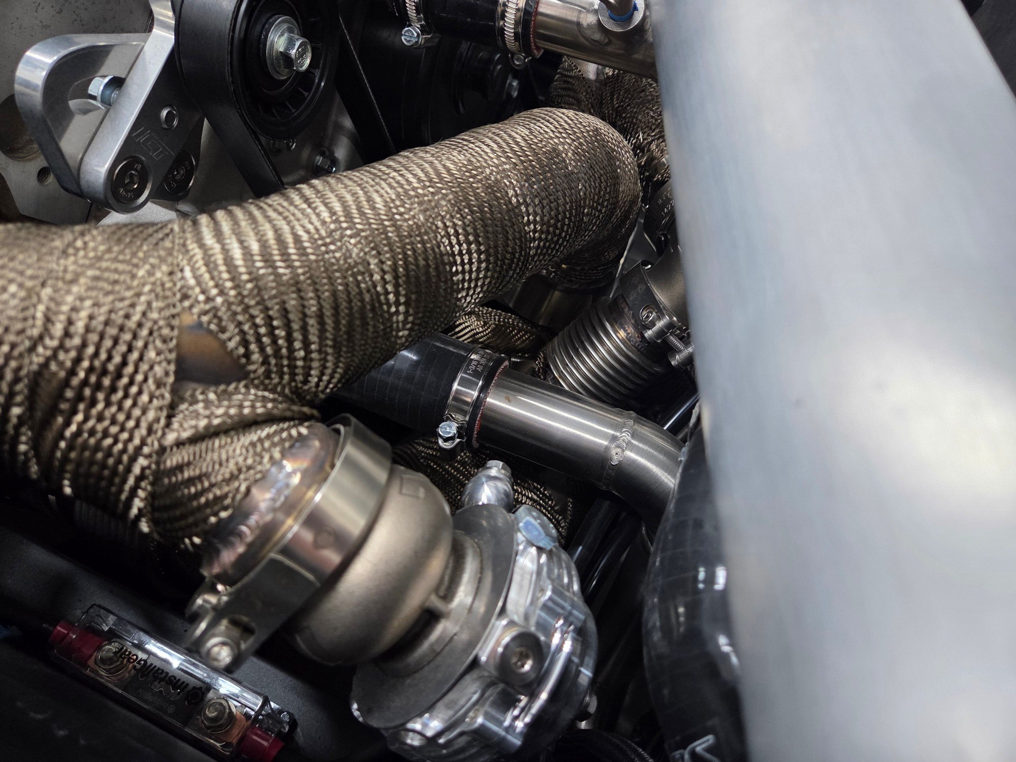

For the post-intercooler intake pipe, I was thinking I could wrap with the same DEI titanium wrap, but once again, maybe it's not needed.

First off, kudos on the incredibly clean build my friend.
Regarding heat mitigation, I don't personally believe you can go too far with it.
@Project GatTagO used that dimpled heat shielding on his hotside but I believe he had to send it out, but man does it look great.
You could always ceramic coat and double wrap the hotside as well.
I'd also explore means of getting the heat out of the engine bay too.
My 4th gen Camaro hood would completely seal the engine bay, which meant all the heat stayed in there too, I ditched the hood mostly because I wanted to but it did make a massive difference in running temps.
Not saying you should ditch your hood but perhaps add some vents to give the heat a way out.
Visually inspect your rubber components regularly, if they start getting hard then they're getting too hot.
I don't see anything glaring but any fuel or wiring running near the hotside would get heat shielding if it were me especially if the car sees extended driving time.
​​As ​@91 Z28 mentioned, getting the tune right will also help running temps.
I wouldn't worry about the intake pipe, the air is moving so fast through it, I seriously doubt its making a difference.
If the car is running cool in the 180-190 range, then you're fine.
Mine runs in the 175-185 range but mostly around 175-180 which might be a bit cool but oh well.

Thanks everyone and thanks ****** for the compliment. The car is tuned initially and runs fairly well so far. The hood does have 2 large-ish vents already. I'll take a look at the timing. Does the 600F reading seem high?

600F seems a little on the hot side of things.
Does it though?
Typical exhaust gas temp is what, 1,200ish degrees plus or minus a few hundred degrees.
The wrap cuts it down by 50%, 600F seems on the high side but it is a turbo setup, so I'd assume more heat, I don't think I'd worry.
If the OP is really bothered by it, then ceramic coat everything and double wrap it.
Still think the heat needs a way out of the bay though.
