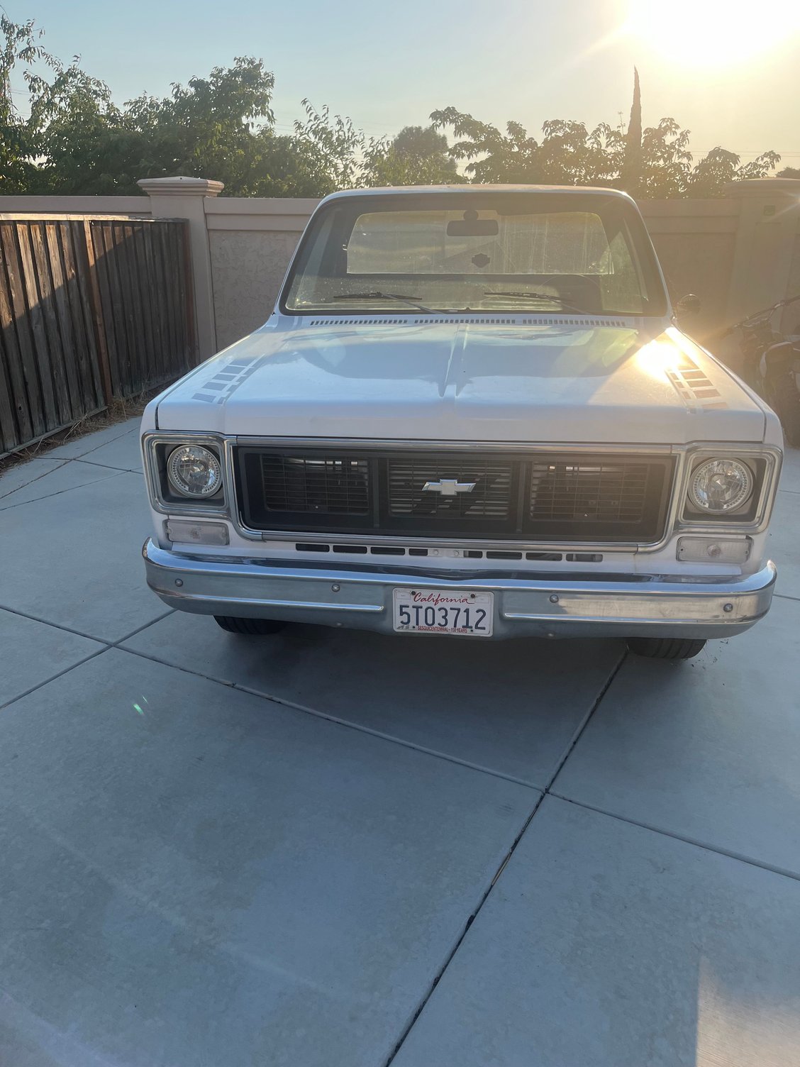

eBay intercoolers are definitely a you get what you pay for. I'm not even sure what happened to mine but it swelled out the bottom. I got a good deal on a mishi 4" intercooler
