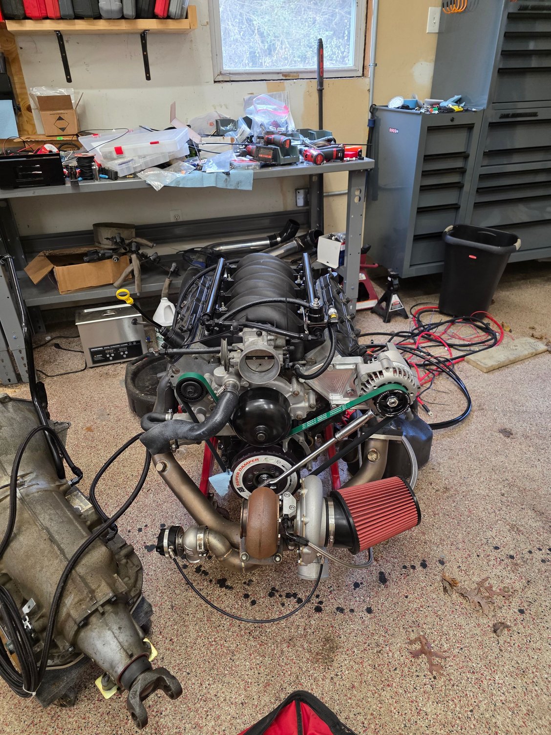

I just picked up a 1973 Nova to swap my 5.3l and 4l80e into. The engine has the BTR / LJMS Stage 2 cam and supporting valve train. Rings gapped for boost. It was in my 4th Gen with HSP V1 Turbo kit.
My goals for the car are 500-600whp on pump gas.
I am looking to put my Precision 7675 CEA on it. Has anyone found a hot side that works with minimal effort? Hooker?
What about swap mounts? I was thinking about the Hooker / Holley mounts.

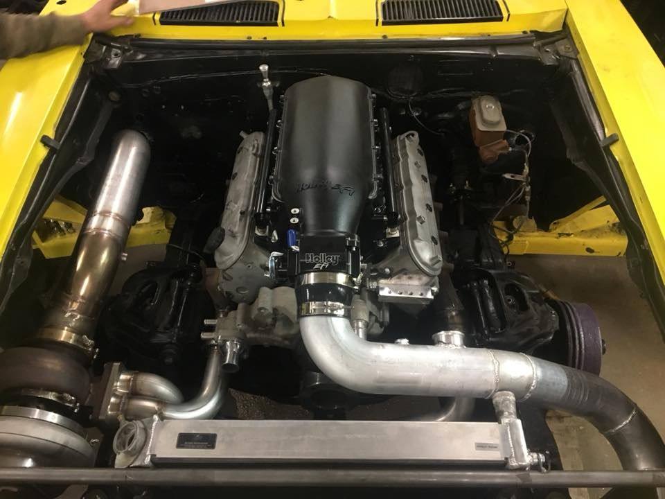

I'm running Dirty Dingo mounts, slid my engine back an inch. (1967 Camaro).

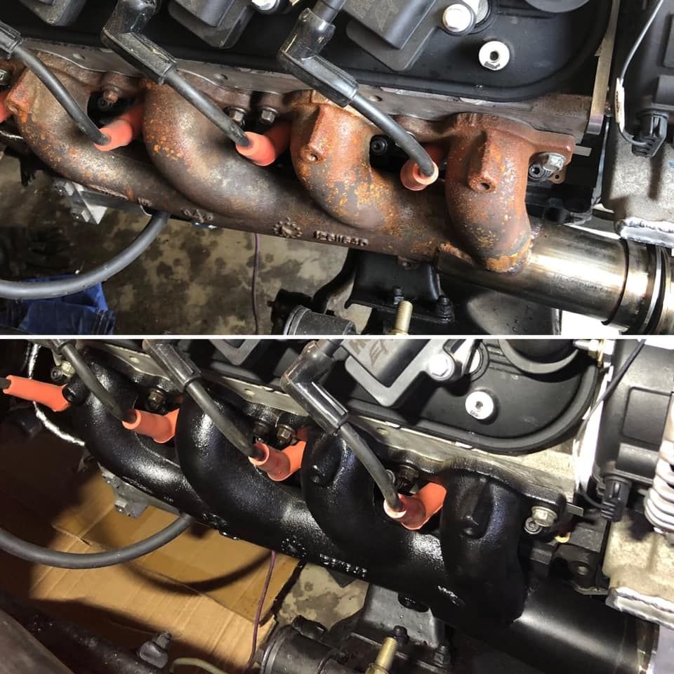

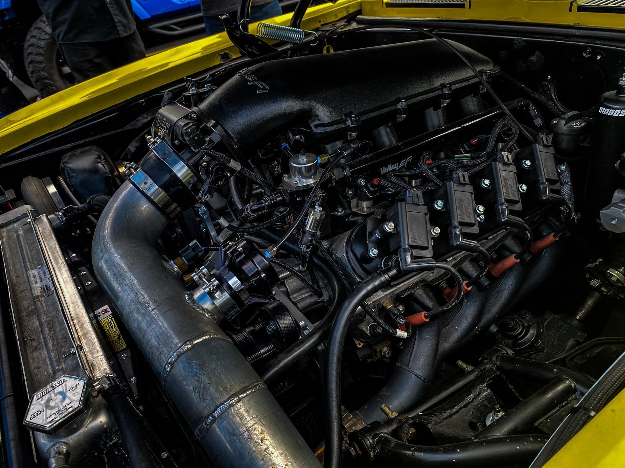

My buddy built my hot side with truck manifolds that are v banded.

I don't think there's a shot at my 4th Gen HSP fitting in there with how little room there is between the 307 and radiator now.

We could run a setup like that on a 4th gen but I think it won't fit in a 67-74 Nova/Camaro. I'm running truck spacing for accessories so F-Body spacing would tuck in a bit more but even with my engine set back an inch you can see it gets tight, and I have a Rhodes core support too.
My crossover is nothing crazy.

Vbanded truck manifolds and 2.25 SS tube much like Johns photo above with the exception of the small pipe using 1000 pie cuts or should say death by 1000 cuts. Never again.

My Nova manifolds look just like John’s.
I used Corvette spacing on the accessory drive. But used the Holley PS/ALT bracket.
Novas are pretty flat in the front.
