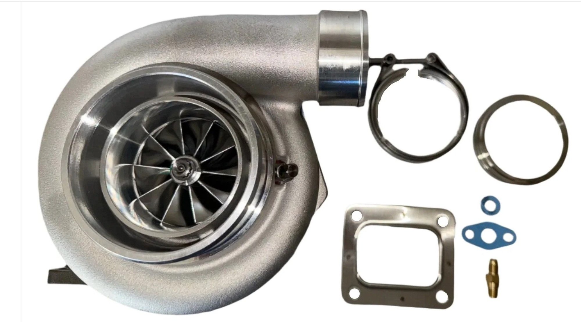

This guy would get my vote with the smaller 1.15AR for faster spooling with the six speed.
Should comfortably make 1000hp on pump gas no problem which would come out to about 850hp at the tire.
Trust me, 850whp with a six speed is gonna be a serious handful.
PSR 480DG DUAL BALL BEARING TURBO BILLET COMPRESSOR WHEEL - Pulsar Turbo Systems
