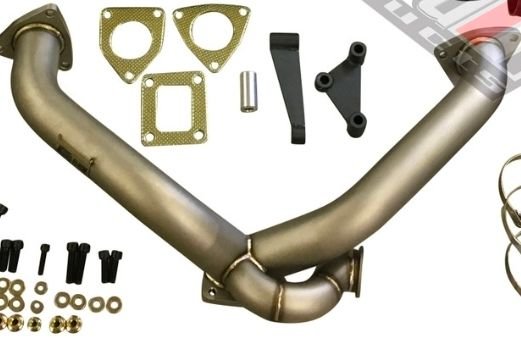

I got boost creep pretty bad a few years back. I finally capped off the poorly placed single 44mm gate piping and added another.
Put them both in a straight on "priority" spot on each side and haven't had a boost creep issue since.
As you can see, one had to be almost looped, to clear the IC pipe.

Unfortunately, I dont have any room to mount a wastegate on the passenger side of the pipe due to how my dump pipe and exhaust pipe are routed, and I can't afford to completely redo the exhaust. I'm just going to add a wastegate on the driver's side in a priority position , as the guy who was selling his turbo kit told me it worked great for him.
I will say, I never had a boost creep issue, it was more the boost was coming in so hard in the midrange that it would overshoot before settling into what I figured was normal. Now that I've torn my engine out, I've found a couple of problems I need to address, mainly the leak around the MAP sensor I found (that's already fixed) and the minor exhaust leaks I found on a few of the ports, which is due to the manifolds being rusted and pitted. I need to surface them somehow.

I suspect you are right. Here is what the bend coming out of the crossover looks like. It really does not seem like it could work that well.
I'm super late to this party but do you have the room to just cut off the wastegate tube in the pic and add a couple short pieces of pipe and flanges on the straight legs close to the turbo flange?? Or is it too tight??

There's so much going on on the passenger side, I have no room over there. I know just leaving the original wastegate location isn't ideal, but I can't afford to redo everything. It'll have to suffice for now.
