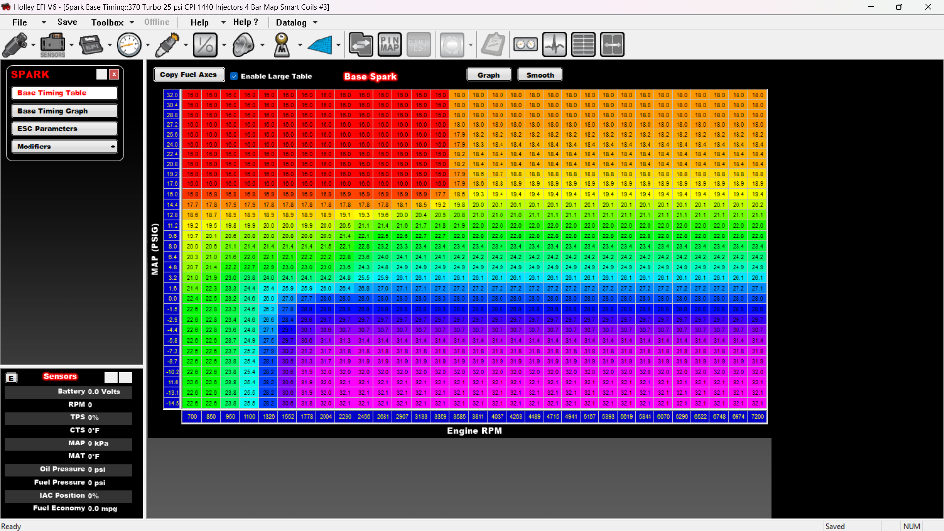

What's the more knowledgeable people think about this timing table in boost? I'm on e85 and I'll give a complete rundown of my set up below. I'm not new to boosted LS's but I am new to "leaning" on timing, although this still isn't as aggressive as others. I know every engine is different on what it likes, this is just a starting point. I'll take data logs and read plugs, but for a starting point how is this? I ran about 6° less than this when tuning my fuel tables. Now that the fuel is complete, I need to put some timing in it. I'm not a professional, I tune my own stuff just for fun as a hobby. My last engine was a gen 3 5.3 that made 800whp and went 10.30's in a 4500lbs truck. Is this too aggressive? Should I knock a few degrees out for now? I do however need to pull a couple degrees in peak torque.
Current set up:
LQ4, gen 4 rods and flat top pistons (with these heads it's basically an iron LS2)
Ported 799 heads and LS9 head gaskets, head studs. 10.9:1 compression
on E85 with enough fuel for about 1600whp (WAY more than I'll need)
TBSS intake/LS3 throttle body
VS racing 80/96 t6 1.32ar on 18psi for now, 4" intercooler
LSXceleration "stage 2" (as they call it) turbo cam 226/230 .625"/.625" 114+4
Holley Terminator X max ecu

That timing table tells me I've been a wuss with my setup, lol. It looks pretty reasonable, but I'm new at tuning as well so don't take my word as gospel. I've only been running about 15 degrees at 18PSI.

Oh I am too haha, I haven't ran this aggressive timing yet. I'm pretty sure on 18psi I've only been around 12-13° while I was dialing in my fuel map lol. It's wild when I see some of the fast people talking about running 30+psi and 20+° timing, I'm like holy crap!

Read those plugs my friend, they'll tell you everything you need to know.
I guarantee those guys running big boost and lots of timing are reading their plugs after every pass.
If you don't want to mess with that then just leave the timing low.

Definitely for sure going to be reading plugs. I just want to make sure I'm headed in the right direction is all.

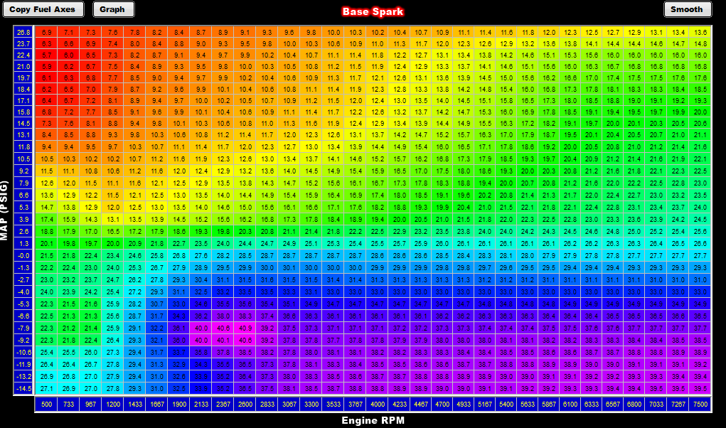

Here is my timing table. I run 91 octane spraying 2000cc of 100% methanol. I'm about 18ish degrees at 25 psi and according to the plugs I could continue adding timing

thank you for this. I’ll be taking some notes, it looks like I’m headed in the right direction then.

Man some of you guys are running some pretty aggressive timing...
If I were up at 10.9:1 compression I would certainly be starting lower than that and reading plugs to come up with my final timing.

You think I should knock about 5° out of everything in boost and start there?

Damn, small world! Yes I personally would knock 5 deg out by 12 psi on up for starters just because you have a relatively high compression setup. Just remember, E85 actually burns faster than gasoline. It may not show knock, but it very well could be on the wrong side of the curve so to speak. Dyno's for verifying more timing actually adds power and reading plugs are your friend.

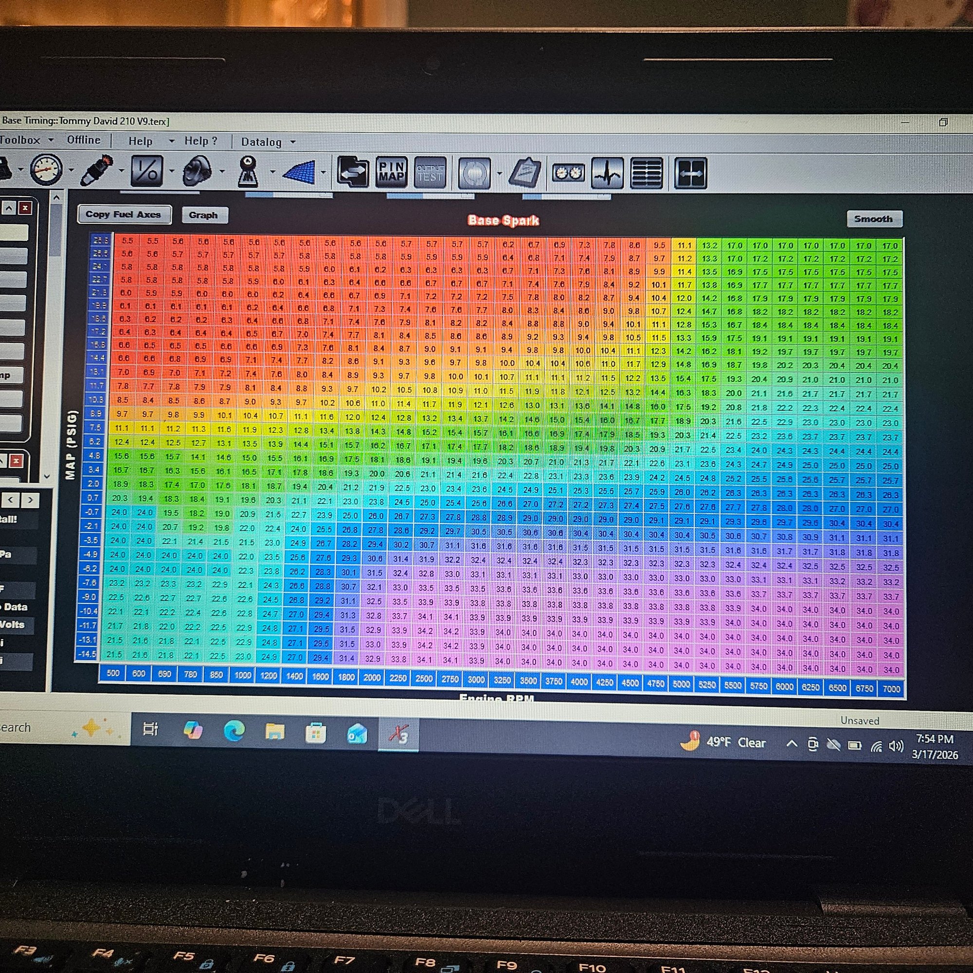

Damn man yall have me curious about my timing tables now, my tuner set them up for me so I really don't know to much about how they should look. When I get around my laptop ill post a picture of them just to see what yall think.

Piston(20 over) and rod lc9, 243 head port, polished and milled .040 on e85

That has a little less timing in the one I tuned based simply on numbers in the Holley, but IMO you definitely should be reading plugs. I'm not going to say your dancing with the devil, but I think I hear music in the distance 🤣

lol my tuner did all that when he tuned the truck, he built my shortblock as well. My heads were done by a placd called Calhoun motorsports. I had them on my stock block(lm7) and it at one time in its like snapped a rod in half and I had to mill. 040 to get the heads back right. He told me this is conservative.

Well, it's really all relative though right because every combo is different.
It might be conservative for your combo at a given boost level?
