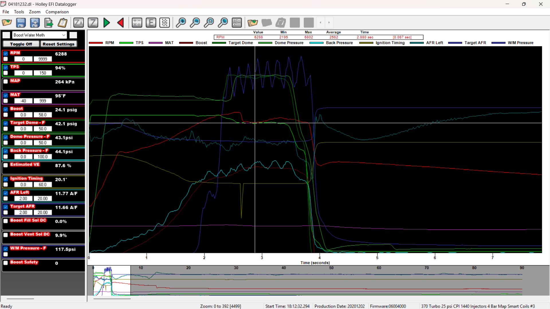

Hey guys help me out with this, I just started logging my meth pump pressure and curious to know why it seems so low? The system is an AEM with a progressive controller with a snow performance 300 psi pump controller is set to start at 8 psi and all in by 22 psi, I use dual M15 nozzles. I know it's probably stupid and there's something I'm just overlooking but why at full tilt is it only reaching 125 psi?? The car is running awesome and doesn't miss a beat but I would've thought I'd see a more linear line on pressure instead of whatever TF that is. Thanks for the insight guys and happy easter!!
That ziggy zaggy blue line is pump pressure. It just seems weird to me.

Thats normal. Two things going on here. 1st 2 15 nozzles you'll never hit that much psi and i don't see you logging voltage which is even more important. If you have 20v going to the pump motor i bet you'll be closer to 200psi. You probably at the low end of the voltage and that's why your seeing 120psi which is nothing wrong with that. As long it was tuned with that psi and it didnt just start to lose psi after the tune then you well run into lean condition. I run 2 20gph at 24v and im at 225psi. Yes i run the motor pass its max volts but it only run for a short burst that's why it lives. I have progressive also but turns on at 10psi max boost i run 32psi.

Okay perfect that's good to know. I've only just started logging pump pressure and was wondering why it was so low considering it's supposed to be a 300 psi pump

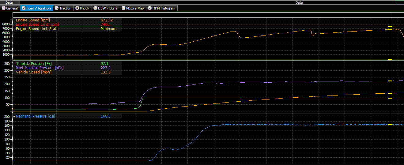

I just plotted this really quick so here is a screenshot of an Alkycontrol pump with a single M15 nozzle, with two M15 nozzles pressures are going to be a bit lower. Now I'm also controlling it with a Motec and this is when it's full blast and not at a lower PWM percentage.

Okay sweet that's pretty much what I was wanting to see. Thanks for that Nic
