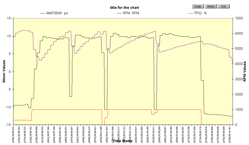

<strong>How about any M6 guys that own the Procharger? From a idling roll punching to WOT how does your boost curve look? Also include any other mods to the engine and drivetrain. If it builds low end torque really well, then I will lean to the Procharger instead of the turbo just because of the "bolt-on" feature.</strong></font><hr /></blockquote><font size="2" face="Verdana, Helvetica, sans-serif">In a 6-speed, nothing is gonna build boost like a turbo from an idle roll.
you can see my boost come up on the launch in this scan file
http://www.harlan-engineering.com/harlan/lag.gif
and you can have the fat torque curves in my sig <img border="0" title="" alt="[Big Grin]" src="gr_grin.gif" />
