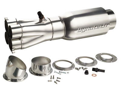

I checked their site didn't see anything on individual mufflers. Been looking through the summit site and going through like 900 items.
Seeing lots of ricer stuff 2.5" into 4"
I did find this so far tho
It looks kinda cool not sure what the clearance would be like tho. It would be a bad deal to cut up a set of kooks to make them work.
