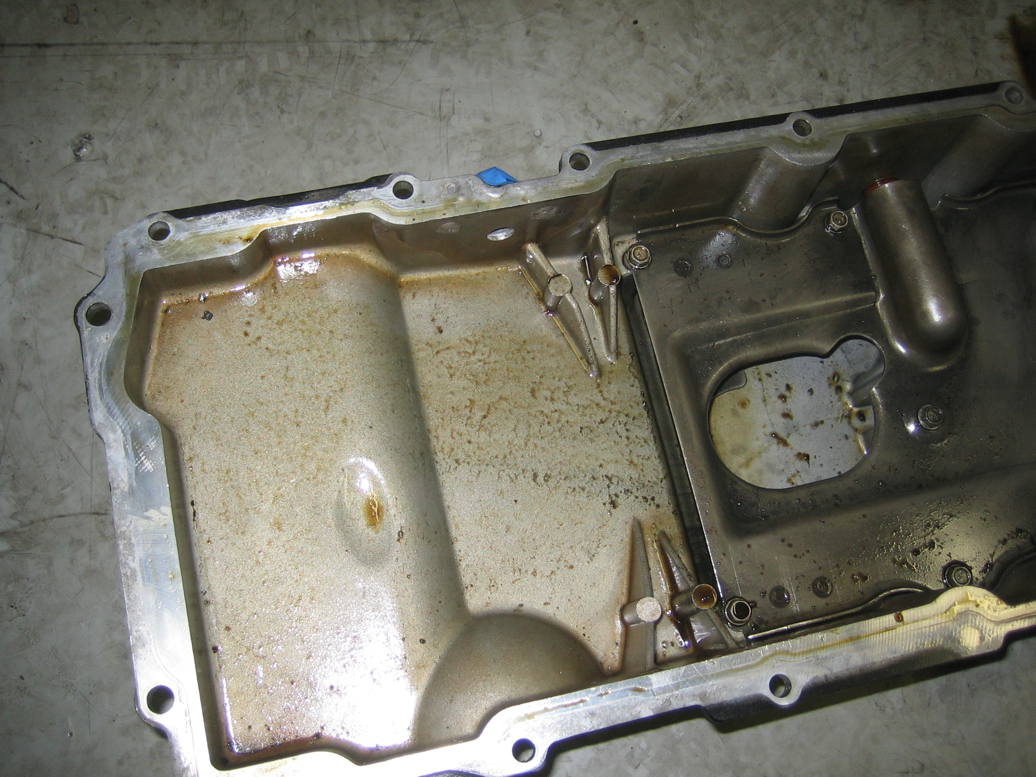

so what happened to the motor?

Maybe nothing, I'm not sure yet, I'm gonna have it looked at by a builder down in the area where my car has been 'living'....
I got what I thought (and what probably is) a newly built long block that was setup for a turbo. It was complete from cover to cover and had a return fitting already tapped into the pan. After some looking CAM decided to use my old oil pan since the return was in the front, and fit my existing setup. They took the oil pan off and found this:
http://www.carolinaautomasters.com/I...s/112_1249.JPG

Now, I'm told that cover was just thrown onto this new shortblock, but I was also told that the motor was good 2 go as it sat... so I'm gonna have a builder pull some more main caps and check things out.
