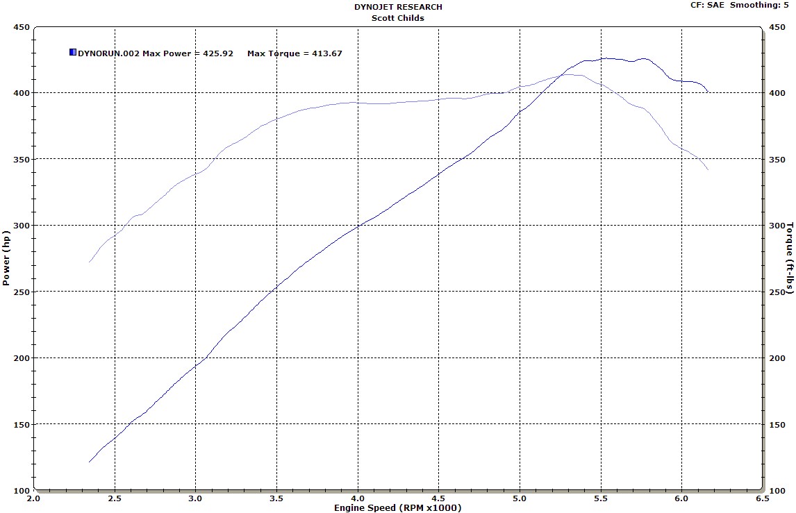

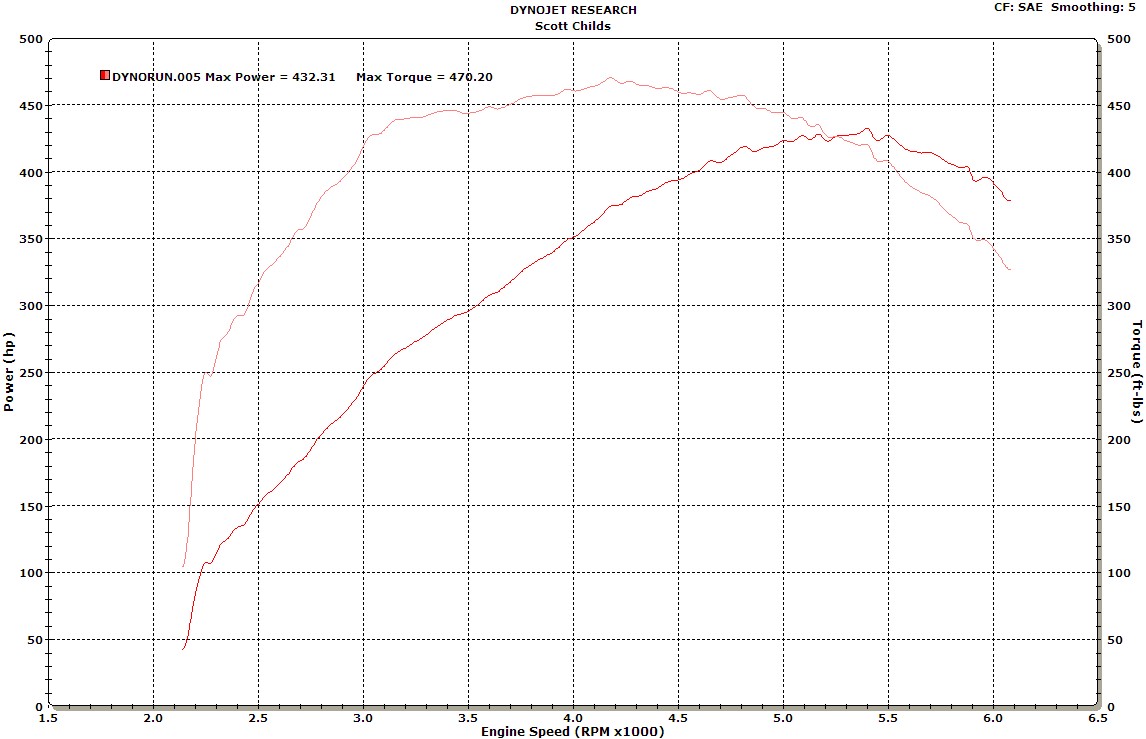

First pull. LOL
Final pull:

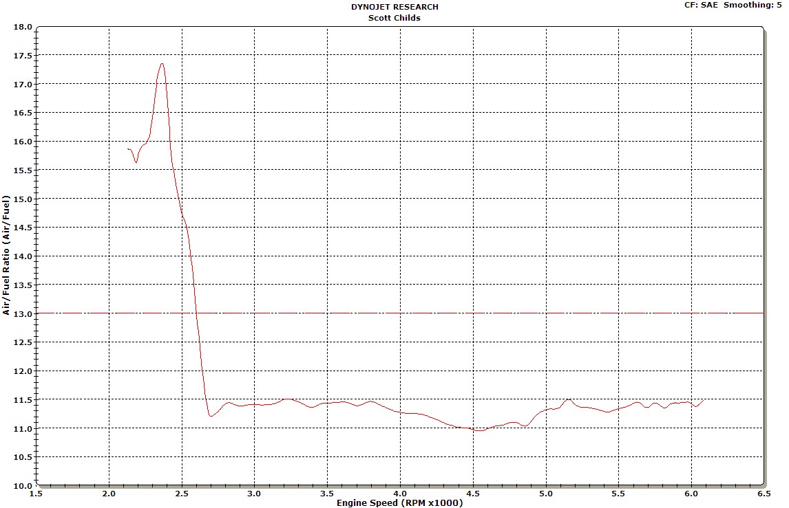

AF:

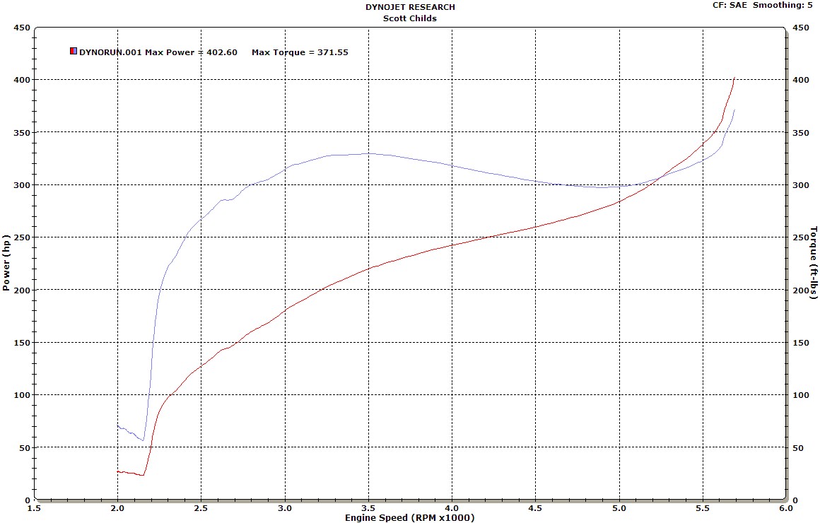

The 2nd pull before we started with any tuning:
So Clint was able to milk out another 7 horses, and over 60 RWTQ. Thanks Clint! I could definitely feel a difference in the ride home.

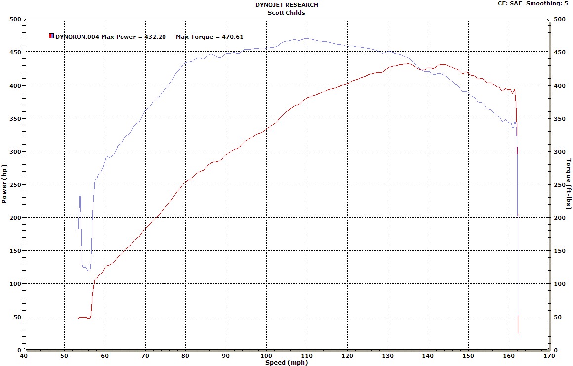

Definitely a problem with the dyno. You can see the same dip on this chart at 135-145 that we saw on Young and Shawns cars:
