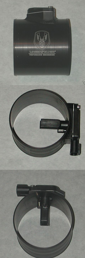

they wouldn't need to do that, as if you put the OEM electronics into a larger housing, it will work fine. You have to scale the tables accordingly, and calculations pretty much make it a perfect scale (cross sectional area) of the 85mm vs 100mm. It doesn't look like the OEM LSX internals, but I'd bet it is out of a similar GM product.
One of the Ford MAF manufactureres told me the electronics of the Ford isn't compatible with the GM ECM.

I understand you would have to tune for it i am just looking for a little more room to still use a maf. would like to run 10 lbs but i am right about at the limit of my maf right now. funny how similar it is to a cobra maf if it isnt i know they are either 4 wire or 6 wire with IAT sensor.
Ford uses a 0-5 volt output voltage, instead of a HZ value. One could build a converter box, and then use a Ford maf on a GM car,
I have tested a Ford Lightning maf on my 98 TA, with a converter box, and it did work. I never put it on the dyno to try to tune though.
2003-4 cobras, and 2001-2004 Lightnings do not have an integrated IAT sensor, however, the smaller meters with that plug style do, (GT, 2001 cobra) as does the SCT BA2400/2800 meters.
That meter does look ford ish, but I would guess it is off a high airflow vehicle (duramax maybe? )

Just got mine in the mail today. Waiting on the new couplers from TRT to install it. It does look like the MAF sensor on my dads new duramax but I think for the housing and sensor 300 isnt to bad. Plus the plug and play harness is great for 20. Now lets see if I can make 650 on 10lbs. I also have some 60lb injectors on the way.

It still maxes out at the same frequecy it is just bigger so when the same air is going through a bigger housing i moves across the sensor slower so it reads at a lower frequecy. A tech at Ling. told me they have a shop car that is making 750whp with this meter and it is not pegged. Also I like it becouse it flows more without the screen and center piece than the stock sensor.

The housing is 4". I have a 4" 90 silicon elbow coming off my TB then the MAF and then a silicon reducer from 4" to 3"

12 oclock has the electrical fitting going front-to-rear, the 3 o clock has it coming out of the side. Use whichever matches your wiring best.
