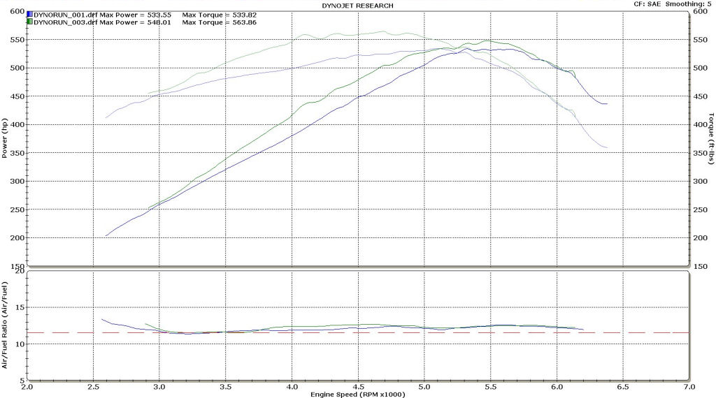

I don't think its my heads. Maybe it is the cam or stroke
Green line is current. Red was my old 5.7L with a TR224 and the P1. Same heads
arent you on a 383 now... not a 347?
i believe kp said that a 4'' stroke will make it peak earlier with the same cam... wich makes since... i had a 236TR cam in my 346 and it peaked at about 6300 rpms... a guy from comp suggested a smaller cam and now i peak at about 5800 rpms.... i also gain 1 pound in boost from 5800 rpms to 6300 rpms but drop about 55rwhp... that makes me think its a combo of my crap stock heads and a small cam in a big motor (224/236 .601/602 114lsa)
whatever i decide to do next will be done through a knowledgable sponsor like dezracing since they do a sh*t load of procharger RACE cars... or brent@EPP...
i just have a feeling it will end up being a cam like 242/254....
Yes a 383. I guess the cam could be part of the issue. Its a real small cam. Guess I should have went a bit larger since I have more ci. But wanted to make sure I would pass smog if I had to.
But the thing I don't understand is going from the P1 to the D1 didn't make more boost. I still made 10#

There are plenty of 4" stroke cars making peaks way higher, my solid roller 414 peaked at 7000rpm. I really dont know what to tell you guys since I have never had the same problem, if it is really a problem. I would run the car and see where its at and not get too hung up on the dyno numbers.
Is it possible the plenum was leaking some during the pull and then really blew out when you let off it?
Old Jun 3, 2007 | 10:42 AM
  #47
Ed Blown Vert's Avatar
Posts: 3,066
From: Sunny San Diego
I am going to have to say the cam is the issue. I am not too concern with peak numbers. Just where it peaks is odd.
And peak boost is the same. I really thought going from a P1 to a D1 would have given at least 2 more pounds of boost.
On the first run yes (blue line). It shows in the dyno. But the 3rd one it held (green line).

I hit a little over 16psi with a D1, 3.4" pulley, on a 402. My uneducated opinion would be you either have a boost leak, or belt slip.
Old Jun 3, 2007 | 03:02 PM
  #49
Jake@EPP's Avatar
FormerVendor
Joined: Mar 2006
Posts: 1,540
From: Hell AFB
My guess is the belt is slipping pretty good. A 3.20 pulley is damn small for a D1SC. You could try a new belt that is shorter and tension it really well, BUT traction is traction for these. We had this issue in the past and made a over drive crank pulley 1" bigger, unfortunately the machine shop we use went under and all the ones we have been quoted by want large quantity orders.
Old Jun 3, 2007 | 05:41 PM
  #50
Posts: 3,066
You guys are probably right. Went looking for my other pulleys. Found the 3.4 and 3.2 which means I have the 3.0 on the blower opps!

heh, if you were only seeing 10psi with a 3" pulley something is slipping or leaking. Like Jake said, a 3.2 is bad enough but a 3" is pretty rough. I never had any slip issues with the 3.4 though, I would try the 3.4 and see what happens

Yeah like I said earlier everyone around here is having belt issues with anything under a 3.4" pulley.

JEEZE! A 3.0" is crazy small, check the backside of the bracket and the alternator for a pile of dust.

Richard Racing makes a 3.3 BP and I had ASP make me a Custom 3.2 BP for my application. I have yet to get the car together but I think as long as there is enough Tension on the belt, it shouldn't matter to much. A 3.2 BP doesn't seem that much smaller than a 3.4 but a 3.0 is getting pretty small.
Vortech uses small BP pulleys (Around 2.75) and many guys don't have problems with there setups
May have been asked b/c I just scanned through the pages but if your spinning the blower to the same RPM level (P1 and D1) you shouldn't see a lot of peak gain but more midrange IMO, but I could be wrong.

The cam Im running on my car now is a 234/246 112 LSA and I think i need to go with a larger cam because Peak TQ happens at 4K RPM and I think HP won`t hold much after 5500RPM. IMO 4" strokes needs a larger duration on the intake side to skew peak TQ and HP towards the top end. I think my next cam choice would be something in the 242/252 113LSA range.
The FM7 i was running is a 224/230 114LSA cam and I was running that on a 346cid. I think the cam is your problem and you definatly need a 236/244 114LSA cam or something around that size for a 383.

I will go ahead and take out the 3.0 and try the 3.2

Change the pulley first, then the intercooler then the cam
