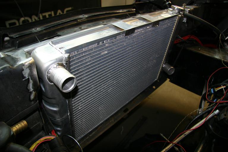

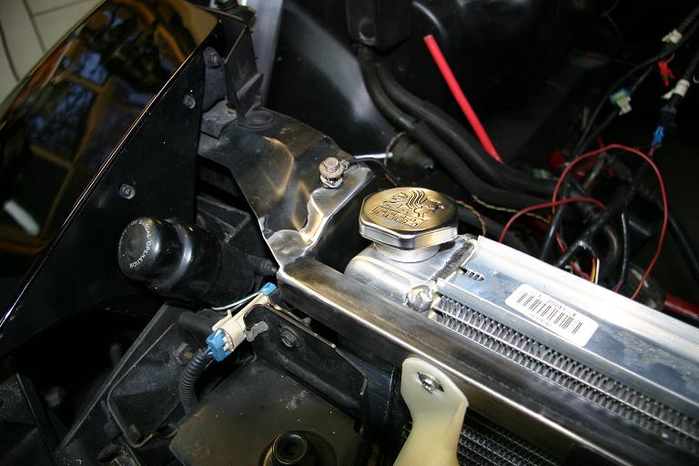

a lot of Fbody turbo guys tho gut there factroy rad support out and stand the rads straight up to give them more room, I did it to mine just to give me room to work on the front end and help with installing my engine from the top.

I have done the above with several cars.

the bottom of mine sits about an inch in further than stock its not that much, I wasnt worried about the bottom there was room there for me to work it was just all at the top where you need it.
